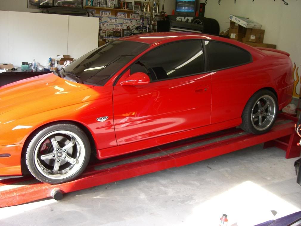

buddies GTO
hes putting spray and an under drive crank pulley on.
