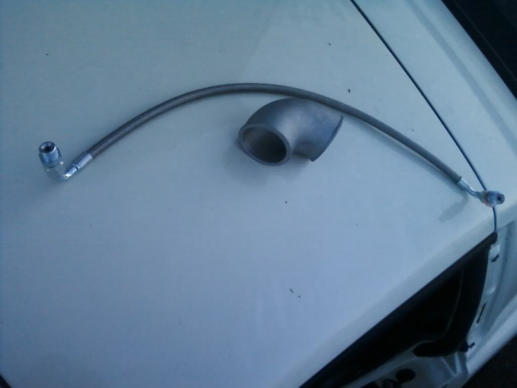

^ im welding a 90 onto the turbo/compressor housing which i received today with some more stuff from aaron at DM who is the man! a m12 1.25 tap and my power steering line :) also did alittle to more to the car mostly cleaned it out of all the shit inside..it was like a storage lot on 4 wheels -_-..i did setup the coil pack and my ghetto regulator..but heres a pic..
