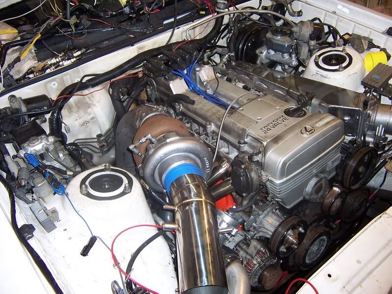

here it is running
only major problem is i can't rev past 3k rpms, just hesitates off idle, and i'm about to purchase a manifold.
this is the first start, vpc is set really rich by default and the spark plugs are shot. it does not smoke near as much now.
will make a video of it rev/hesitating once parents are awake, open 4" downpipe FTW

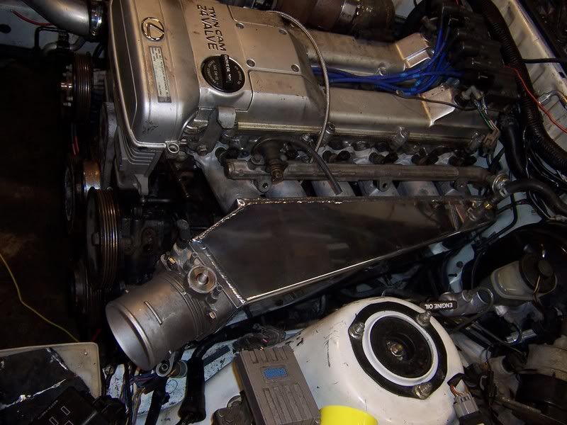

finally got a manifold put on, got it today ;) its sethrons square type, major props to him for making it :bigthumb:
going back out side to finish wiring
edit: moved stuff from the thread i previously posted in; i should just make a build thread one of these days lol
