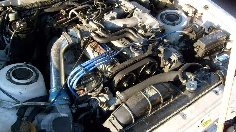

well, today driving around... what do i hear......ROD KNOCK...it couldn't be... oh but wait, i'm driving around with a 7M! no wonder.
So, it's time again for another 2jz swap. this time i know what to get and what to do. so it should be a little cheaper and go a lot smoother.
This time i'm going to be keeping it twin turbo. I'm going to be doing things a little different.

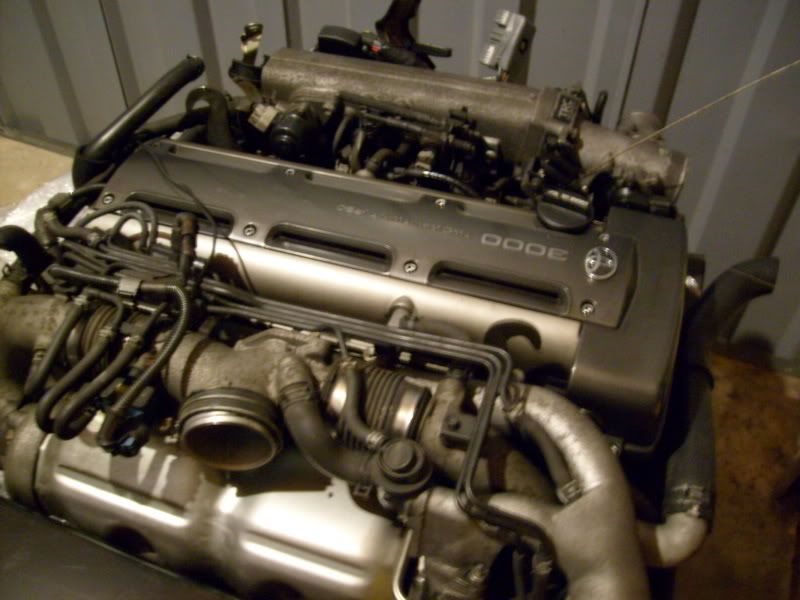

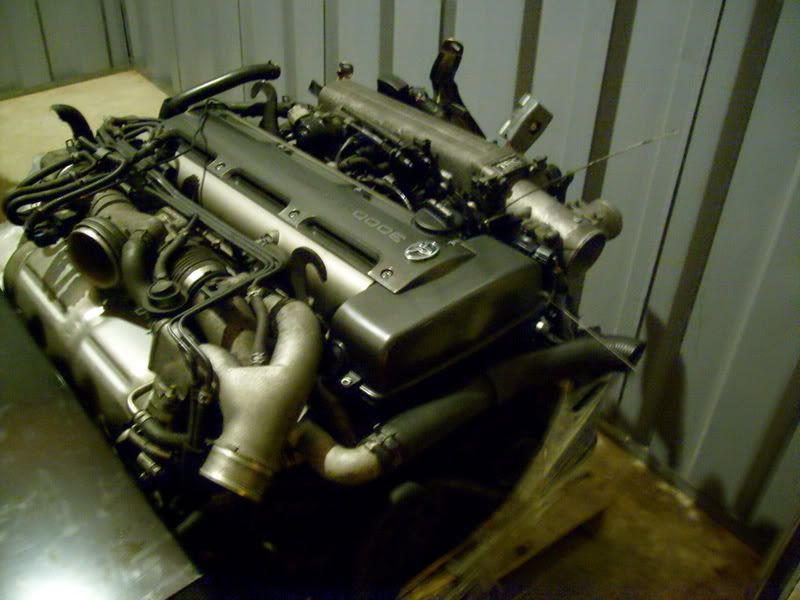

hey, i didn't get an igniter with the motor, but i emaild the guy asking hi to ship me one, it said everything in the pic is what you get, the igniter was in the pic, but i don't have it.
so toyota wants $425 for a new one, is there a way i can use the 7M one?? i have a turbo and NA igniter, which i think are the same.
ok, so i'm tryin to figure out how to make the 7M igniter work with the 2jz ecu. i think it could be done, a few signals from the 7M won't be used, that's what it looks like. i have 2 igniters, so i think i'm gonna need both of them to do this.

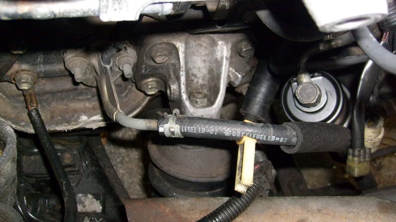

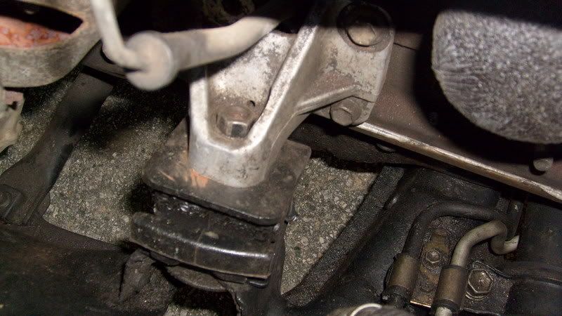

i decided to take a look at what engine mounts i have, so i can order the right mounts from BIC
i am a little cunfused. i have an 89... just so you know. one is round, the other is square, so what do i do?
driver side
passenger side
