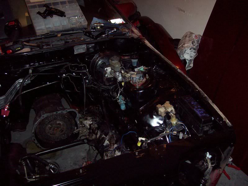

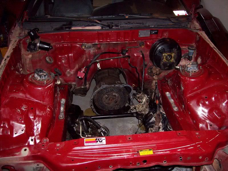

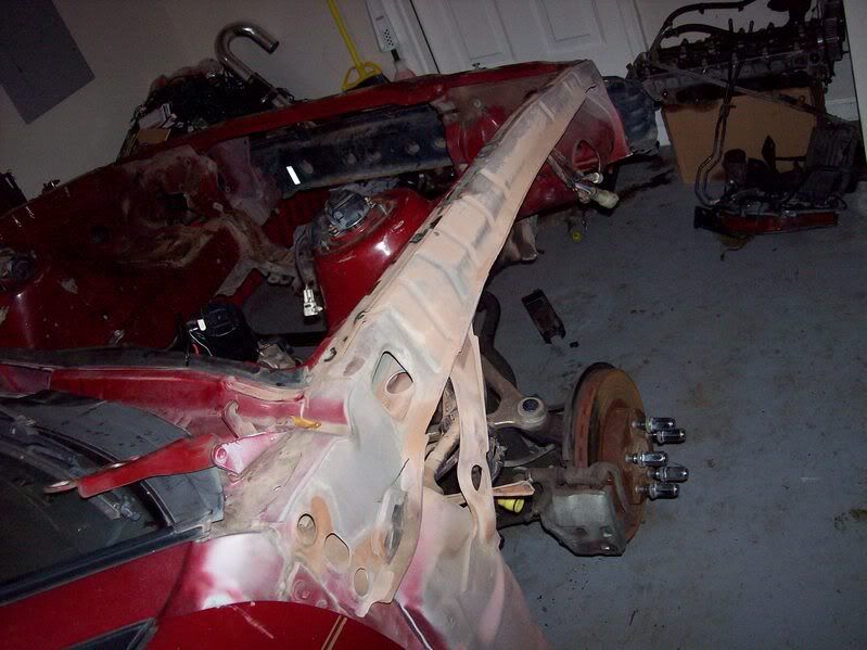

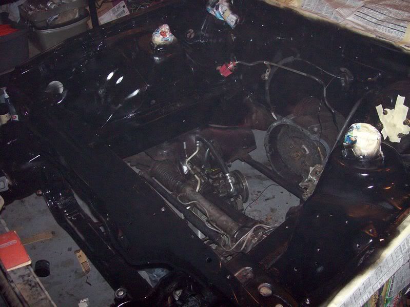

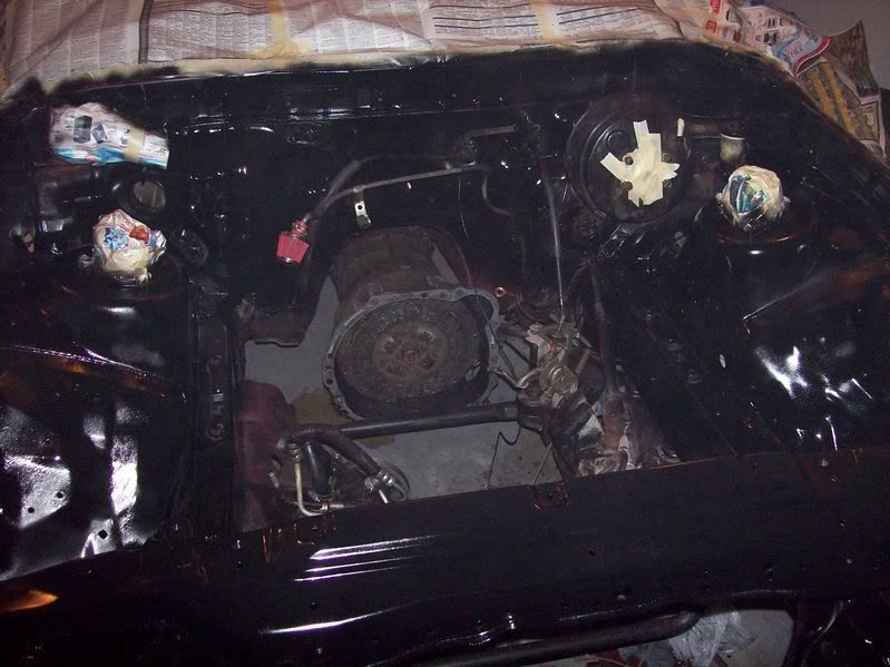

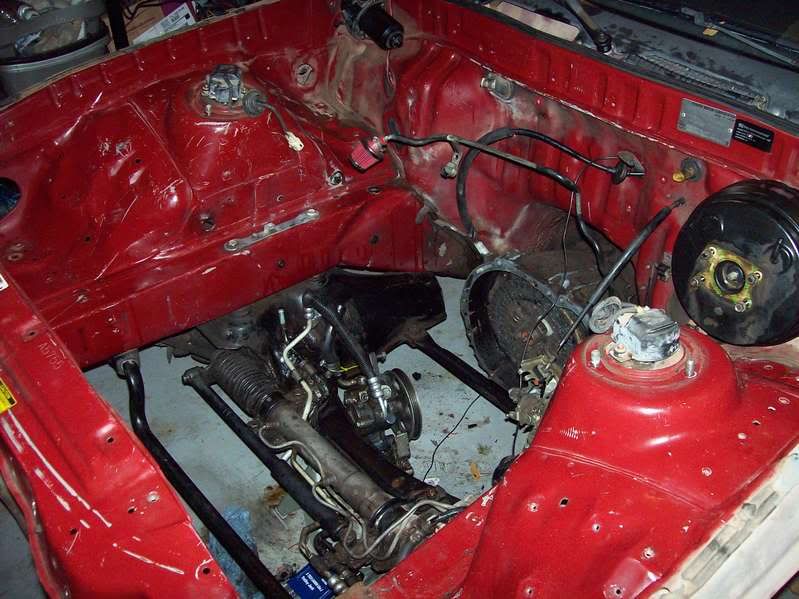

well, i had a slight change of plans in my other build 'Rita's Big Build'
I've decided to swap in a stock twin turbo 2JZ. I love the MKIII look but i want the MKIV power. so today i painted my engine bay black cause someday i'm gonna paint the car black. so i should have the engine by may or june at the latest. and then i need to look for a 89+ cross member. but i don't know why i can't just remove the 7M engine mounts and weld in 2JZ mounts. i'm still in the process of researching all i need to do but for now i need to get my hands on a 2JZ... i'm also just gonna keep the 2JZ stock for now. i figure 320 hp is good enough for now. that's 120 more than i currently have
i'm gonna replace the head gasket, ARP studs, and other things i can replace that's cheap...
