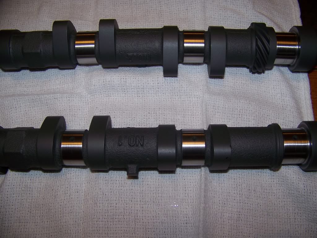

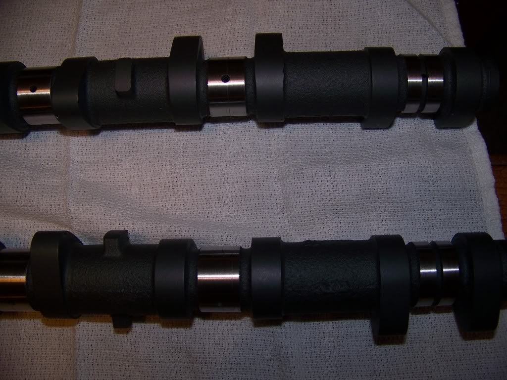

UPDATES!!!! OK, So the new 1.8MM Cometic MHG is on!! Also got some polly motor mounts and I'm still waiting on the 268 hard welded cams from webcams.com. I'll get some pics of the cams up as soon as I get them.

Yes!!! I got the cams in a couple days ago!! WOHOOO!! So i need to order shims and then it's all back together. And I have to order 20 new shims...:( that's about $140 just in shims. I'm taking a vacation and then it'll hopefully be back together in 2 weeks and running again!!

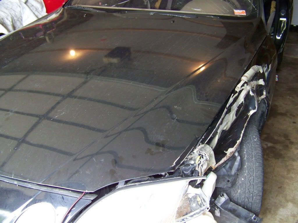

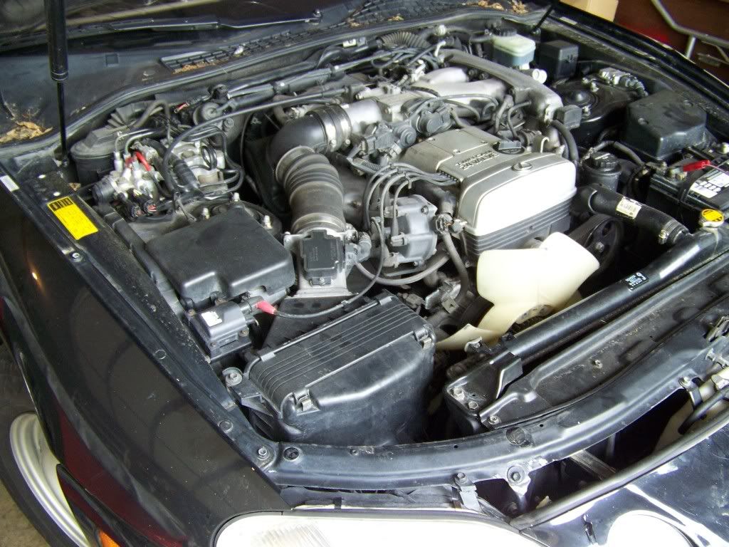

Oh, and while this was all happening, I picked up a wrecked 1992 sc300 with 183K on the clock. The engine and everything ran perfect. I bought it to part out and keep the shortblock as a spare or sell later if I don't need it. The best part is it was only $400 for the whole car. And also the guy trailer ed it to my house for free!!!!! This is the best craiglist deal I've ever experienced. Not only have I made all of my money back, but I have a "free" block and head ready as a spare. Can you tell I'm excited about this?? :)

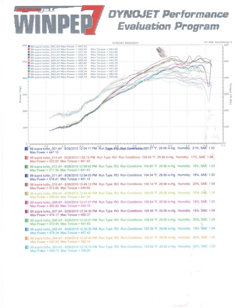

OK, so dyno went pretty good. Put 533rwhp and 460 torque at 22psi. Its running great! I did run into a couple snags and I want some guys to give me their input. But I may be having some clutch issues or it could be tuning. Anyway I'm very pleased and will have videos up later.

OMG just got done reading this and man i am glad that so many people are doing it. 150 psi is stock comp ratio in a 2jzgte which with the gasket you now have. 533whp is effing fantastic. but i am jealus of your engine bay.
