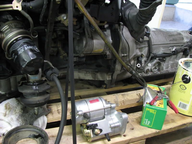

The Reaper said:yea i think they might mork but i think it makes the motor sit too far back or forward or too high or something. i remember a thread or a post about them. just try it out unless you get a definite answer first
Turbo 7M said:^What Tissmo said, i have the aristo brackets and the bic jza70 brackets in my garage and the engine mount brackets are way different.
becauseican said:The Aristo brackets are quite different and wont work. They place the engine in the wrong place and they also stick out too far from the block. The rubber mount itself will work but not the brackets. BIC makes the pre 89 swap brackets and 89+ jza70 style brackets.
BTW you will also need a rear sump pan to fit in the mk3 too
