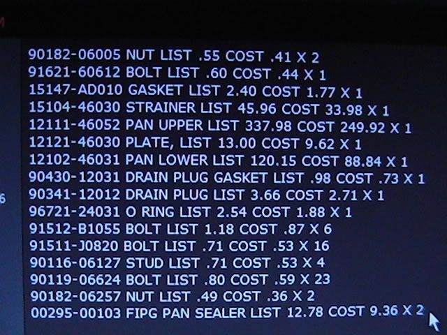

Oh really! Toyota has an oil pan for a Toyota motor? That's crazy! I thought I'd be able to pick one up at KIA. Just joking guys! :biglaugh: I should have been a bit more clear. I should have asked if anyone had a spair one laying around for sale or if there was anywhere that was selling an aftermarket one.
crazysupra2JZ
Nov 16, 2006
740
Georgia
here's everything you need. it's a 2jz-gte oil pan. i guess the oil pick up will work.
Shadow
87 1JZ-GTE Single Turbo
May 25, 2005
304
Windsor, Ct
So if I were to go to Toyota and pick up the lower oil pan from a 2JZ-GE from a Supra, then it will fit on my 1JZ-GTE and fit into my mkIII Supra? And it will be cheaper then the lower pan from a 2JZ-GTE?
