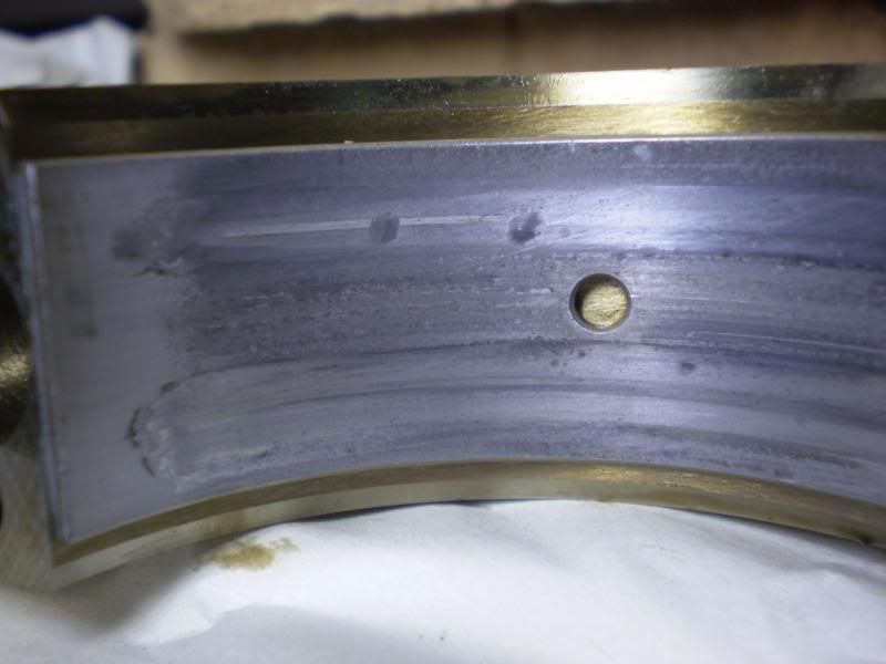

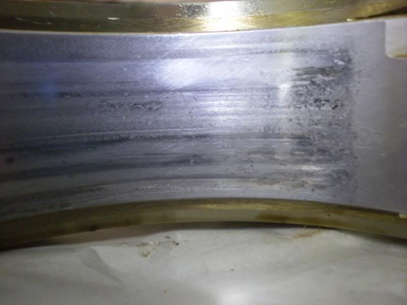

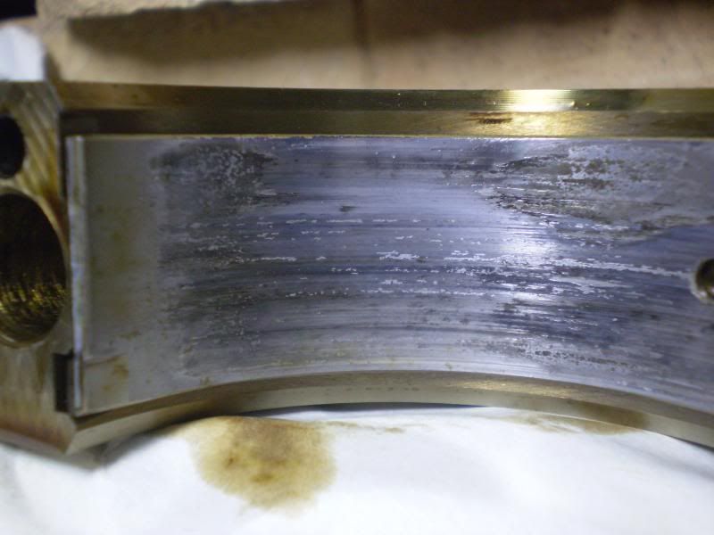

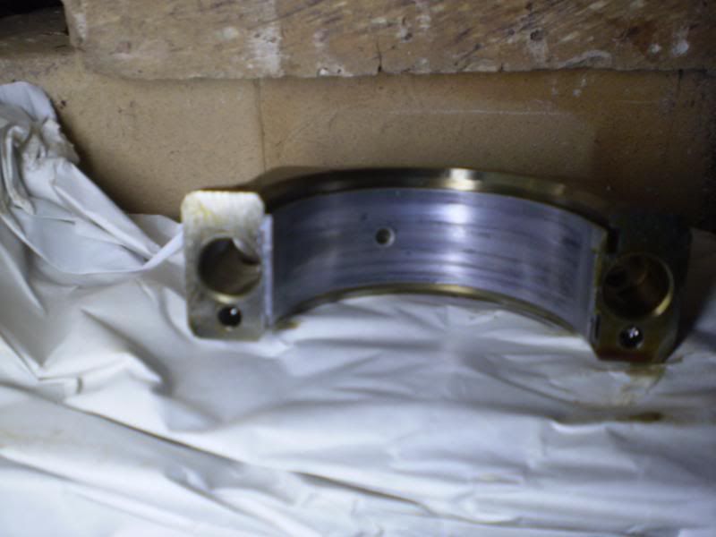

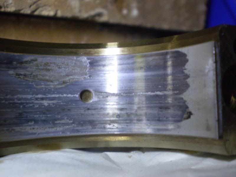

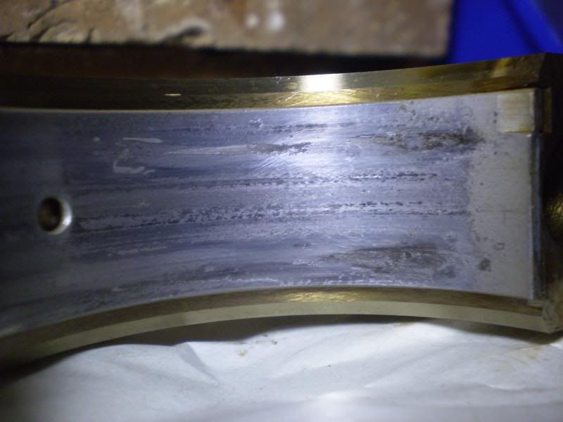

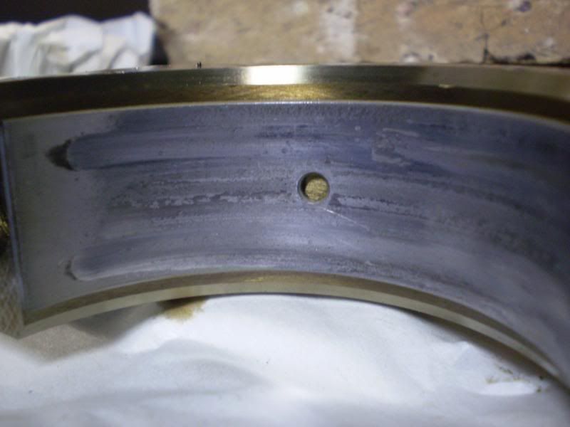

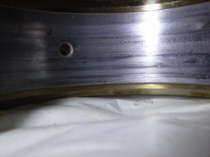

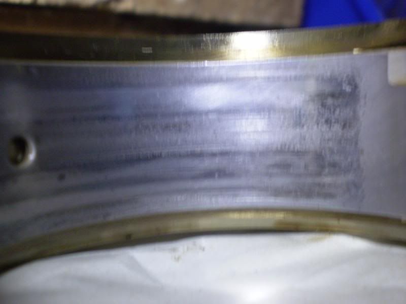

Okay some pictures just so show some damaged bearing action. Not spun but they do look like they might have been starved for oil at one point in time.
Here they are:
Only thing that kind of sucks, but not really lol, is I did a lot of work cleaning up the deck which I didn't need to do but oh well. No biggie.
And yes of course I have a picture:
Okay done for tonight. I'll let you guys know what the machine shop says. *Crossing Fingers*

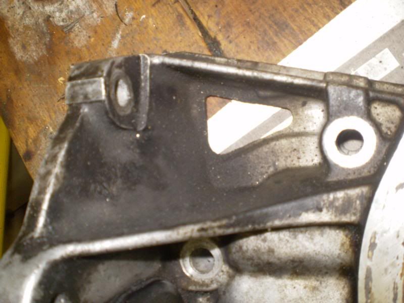

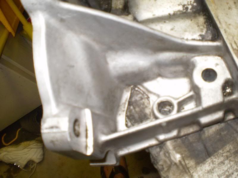

Grind the bracket to run A/C. Now which bracket do I need to grind? I was looking at the PS bracket picture you had on your thread DOK but I couldn't make out which bracket that was on my engine.

For the PS-I know your engine isn't there, but if you can kind of hold the PS pump on it's bracket above the A/C comp with the 7M outlet plate on it you can probably see where it needs to be ground. Basically just need space to get the lines/bolts in there. Seeing Bigzavs would help too as it took me a while to figure out what people were talking about :)

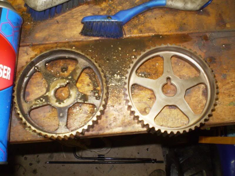

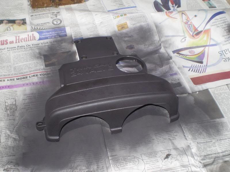

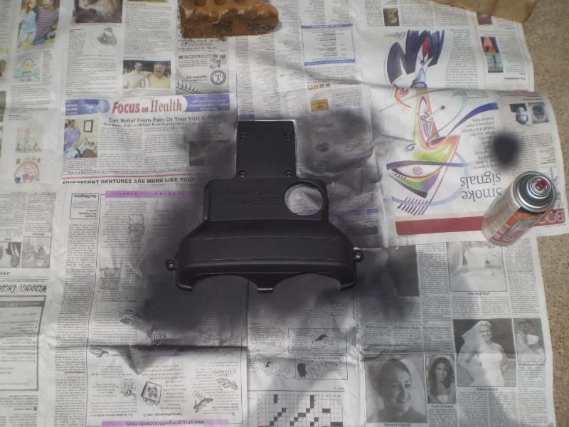

I haven't really been up to much aside from cleaning and painting. I actually cleaned the oil pan instead of just cleaning up parts of it. I'll get finished pictures up tomorrow hopefully.
So I cleaned:
Oil Pan
Cam Gears
Valve Covers
Lexus AFM
I painted: (Both flat black)

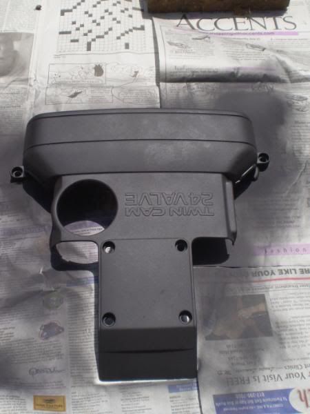

Upper timing cover
Cam Gears.
Since the timing cover has already been cut by the previous owner and I cant find another cover, I'm using this McDonalds style cover :) My logic behind painting the gears was "Well they're going to be showing whether I like it or not... Might as well make them "disappear..." Lol

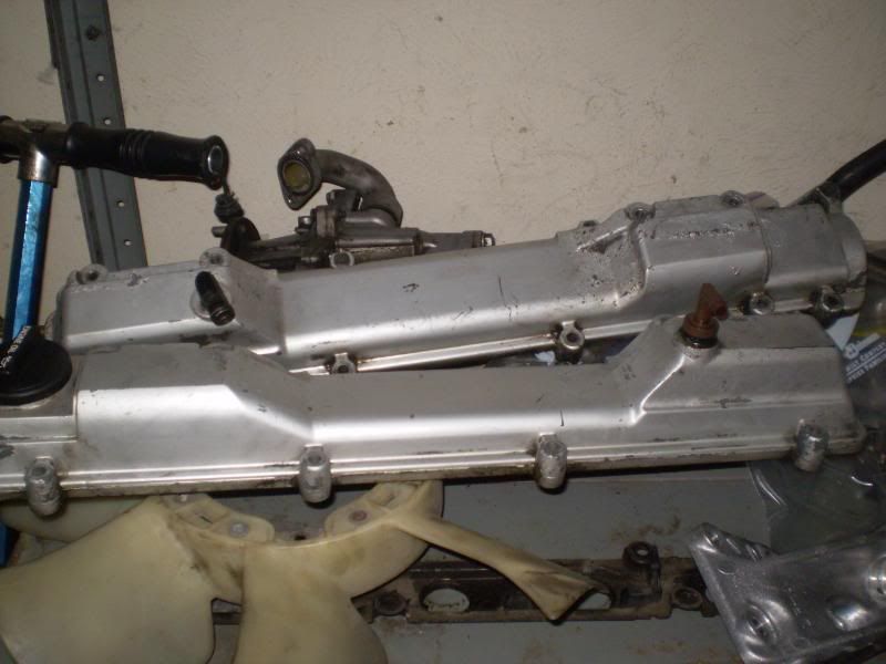

I need to paint the valve covers but they definitely need bead blasting first.
Pics:
Cleaning supplies and cam gears. Left untouched and right has been cleaned:
Closer:
Cleaned up valve covers. That's hardened dirt and grim. I CANNOT get it off with degreaser or scrubbing or both for that matter.
Upper timing cover:

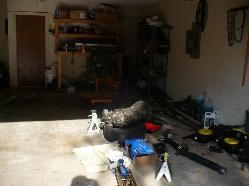

The shifter and DS are out. Trans fluid drained, coolant drained, oil drained, radiator taken out, fan taken off, slave cylinder unbolted.
When I took the DS out, the rear of it slipped out of the yoke and put a nice dent into the pavement... Lol. Good thing I was a ways away.
However it looks awfully cloudy outside and im not sure if I'll be able to pull it today... But I've got someone picking up the turbo and DDP tomorrow so thats got to be off for sure.

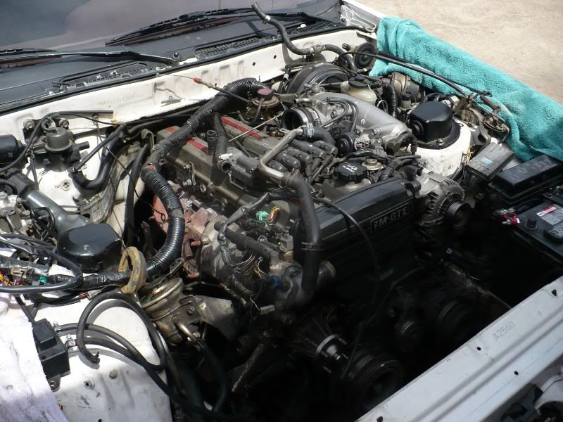

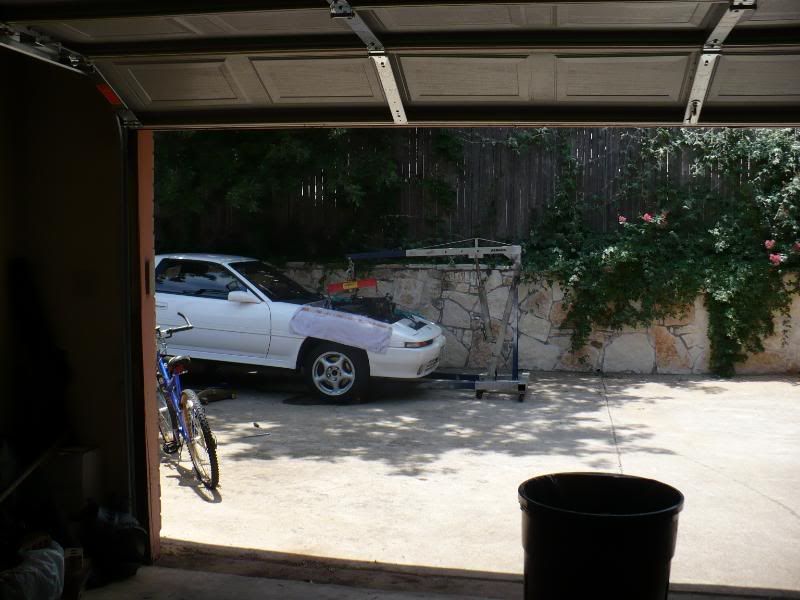

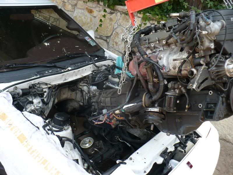

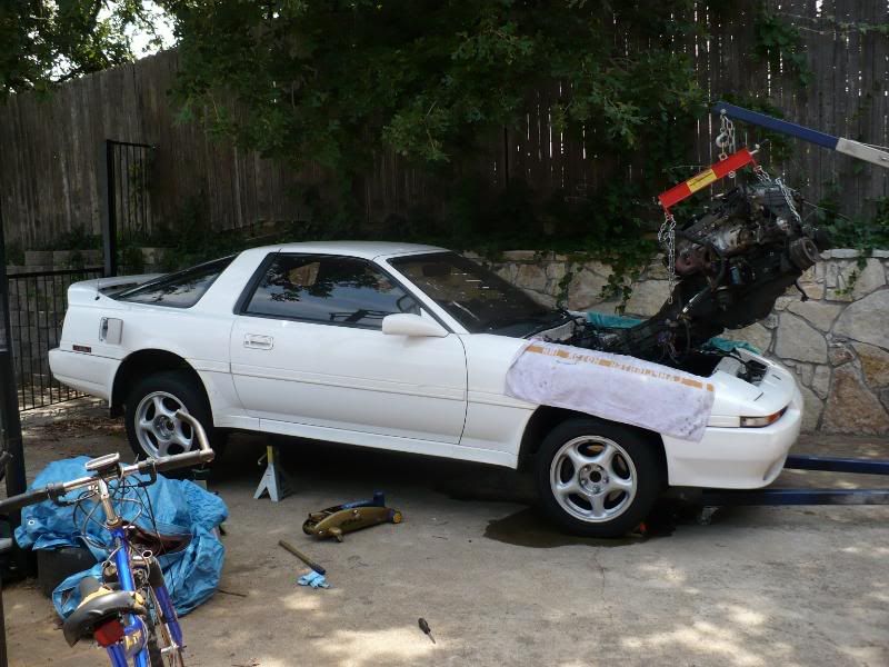

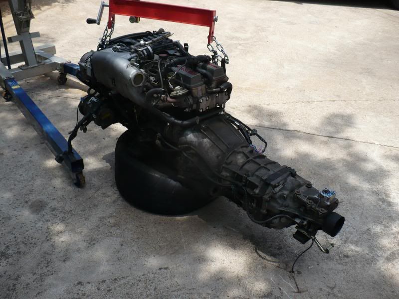

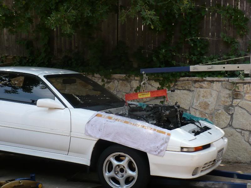

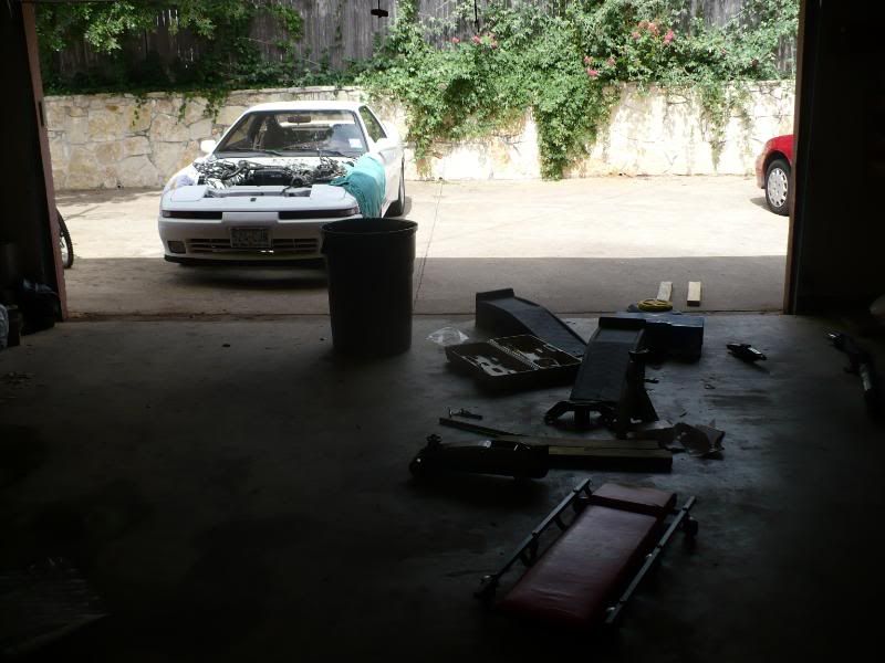

Okay. Today I was able to get around to pulling the 7M out but I didn't take any pictures.
Kidding...

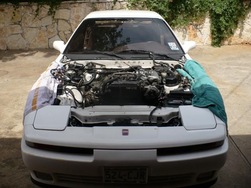

Ready to take out.
Rear end up on stands.
Insert hoist here:
So um... I needed another breaker bar... I didn't have one. But I did have...
7M on the stand

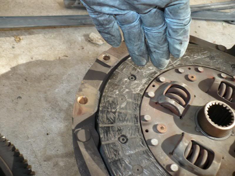

Worn out clutch anyone?
Sleeping.
My dumb ass broke an engine mount bolt haha. It was early, I was tired and... Nevermind, there is no excuse it was a dumb mistake lol.
Thanks for looking guys.
-Nick-

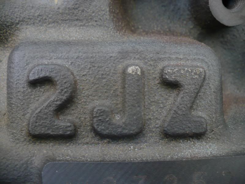

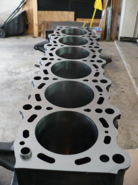

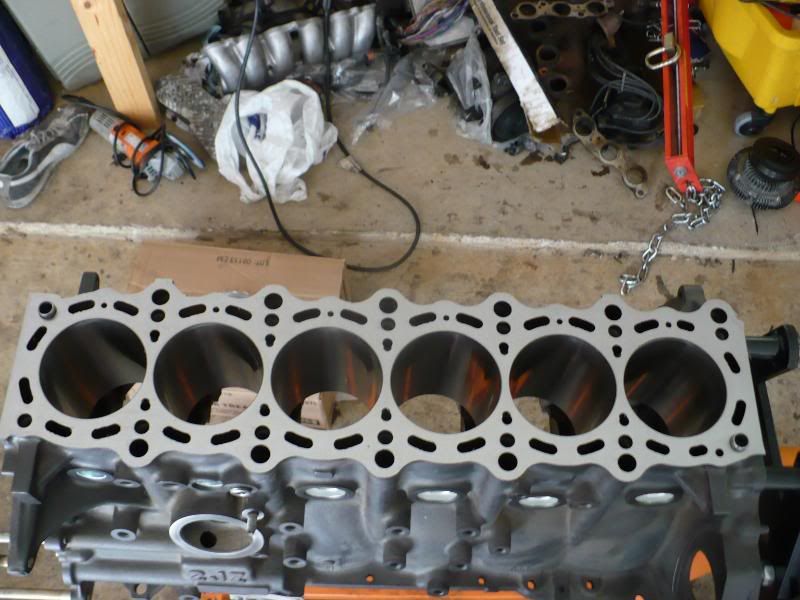

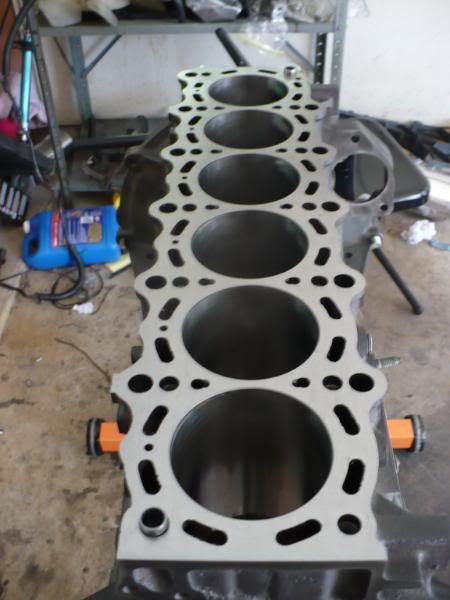

The block is back from the machine shop. Woot! Tomorrow is assembly time :D
Pictures pictures pictures...

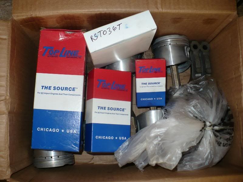

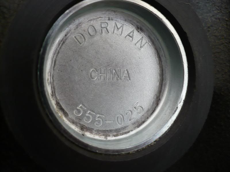

Freeze Plugs from China
Bearings and piston rings.
Thanks for tuning in.
-Nick-

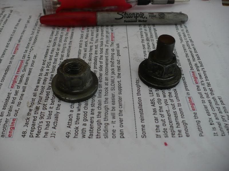

It was originally for a test fit however they are very snug. I had seen some people use them on Club NA-T and I've seen no issues yet. I originally bought these as the hardware store was the only place open and we couldn't find the correct size bolts so we found it in screws.
So I'm debating on keeping them but I might switch them out.
