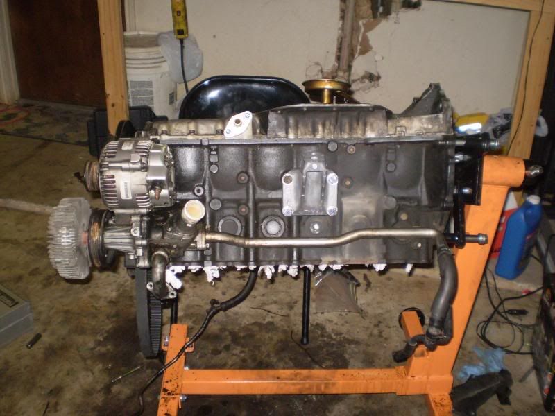

Well I've got all the foreseeable parts I'll need for this swap as you'll see in the pictures below. I just picked up this 2JZ-GE yesterday and today I was able to disassemble it a little bit more to see what kind of condition engine I was looking at. The idea with this build is to go with the 7M ECU and electronics going with the XS Power T-61 turbo kit.
Since I can't really think of anything else to say... Onto the pictures:

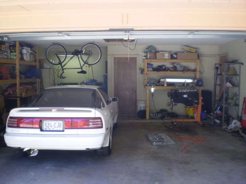

And now here's the work station with the 2JZ.
I wish people changed their oil more often...

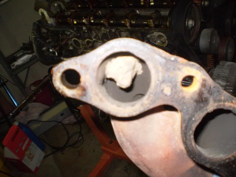

What the hell is that in the exhaust manifold runner?

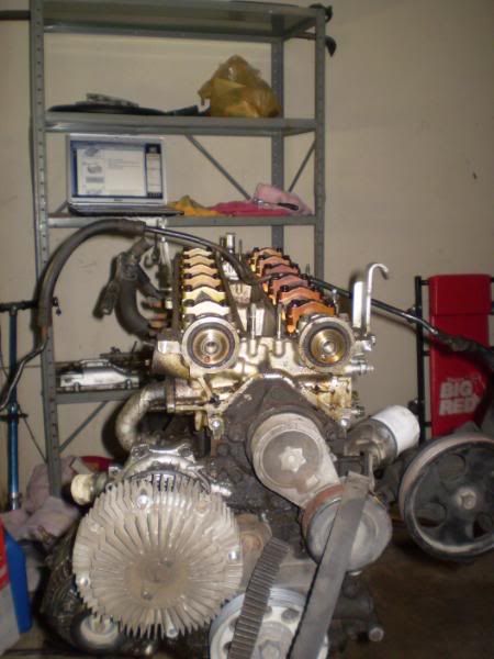

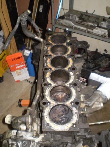

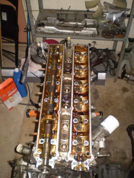

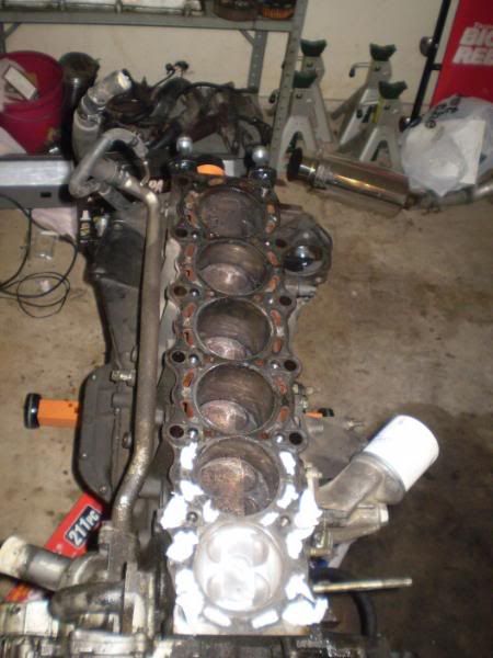

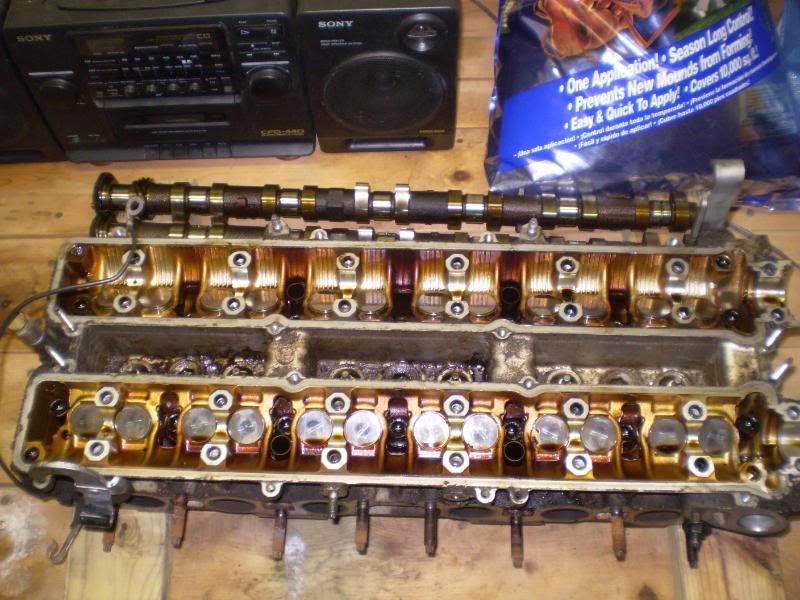

Okay today I removed the head and I had a few questions that I'll type above the picture in question.
Cam gears removed and intake camshaft taken out.

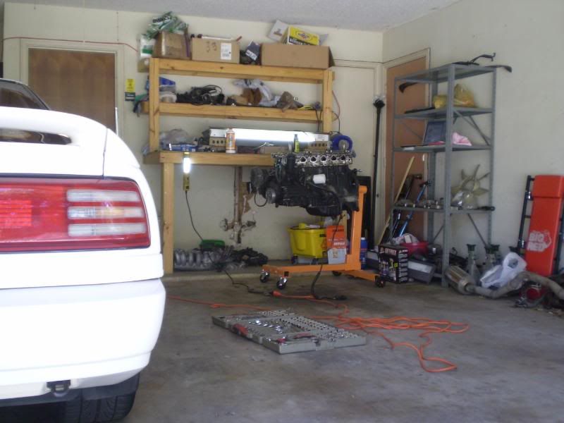

One more picture of the work station.
Here's the head.

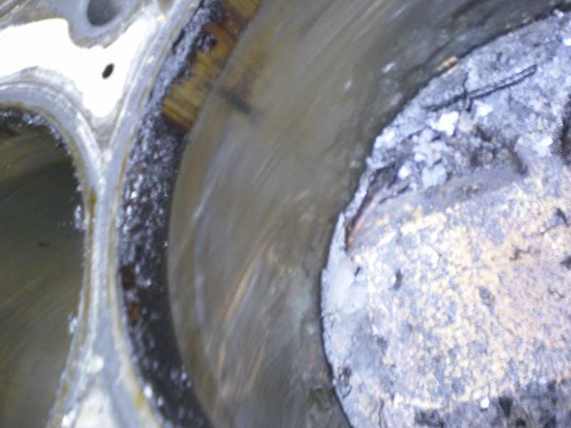

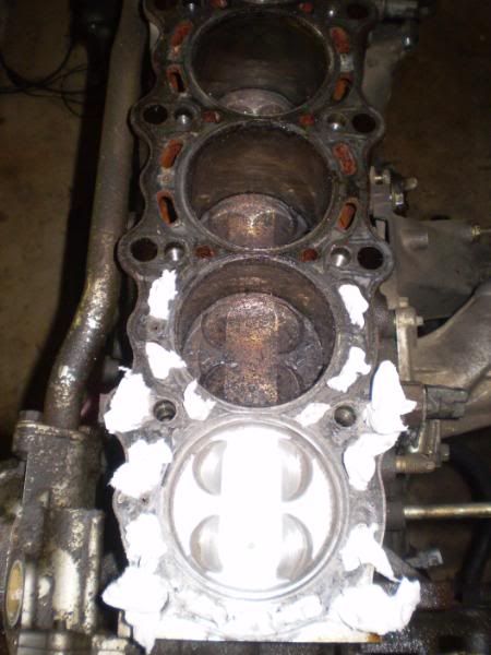

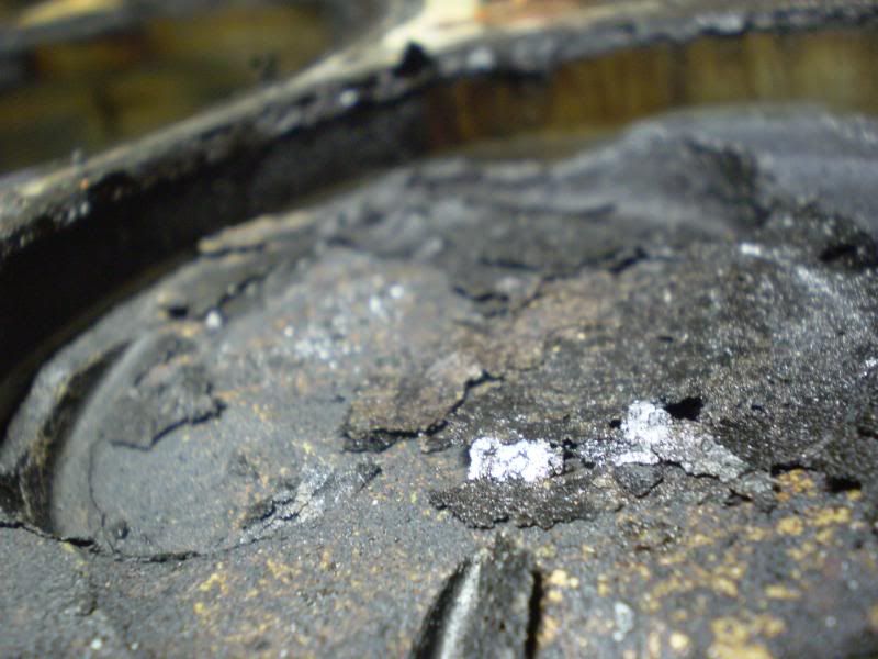

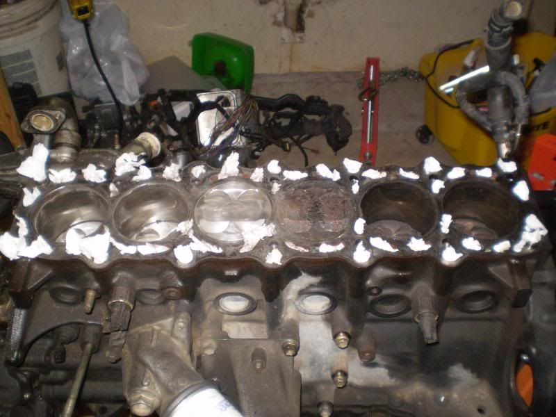

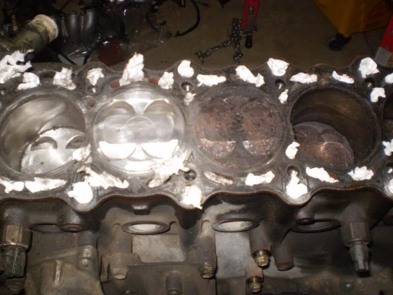

Now there is a shit ton of what I think is carbon build up on top of the pistons, how would I clean this?
This is just a slight indication of how dirty the spark plug valley is. This was after breaking loose one of the spark plugs...
Any thoughts about cleaning up the carbon build up?
Thanks!
-Nick-
hottscennessey
DONT BE A BITCH!
Jun 3, 2005
3,137
Richmond, VA
Hey Nick!
Nice to see you started a build thread. I'll be checking in here regularly.
removing carbon buildup. Degreaser/gasoline works, then use some break cleaner and brush to clean the stubborn stuff.

Fletch124 - I got it from a local guy who bought it to use in his 240SX but he changed his mind and went 2JZ-GTE.
Scott - So any kind of degreaser and a brush? Like a scotch bright pad or something?

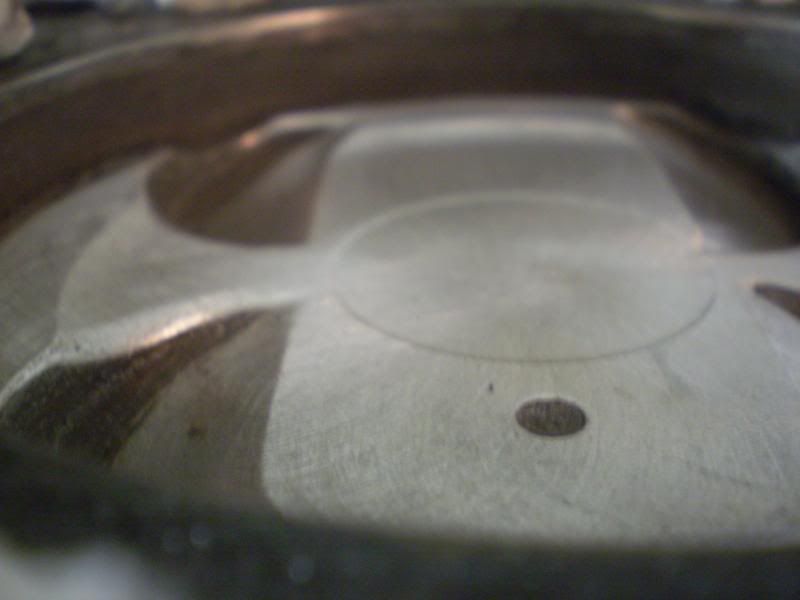

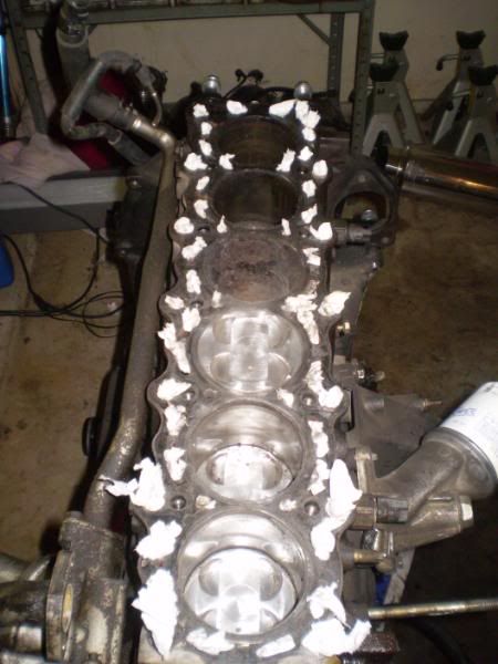

So I was cleaning up the pistons today with this awesome little scrubber bit for a drill. Just about to finish #5 and it breaks... Figures lol.
The first 1-4 looks great! I'll get pictures up soon.

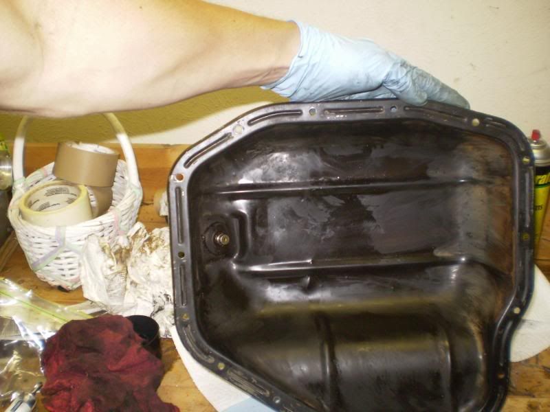

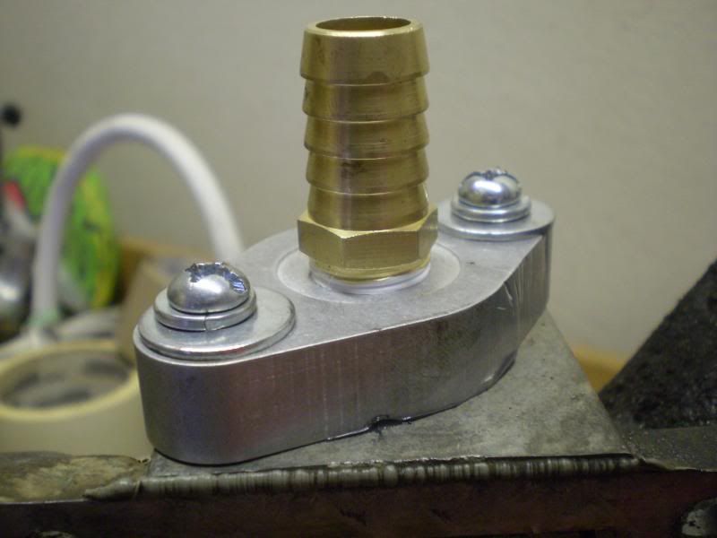

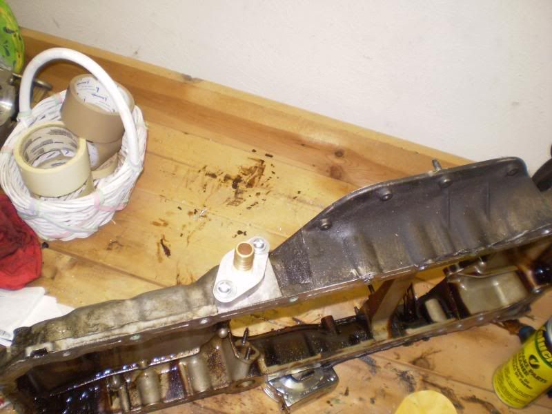

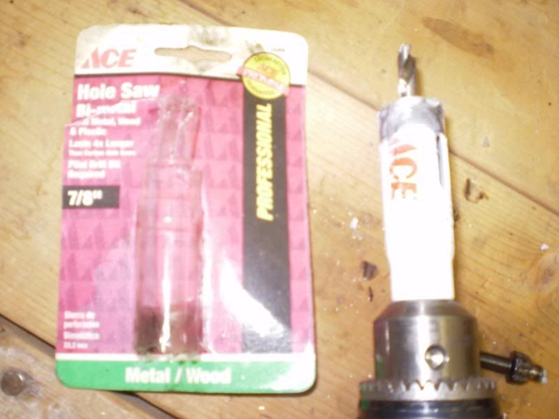

Okay so today was a productive day. I didn't finish all that I wanted to today but I'm still pretty satisfied.
Today:

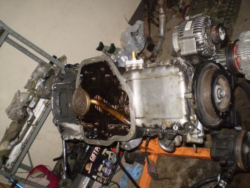

Oil train flange drilled, tapped and mounted.
Both pans cleaned like crazy (one had to have a dent beaten out) and RTVed.
New Motor Mounts mounted.
Union bolt purchased and installed. (Thanks for the help Ben)
New timing belt installed.
Replaced front and rear main seals.
New timing cover installed.
Onto the pictures:

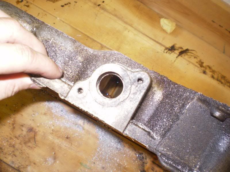

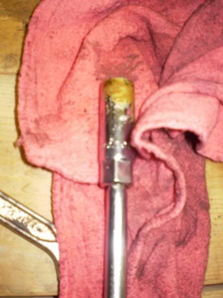

This is what I used to drill the hole and worked perfectly!
Here's the outcome:

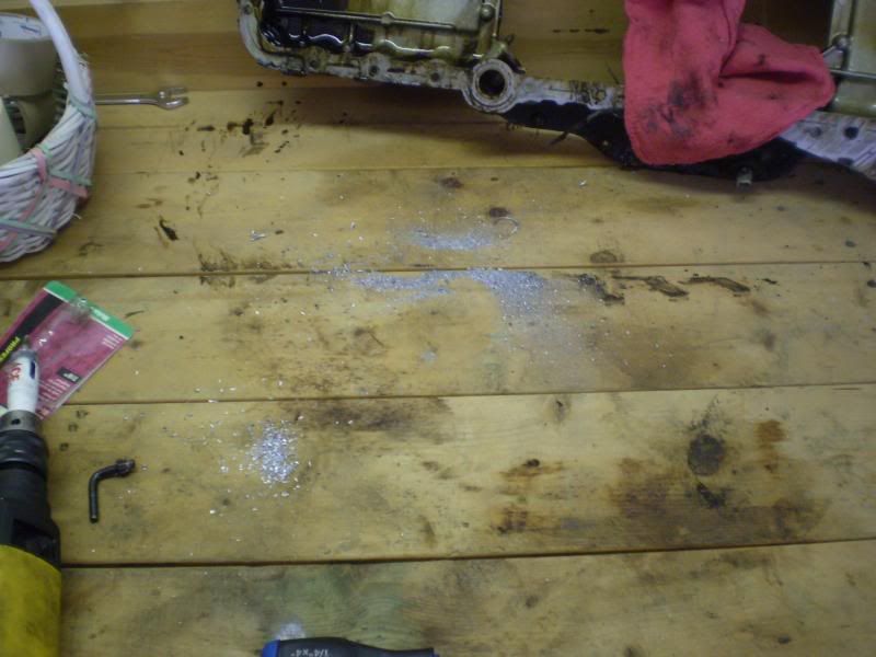

The shavings: (If anyone does this and you have the ability to drop your pan and do this out side of the car... DO IT! Thats a lot of stuff to fish out of a mounted pan)
Finished result:

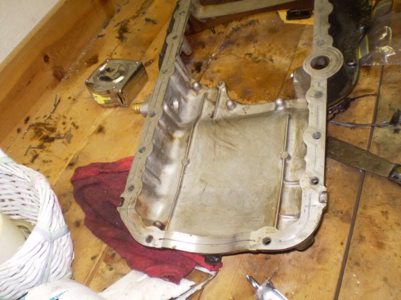

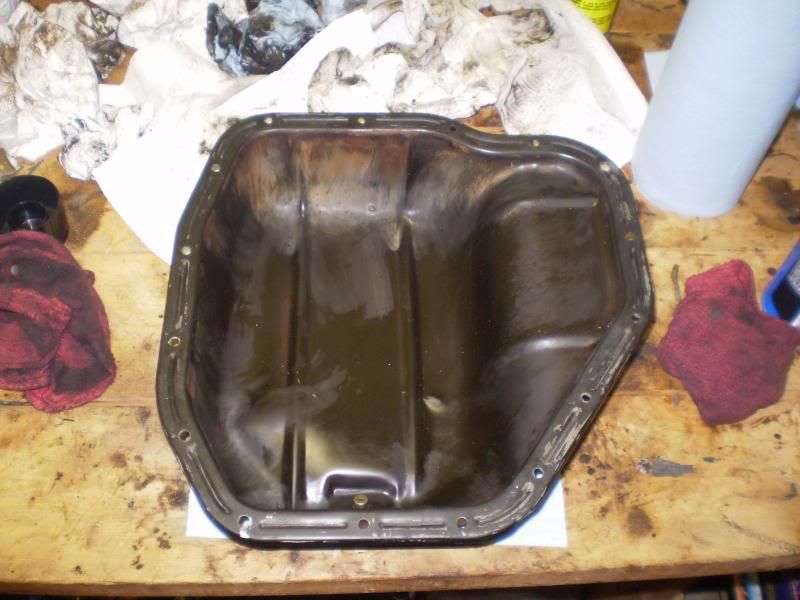

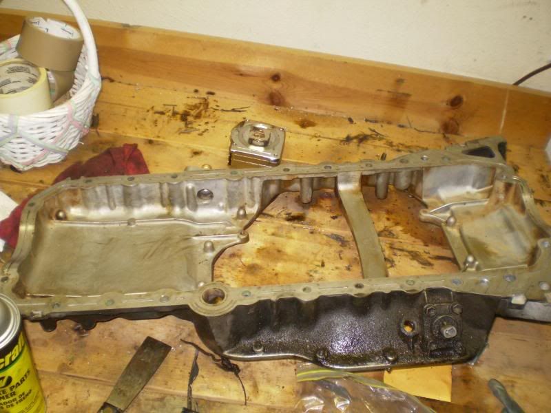

Onto the pans:
Note the dent in the lower left:
Better:
Pan installed:
And thats it for tonight. Time for a shower and sleep... Should be bolting the head to the block after some cleaning of the deck. Woot! Also should be pulling the 7M out on Monday. Think it's developed a BHG (along with the already existing rod knock) during the process of this build. I think it's mad I'm getting rid of it.

Rennant - I meant the inside of the main section of the pan. (gasket surface as well) however the pick up cover part of the pan was pretty damn clean. Should have seen it before...
