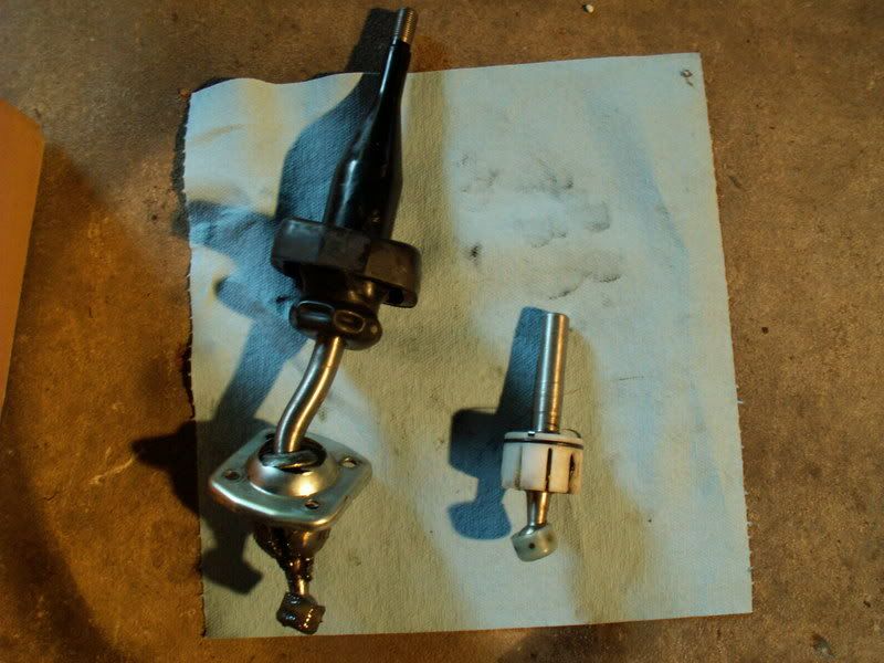

At this point the shifter can be removed from the housing. Here we see the major components: Shifter, housing, wave spring, and retaining plate:

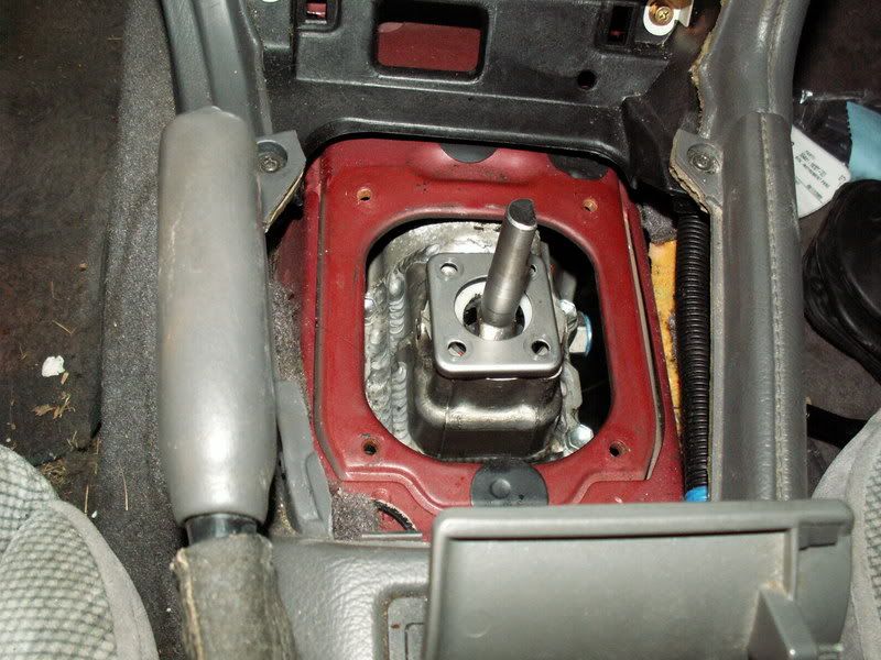

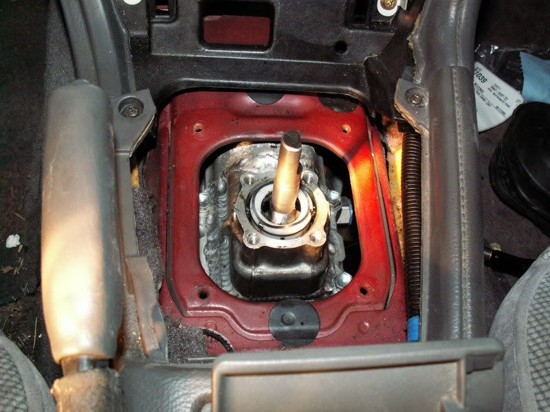

At this point we can slot the Solstice shifter into the Supra trans:
Unfortunately, the attachment plate does not line up:
But it does shift. I was able to get gears by holding the plate down with one hand, and moving the shifter with the other.
I can think of 3 ways to fix this problem:
1) Ream out the holes on the Solstice plate
2) Swap over the Supra plate. I was not willing to do this for the sake of the pictures, because I'd have to destroy the Supra shifter.
3) Finally, it'd be a fairly simple matter to just cut a new plate with the proper bolt pattern.
