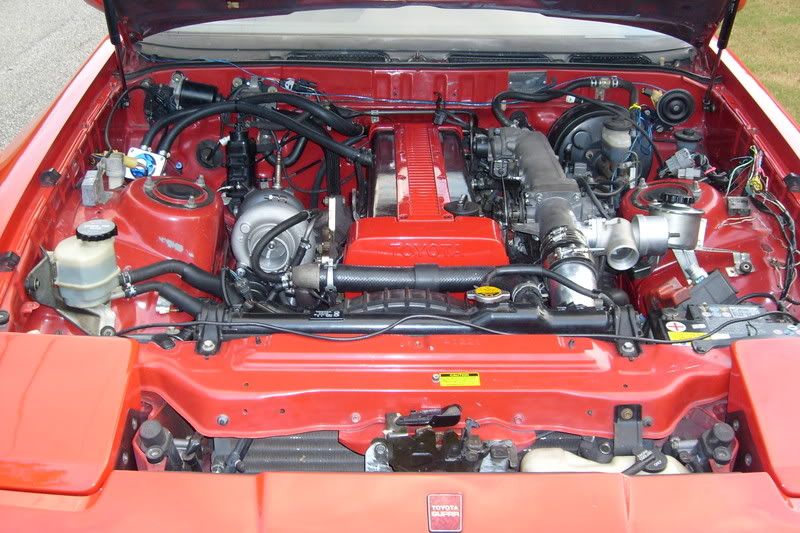

how much clearance do you have between the strut tower and the CT26?
im thinking it should fit fine on mine, but all you guys are running LHD Supra's with all the Brake booster and Master Cylinders all on the left hand side of the car. As my GZ20 Soarer is RHD all that crap is on the other side and I'm wondering how good clearance is going to be... Chassis is identical to a A70 except for being 2" Longer from the firewall back on the Soarer

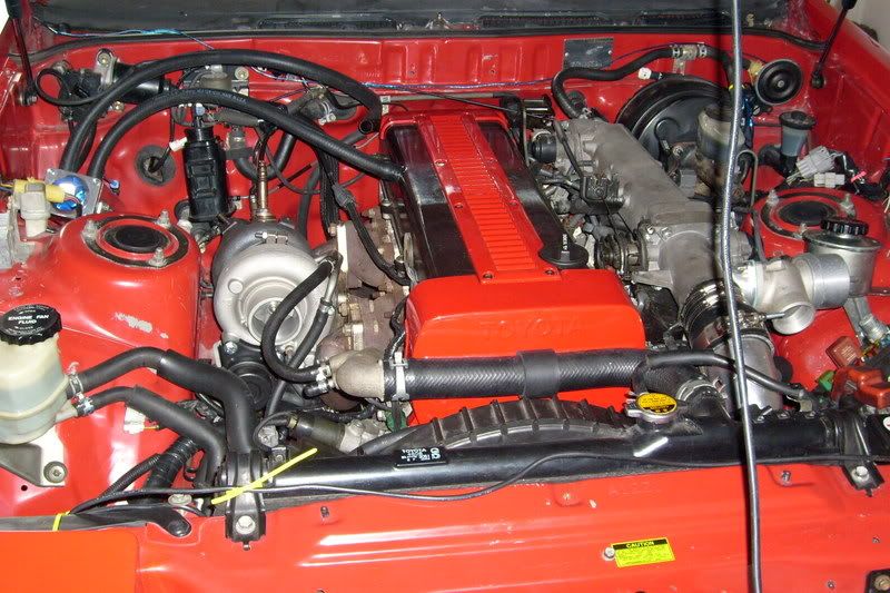

Pic of my bay ->

it should fit perfectly fine, its not going to be sitting on the back 3 exhaust flanges. its going to be right in the center. But as far as your DP goes there may be some clearance issues

I'm excited to see the results myself. As far as clearance i have a picture i can show you. The downpipe i got from optionimports fits perfect also, its the one that eliminates the turbo elbow. Take a look...........

I can get more pictures, i'll take some this saturday and post them up. As far as aaron he stood me up for the ct manifold i had to buy my used from someone.
