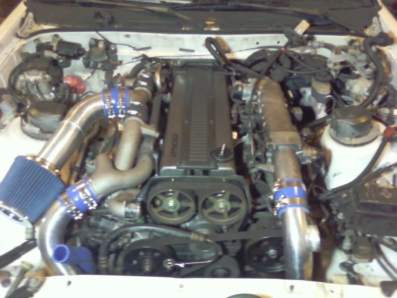

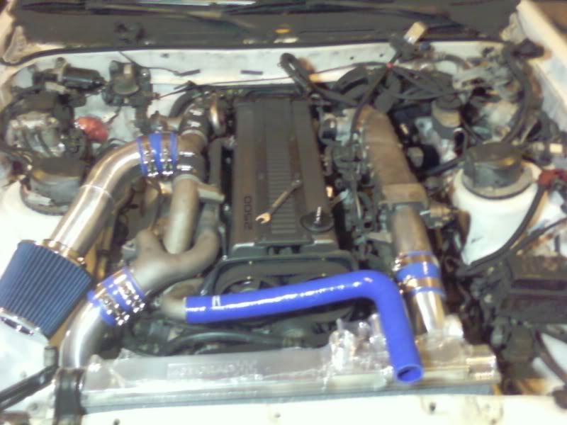

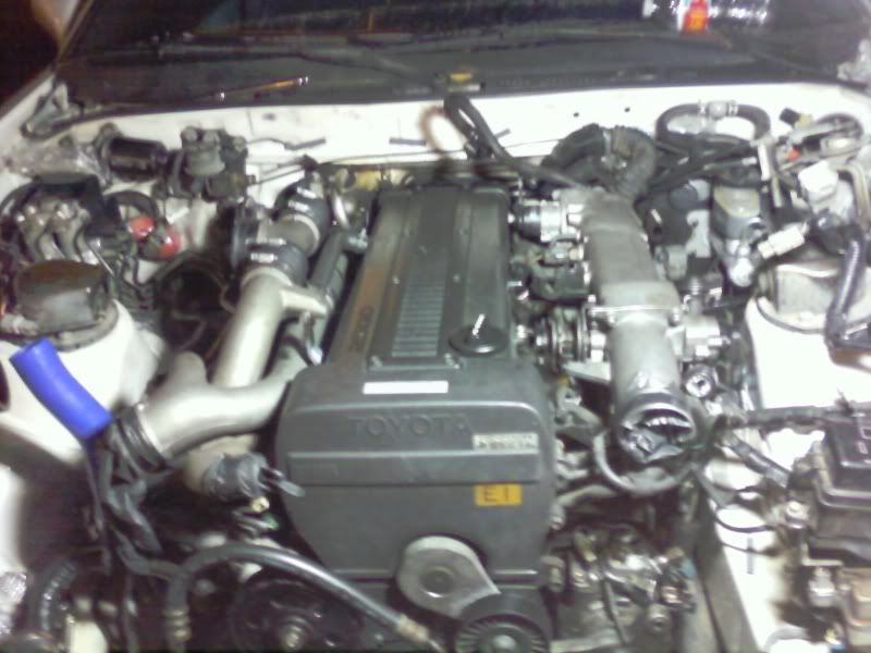

It was a combination of how I was approaching it. I had the rear of the car jacked up and was trying to put the motor in with the mounts attached. Kruso and I jacked up the front of the car, removed the mounts, slipped it into place, put the mounts on the motor, and bolted them right up. It was silly how easy it was to do that way compared to how I was approaching it. Here are some pics, sorry for the cell phone quality, I will get real one's on here after this weekend:
