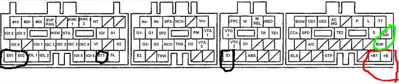

Dont rip out the harness just yet. I did that and that was not my problem. I had the exact same symtoms your having. Turned out it was my ecu. but you said your not getting voltage at the igsw right? Here is a ecu diagram.(curtisy of yotarob)
These are the pins you need to check, Red is constant 12v, Green is 12v with ignition on, Black are grounds.
Check those wires mentioned above and also check that your engine light is coming on when you turn your key that will tell you if your ecu is working. GL

Constant 12v has no voltage what so ever. Even with key on. Wire BATT has voltage even with no key and with key on and the other wire is fine with the key on, no voltage with the key off.
Basicly no voltage at the +B1 and +B with key or no key.
