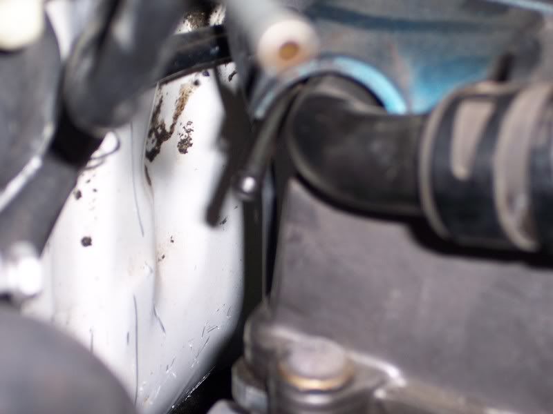

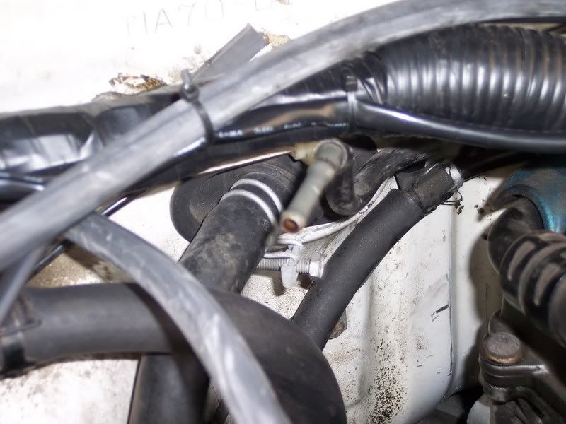

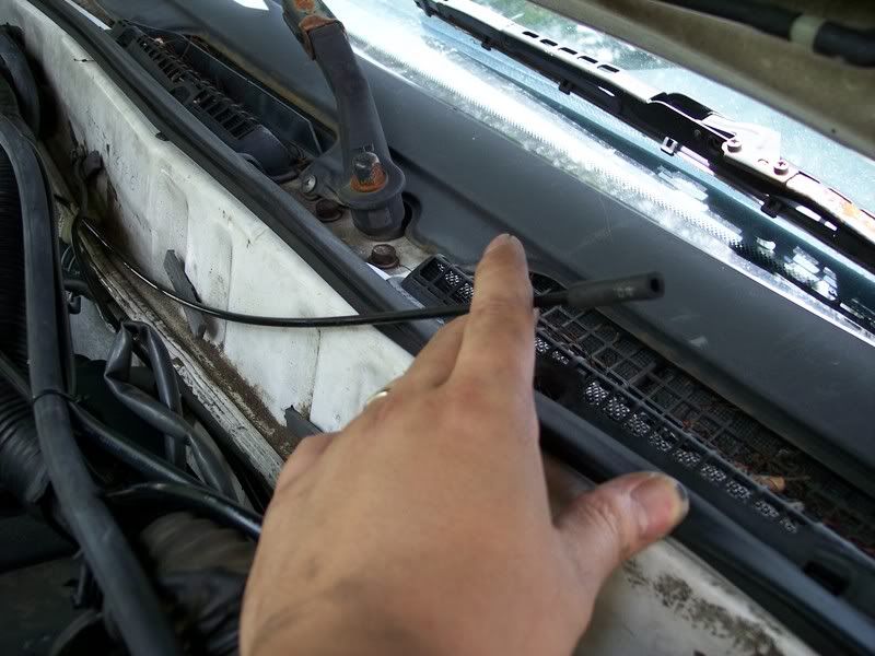

what are these?
that hose is connected to the heater valve, where does the other end hookup?
i think this went to the charcoal canister, what do i do with it now, no cc.
this one is the hissing one, havent a clue what to do with it.
Bigzavs
86.5 1JZ Single Turbo
Apr 21, 2005
2,267
Arlington, TX
the second one was for the stock bov i believe, you should block that off if its hissing, thats quite a vacuum leak

thanks guys! what do i do with the one from the gas tank? right now its blocked off. what about the one from the stock bov? when i put my finger on it, the motor dies. ill try again in the morning though. hopefully its causing the boost leak.
