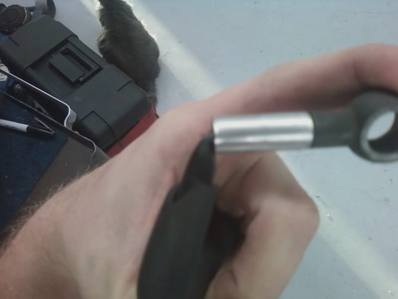

Okay guys small update:
I put the AFPR back on with the brand new diapram, I set it to 40psi with no vacuum. With vacuum it sits around 30 something. and when I go get into boost it goes up to 40psi but once it hist positive pressure, it immediately drops to 15-20psi, goes lower the longer i pull/further i go into the RPMs
I have:
A brand new 255lph pump
A brand new fuel filter
NO dirt or junk in the tank
DM feed line Is on
injectors were flowed/tested
12v mod
So Can anyone tell me why my Fuel pressure is dying in boost? Ive tried different vacuum lines, and different ports! please HELP!

Do you have a new feed line from the tank up? Make sure there's no kinks or anything in any of the lines. I would probably do a fuel pump volume test to rule out the pump, supply lines, etc. If you know the pump can flow the correct volume as tested from the line leading to the rail, you know no lines are restricted and the pump can do its job. If the volume test checks out you know its something after the supply line at least (assuming its not pump voltage under wot causing your problem).

Look at the line coming out of the filter

mk3tattoos;1636702 said:
glad to see you found the problem, good call CyFi6! lets see a video of that beast in wot now:)
guess thats what happens when you change the fuel filter in the middle of the night?
now its shooting big fire balls/breaking up in boost so need to be tuned with the bigger injectors. atleast we know its getting some food
