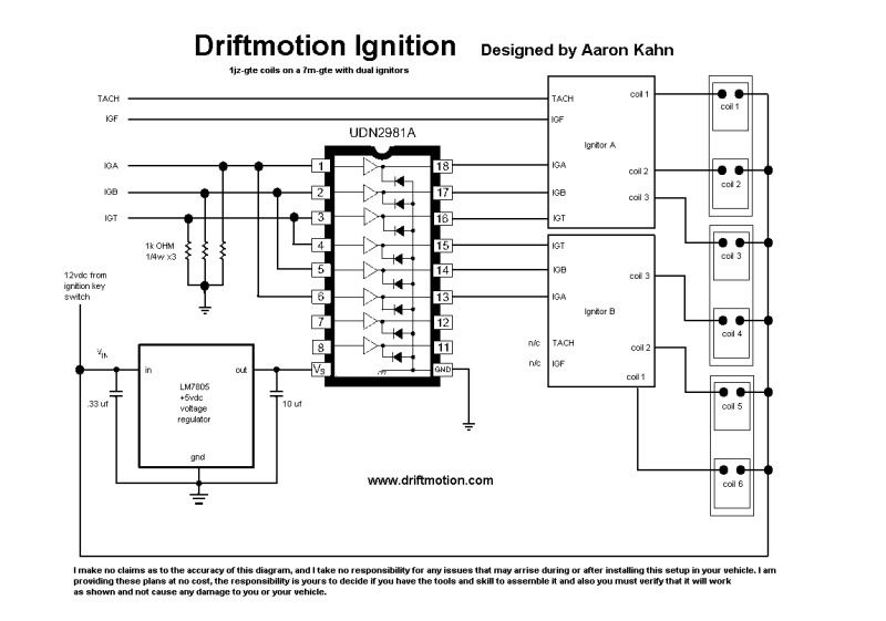

Is it possible to run other coils instead of 1JZ coils with this setup and OEM ECU? What about coils with 3 or 4 pin connection? Does it work? And how?
Here's a question -- what are the main differences between running this setup and Tookwik's 2j coil setup? Mainly, what are the cost differences? Is there any advantage to running one instead of the other? Performance differences?
