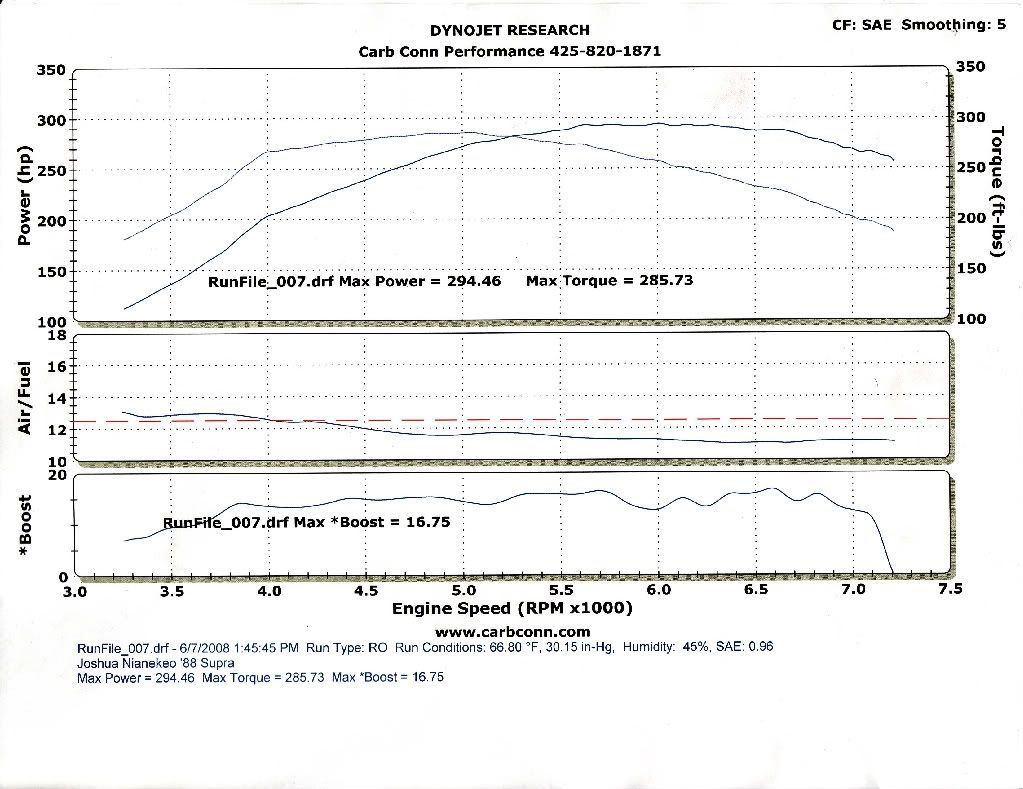

I finally found the time to do my single turbo setup. I did the swap overnight on the weekend. The twins were such a pain to get off, it isnt even funny. I spent about 3 hours taking it off. most of the time was spent on the exhaust studs on the mafold. :icon_evil But eventually I got em out.
I've been running single turbo for about a 2 weeks now. I was first boosting 8psi at first. then I managed to get my Boost controller installed and bumped it up to the stock twin pressure-(~12psi). And until recently I bumped it up to about 13-14psi. I'm still waiting on my FCD. and more tuning. THE car is Super loud when the waste gate opens. But pretty quiet at idle and normal driving. I installed a cheap 3"high flow muffler to deafen the sound a bit.

I had the car Dynoed today during a BMW Dyno event at Carb Conn in Kirkland using their DynoJet. I was extremely lean when I first got on the dyno and we did a small 10min tune and got it all figured out. I decided to just keep it around stock boost levels and get my tuning straightened out first and here's what I did. The boost reading is high by 2-3 psi. so i was somewhere around ~13-14psi.
Heres how it did on close to stock boost:

Sounds great, wish it was closer. maybe I could get a few people up there for an event to help out. When are your events? whats the cost? how many pulls? baseline? What kind of dyno is it?

They usually charge around 40, 3 pulls with graph, but truthfully we just like to see numbers so it isnt really rushed or anything. You just come and have fun. :) I am sure there will be a dyno event soon.
