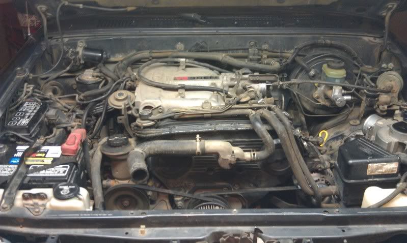

Truck in question:

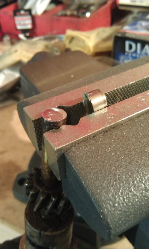

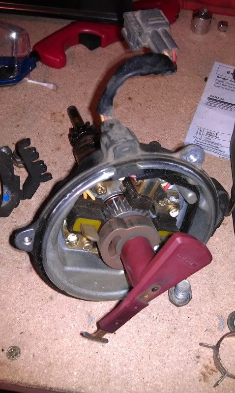

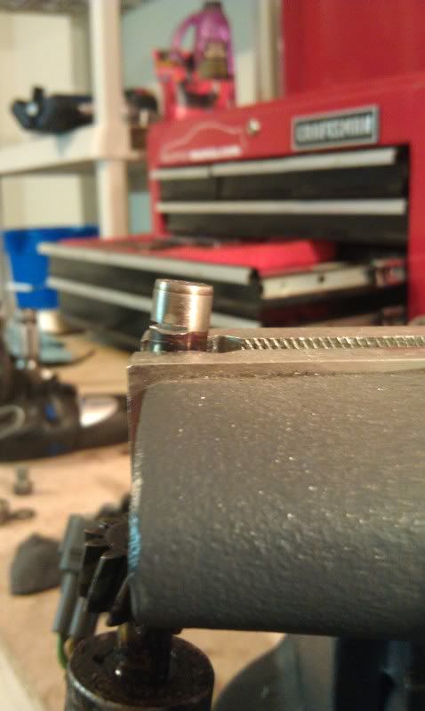

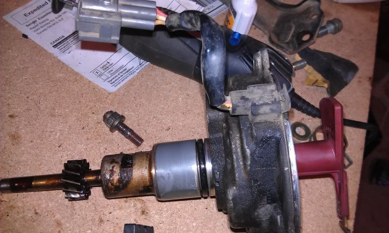

Dizzy that wont fit:
After a day of hunting local yards and finding NOTHING I decided to cut the damn shaft that wouldn't fit. I found out later model years had the shaft missing. Looks as if Toyota decided it was not needed. so here it is:
NOW A FEW ???s:
When I simply touch the distributor on the outside insulation of plug wire #5 I get shocked REALLY good. Is that normal? I can't recall ever having a plug wire that's attached to the dizzy shock me. :dunno:
It still runs rough, but I need to check compression and could definitely use new plug wires, cap and rotor. The motor sounds loud at the front. As if there's an air leak in the intake manifold. very strange. Are the 3vze's notorious for any kind of leak or source of loud noise?
I'll have to spend some time playing but for now, it runs, stays cool and definitely has more power than before. :)
