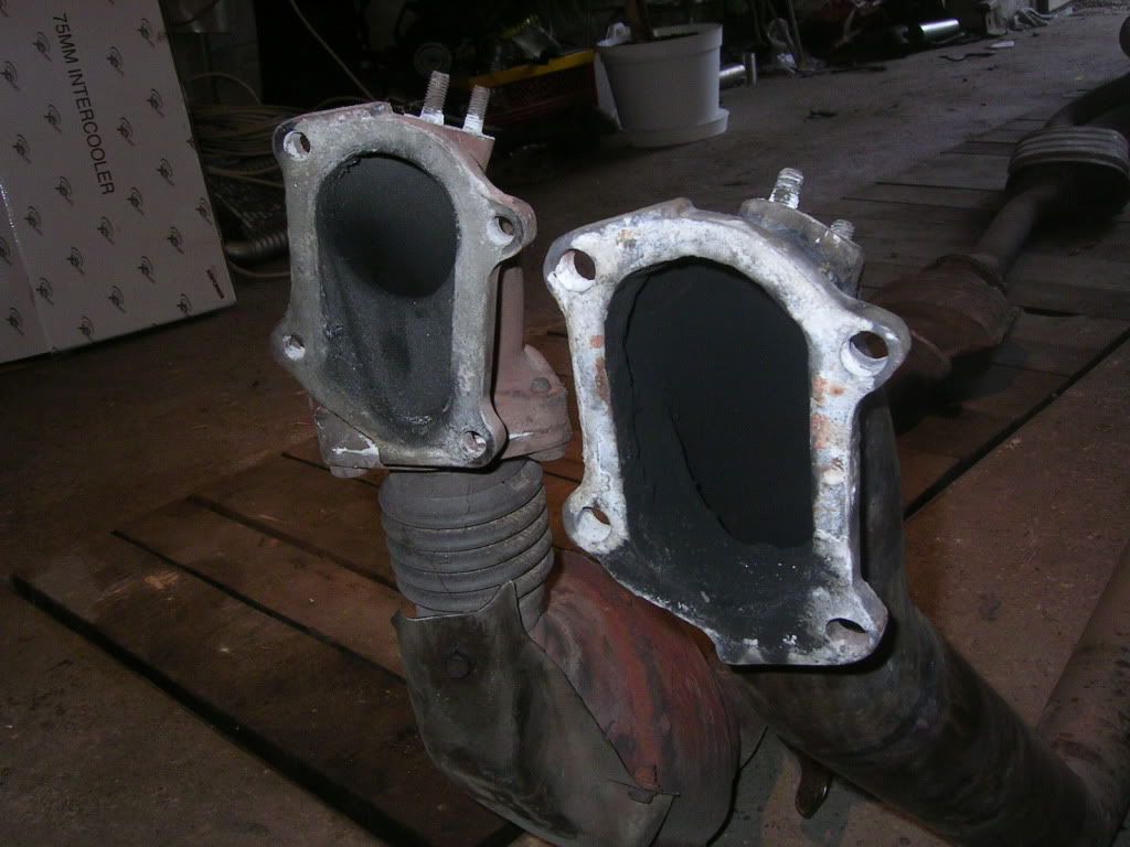

Orion ZyGarian;1858041 said:
The biggest gains on a 7M will be from replacing the exhaust. Here's a picture of the factory downpipe/turbo elbow that blocks off the wastegate's flow compared to an aftermarket one:
this is my exhaust (made myself...) in my garage :icon_bigg
