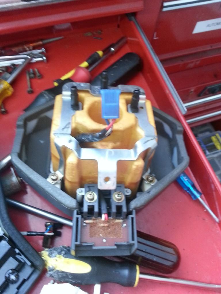

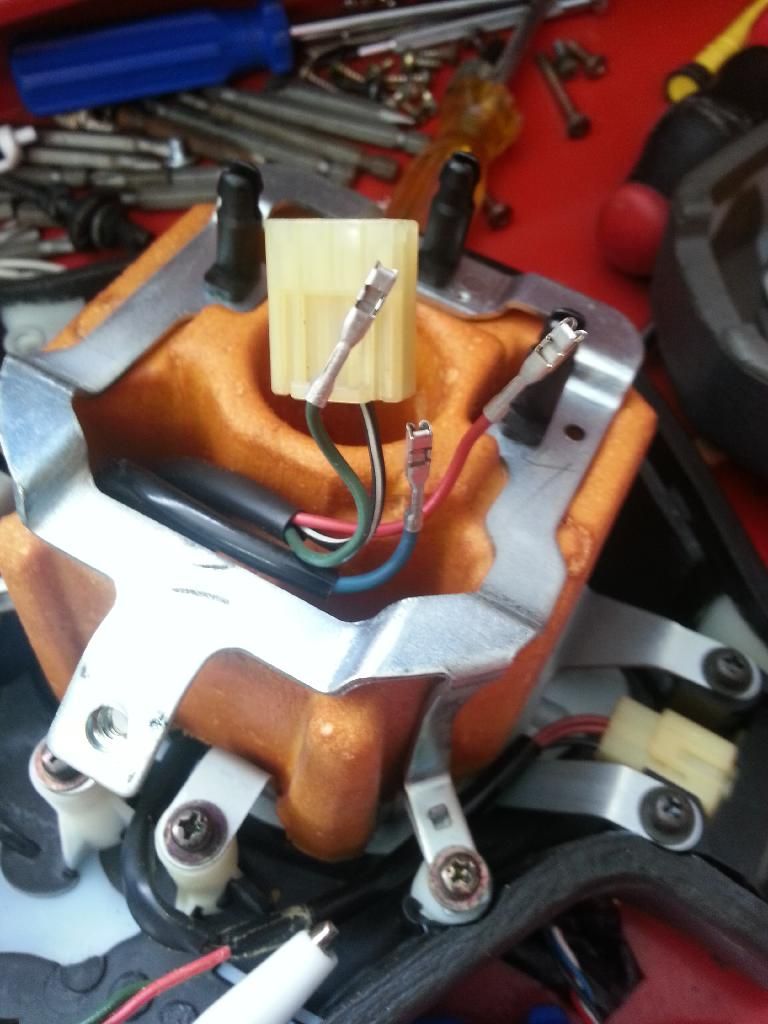

So a small update here. I really don't like the crappy steering wheel that my 87 had stock.I bought an 89 supra steering wheel on ebay for cheap and noticed the connector on the back isn't the same. However, now that my digital dash is installed, cruise control started working perfectly. I didn't want to lose those buttons on the steering wheel, so I had to change the connectors between wheels. To do that, I took a small jeweler's screwdriver to unlock the pins from the connector. if you look down the front of each connector, you will notice little tabs holding the pins in. Gently pry them up with the screwdriver and they should pull out without too much trouble. It is a 4 pin connector and the 87 steering wheel is a 3 pin as you can see here:
That 4th pin is just to arm the cruise control system, but our old cars have the switch next to the fog light switch. That wire is the black/white one in this picture:
As you can see, I removed the 3 pins you will need. You need to pull the pins off the blue connector on the stock steering wheel and put the blue enclosure on the 89 steering wheel. Red and blue wires match on both wheels, but the green wire goes in the middle for the 89, vs the 87 having the white wire like here:

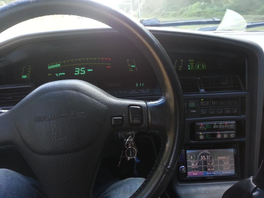

Once that is done, you will have a much better looking steering wheel with working buttons like this:

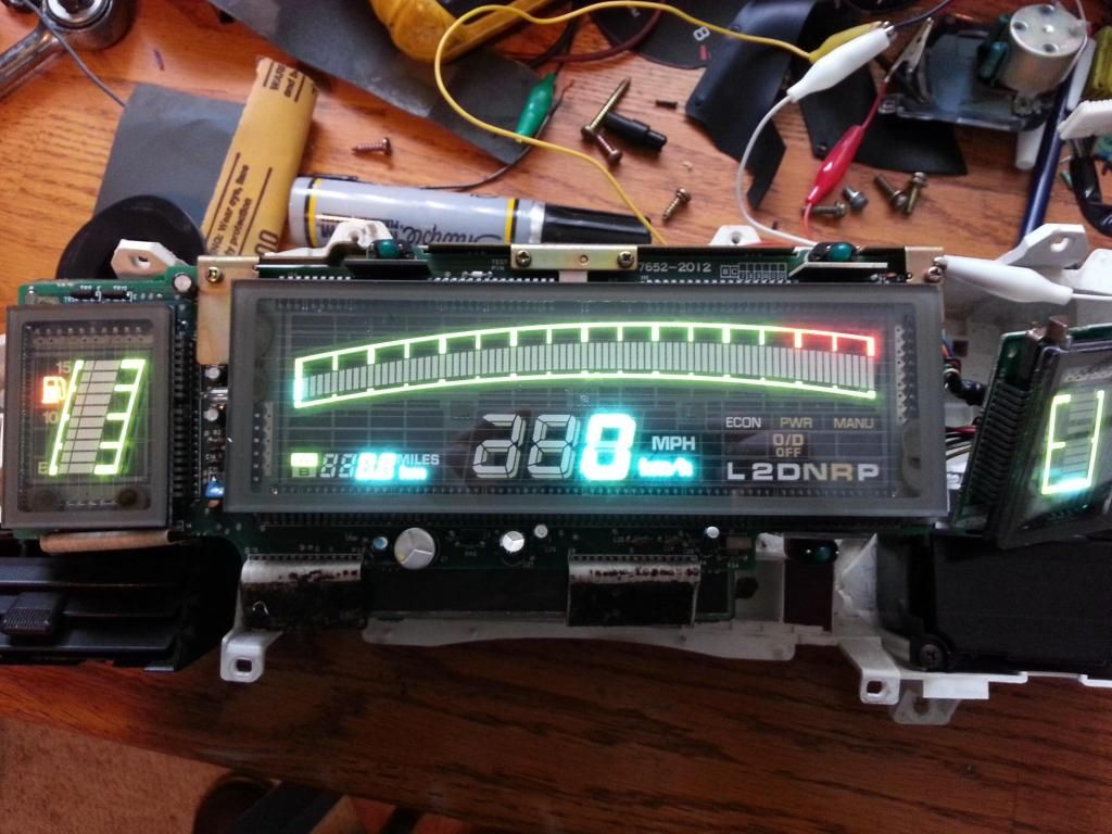

I also decided to add a couple features to the car as well. The digidash display has 3 indicators on it that were designed for the auto trans. These are ECON, PWR, and MANU. you can see them above the PRND2L area on the main display:

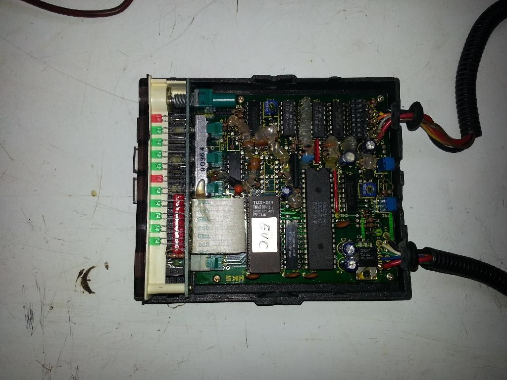

I really thought the POWER icon would be sweet, especially since I imagine Jeremy Clarkson saying it. I looked at my HKS boost controller and saw three mode switches, LOW, HIGH, and MANUAL. I thought it would be cool if I could link the boost controller to the digidash. Good news, it works! First, I disassembled the boost controller:
Flipping the unit over reveals these switches and mode LEDs:

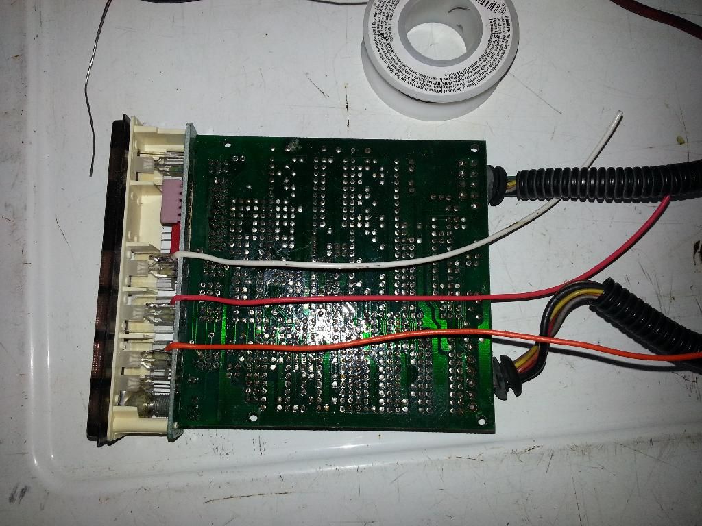

I took a dremel tool and notched out the board a bit to clear the wires I would use for the mode outputs. Then I soldered the wires to the board as you can see here:

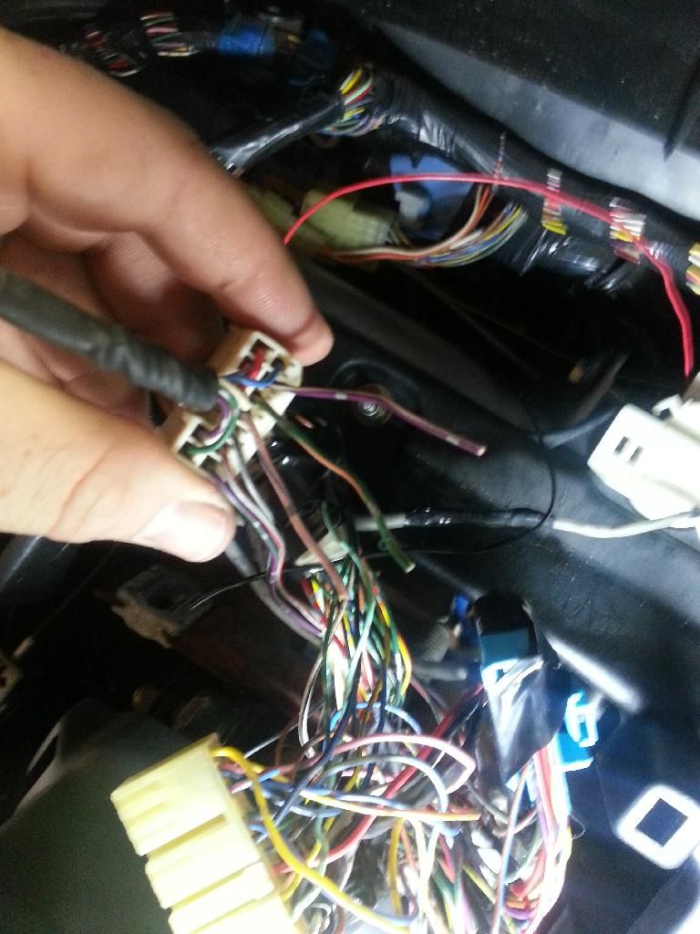

I used different color wires to tell the difference when I put the case back on. Orange was Manual, Red was High boost (PWR) and White was Low boost (ECON). I put it all back together and ran the wires to these three wires on the 12-pin connector on the back of the digidash:
Pin 7 (Purple with White stripe) is the ECON light
Pin 8 (Green with Orange stripe) is the PWR light
Pin 9 (Pink with Light Blue Stripe) is the MANU light.
