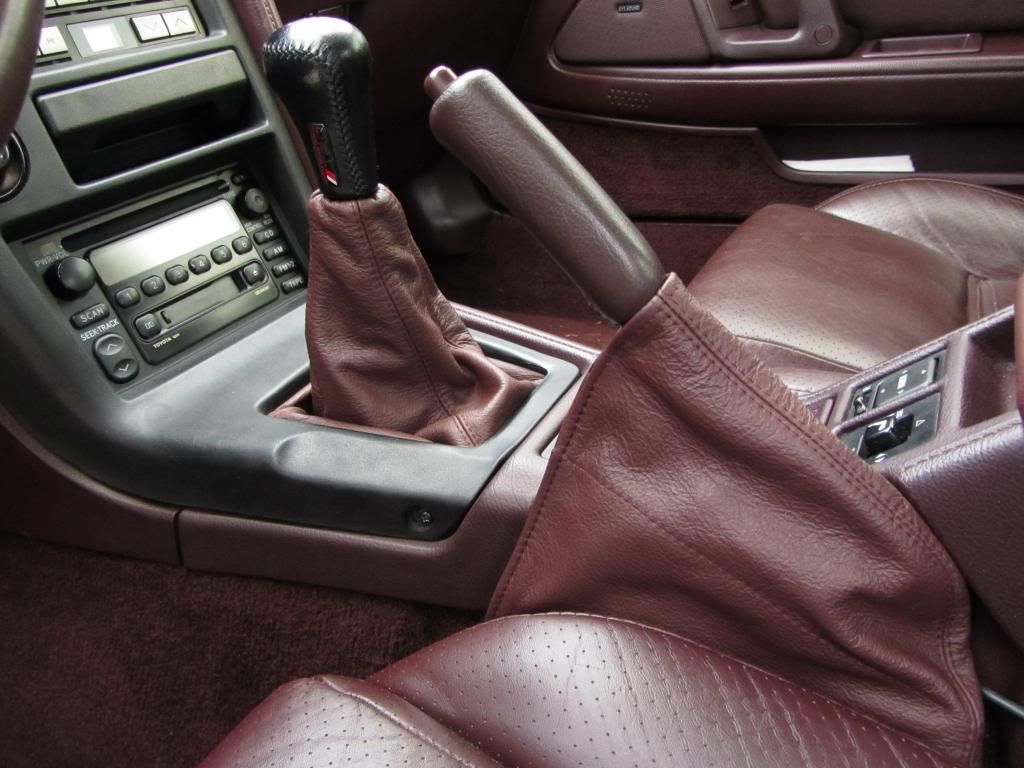

Congrats on the award! For the boot if you don't go OEM Toyota I would highly recommend Redline leather goods. They're stuff is higher quality than the OEM stuff, and I can tell you only want the best for this car. That's what I've got in my Supra. The shift boot, ebrake boot, and armrest cover.

I have two OE boots for the car, one from an MA61 Supra and one original for the AE86. I just switched back to the AE86 rubber boot and won't be changing back again I don't think.
So no leather boots for me anymore, lol. That was 18-year old Jeff's decision. ;)
