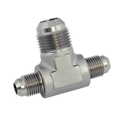

I thought I found one on summit called Mr Gasket SR106, but the picture is WRONG:
Instead, I received a flare reducer from -10 to -6an
Does anyone know where I can find a Tee fitting like the above picture that converts a single -10an size to dual -6an outputs?

I just want one fitting that converts a single 10an fuel line to dual 6an outputs. Tee or Y does not matter to me.
