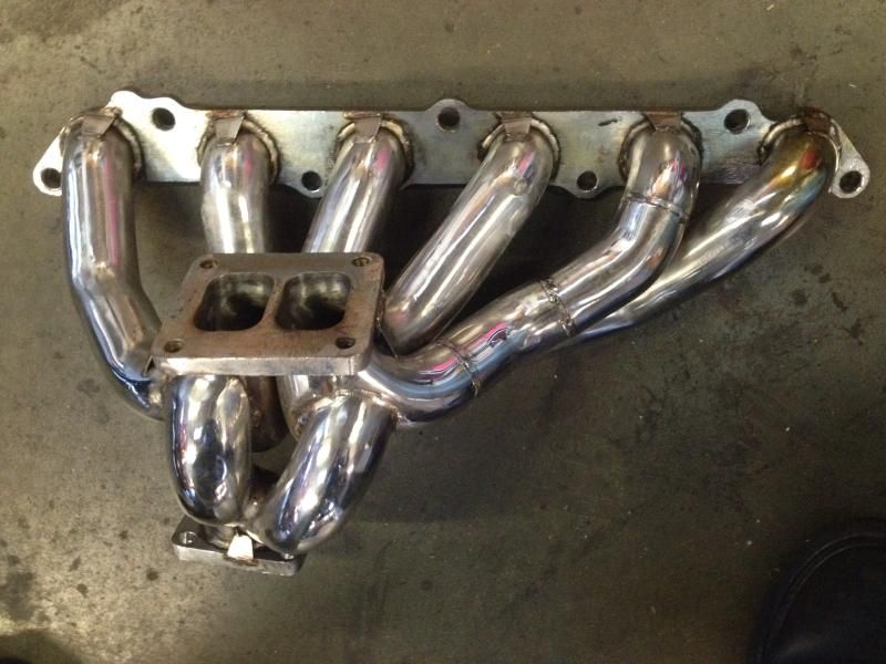

Exhaust mani

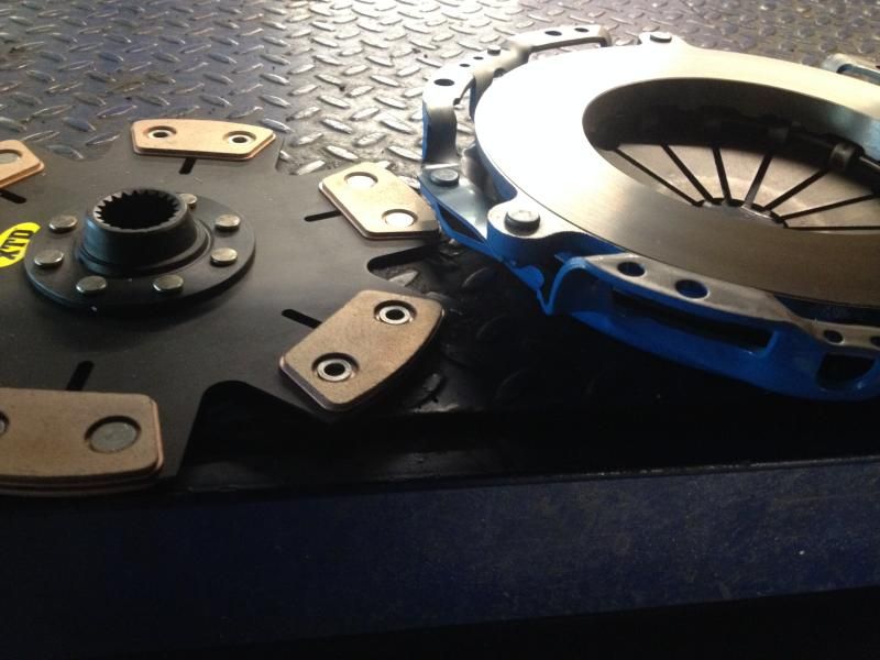

Clutch is in, welded up diff is out (whew) pulled it out the shop on its own power which was nice, but its still on the bad turbo :)

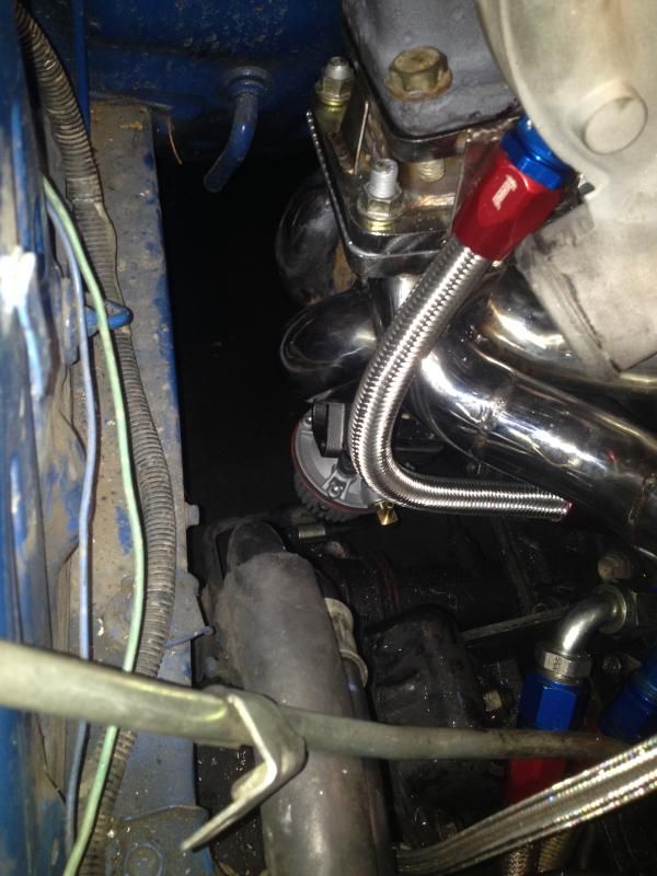

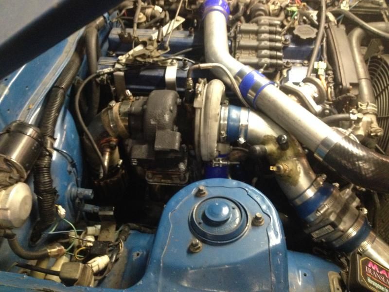

Oil drain done, will get some heat shielding and hope it doesn't get scorching ass hot

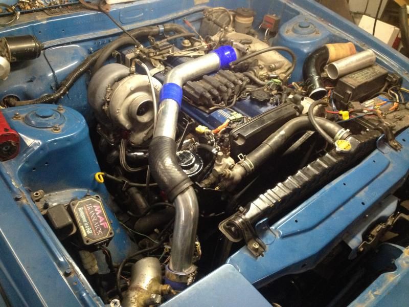

Cold side piping all squared away
mk2 supra
Nov 28, 2009
106
Oregon

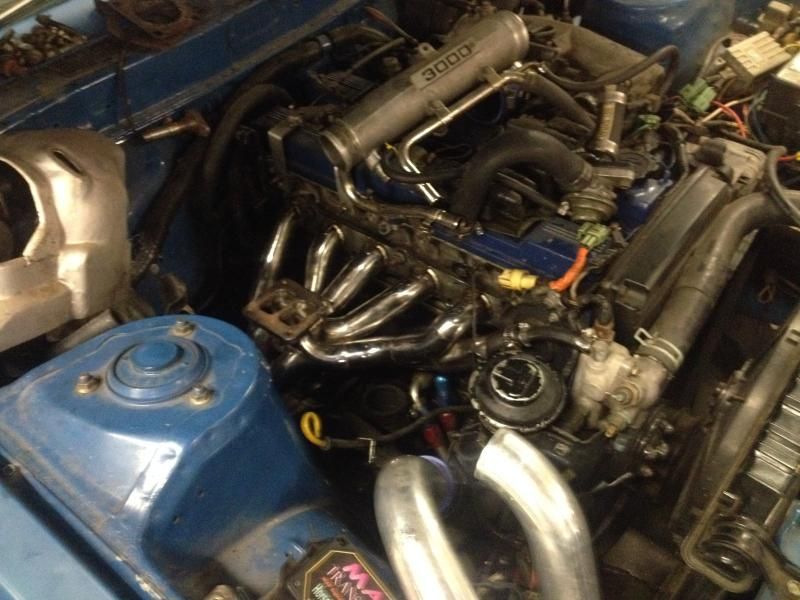

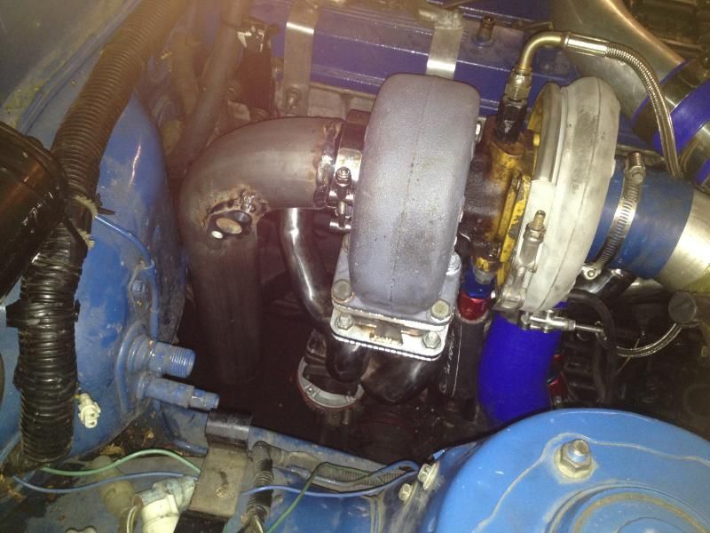

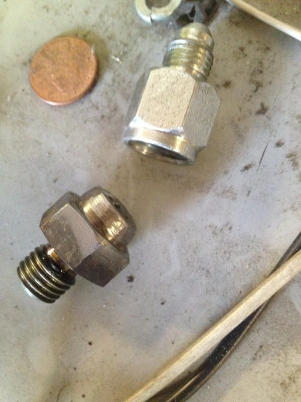

Got a lot done tonight. Drilled and tapped the comp housing for boost fitting, ground down some nuts to clear the mani and bolted the turbo down, clamped the remaining intercooler piping, started on downpipe, v band on, O2 flange on, just have to put flex section on and tie it back into the existing, the wastegate dump tube is built, vacuum lines with MBC, I literally just have a few things left! It's driving in and out the shop to work on so that's nice, just need to do bov flange, some heat shielding and tidying up wires, intake pipe, that's about it. Should be Rollin tomorrow night

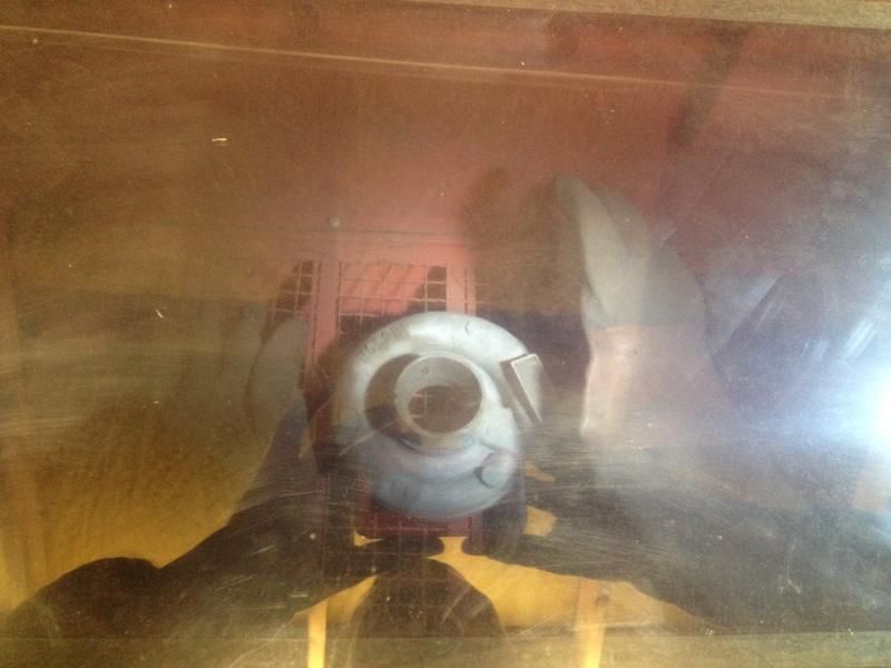

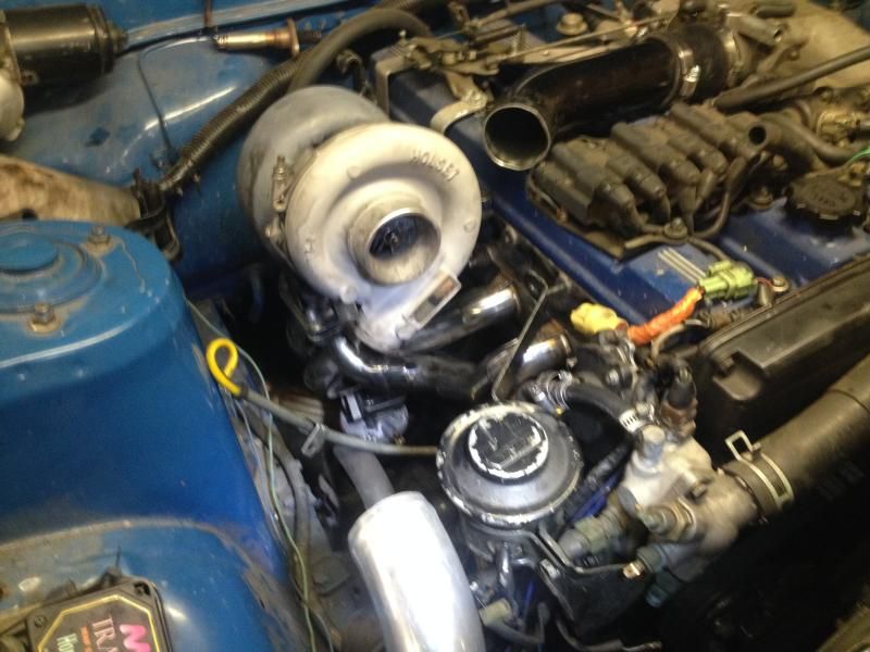

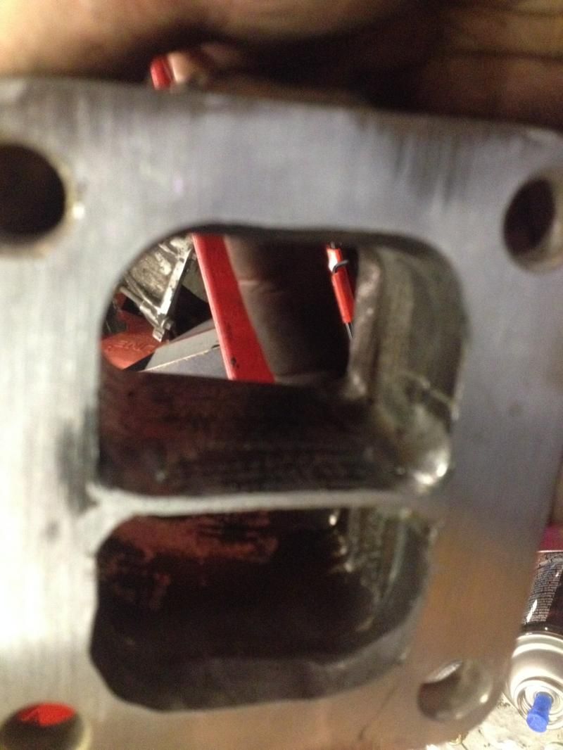

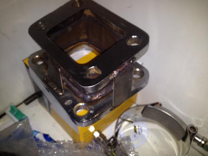

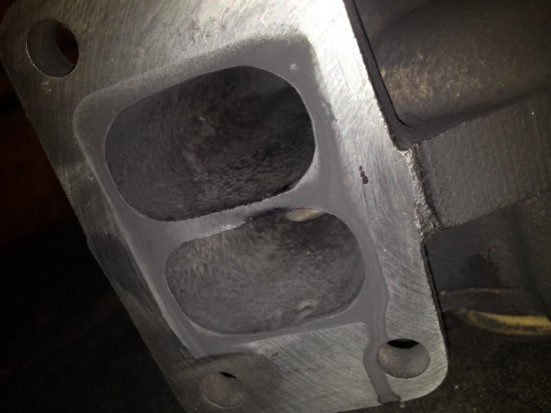

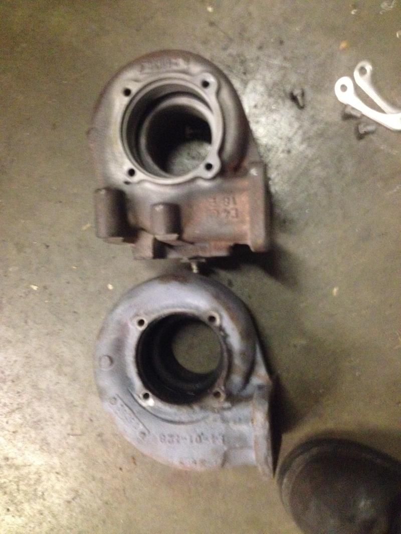

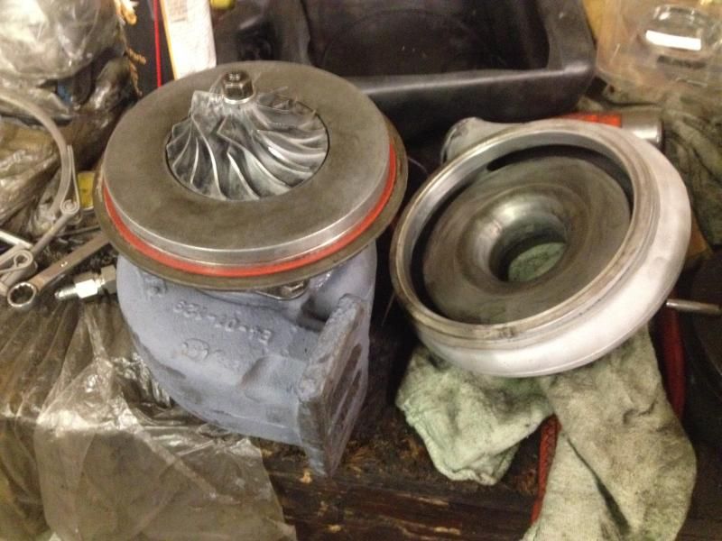

And todays update is all about....SPOOL. This first holset setup was throwing things on, and seeing how it went. Now this time everything is refined... First was going from a 18.5cm housing to a 12cm, that I got for $60 :)

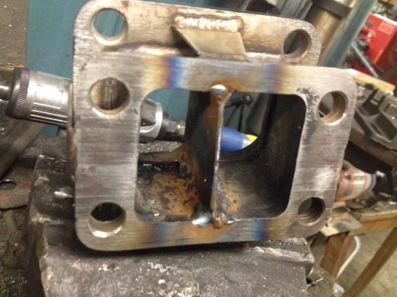

Then, on the T3-T4 adapter, going to twin scroll, and welding in a divider plate
Ported down/resurfaced
Then of course port matching everything
This is a wastegated housing, which means the outlet is moved back about an inch, this actually messed with my downpipe placement quite a bit, had to cut/reweld quite a few places.
And the results...dramatic
Went from 4500-4600 full spool in 3rd, to 3500-3600... Moved my powerband 1k sooner, its a little quieter is the only downside but oh well, thing is quite an animal, spins the 245s in 3rd, in the dry. Thanks for reading! Better track times to come

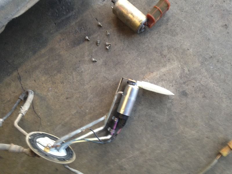

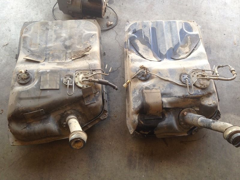

So first thing this go around was.... getting rid of my fuel situation. Having an inline pump, and no pickup sock, I resorted to an inline coarse filter before the pump, which would clog about ONCE A WEEK, and had to service it, pump was super noisy except the day it was cleaned. Got an 84 tank
Which after comparing tanks, looks like just filler neck and pump hangar are different. Went to an in tank 255hp pump
Nice and quiet pump now its fantastic

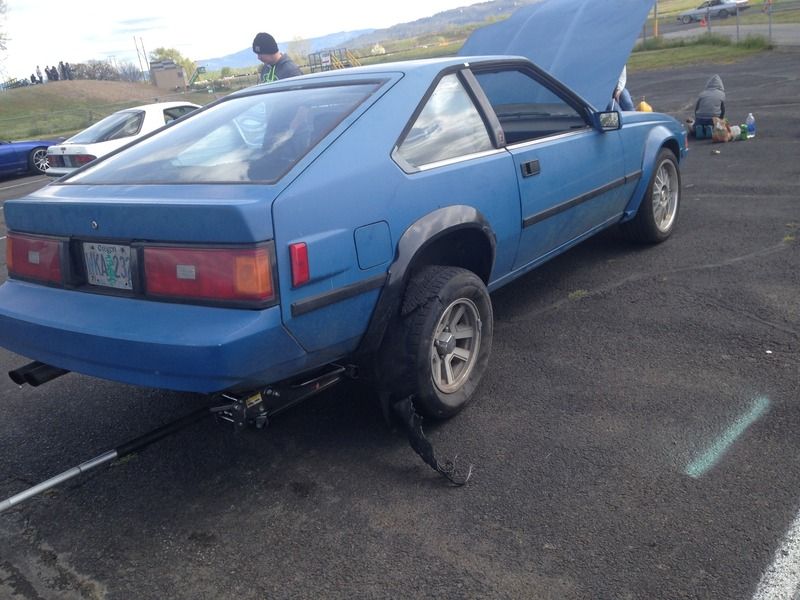

So this was a big day today. There were both a drift comp as well as drag racing opening day. I thought "do I dare?"
After some thought and prep since this is my daily right now, I made it happen. First was a cruise.
So drove to drift comp, switched tires
So first time drifting after the changes of-clutch, 3.7 Weir LSD, holset turbo. Thoughts are it does have a touch more lag, but when boost hits its a freaking beast. The LSD is smooth as silk, I can't believe how perfect it is. Doesn't chatter but always 2 tires when you need it. I still desperately need suspension and steering mods, thing was hard to control but eventually got the hang of it, did about 8 laps, going through 3 pairs of tires. Only issue was tire detreaded and pulled a wheel flare out, but drill and zip ties it was just fine.

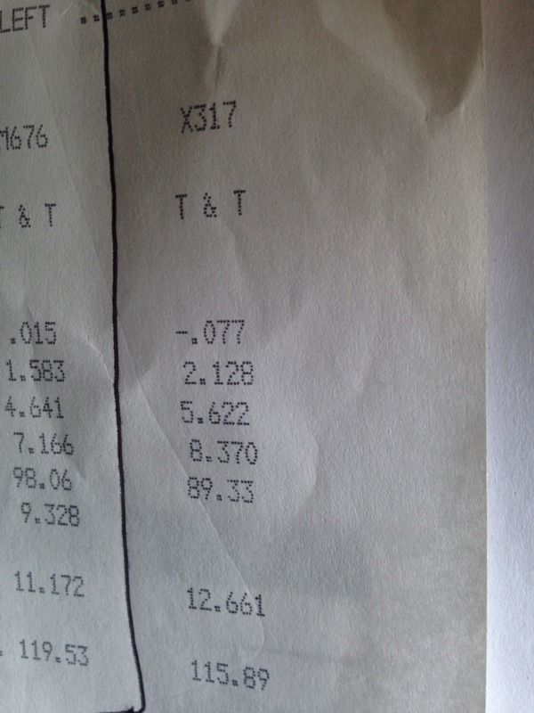

And my 1/4 results...
So at the start of this long journey, I said I wanted at least low 13s on stickies and 300whp, and then beat up on the 240SXs and such drifting. Well I pretty much own the straight end and surpassed those goals, I walked a 1UZ Cressida like he wasn't even trying on the freeway, but I need more steering angle and suspension, the drifting of this car needs work. That definitely needs to go on my list asap.
