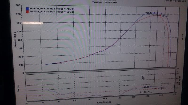

My 2jz mkIII waking up after 4 years on the Dyno

Nice!!!! Any more info on the car?
1989 Turbo Supra w/
2jzgte 94'
upgraded Turbo to 80mm Borg Warner and has SSautochrome manifold with a custom brace
Tail 44mm E/W/G
Precision FMIC Custom Piping
850cc Delphi Injectors
Dual Feed Custom Fuel Rail
Custom Clutch Setup,upgraded to Spec Dual Disk
Custom 4inch Exhaust w/Dynomax Can
Dual Intank 255lph Fuel pump
Aeromotive FPR Kit and Lines
Aeromotive -6 feed and -6 return lines
Eletric Fans
Lotek Dual Pillar
AEM Cam Gears
AEM Uego Wide Band
HKS Cams 272/272
HKS DLI II
Greddy Pulley Set
Greddy E-Manage Ultimate
Greddy 52mm WHT Face Boost Gauge
Greddy 52mm BLK Face EGT Gauge
Greddy Profect B II Blk
Greddy Turbo Timer Silver
Greddy Type R BOV Changed to Tial BOV
Relocated Battery to Back
Stock TT Wheels
Tires Sumitomo HTR Z II 235/45-17F and 275/40-17R
Tokico Blues W/H&R Springs 1.6F and 1.3R Drop
630.77rwhp was on the old 66mm turbo setup with 3inch exhaust @ 29psi I think
717rwhp on new set up with 4inch exhaust @ 26psi
