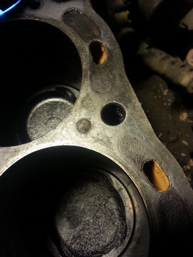

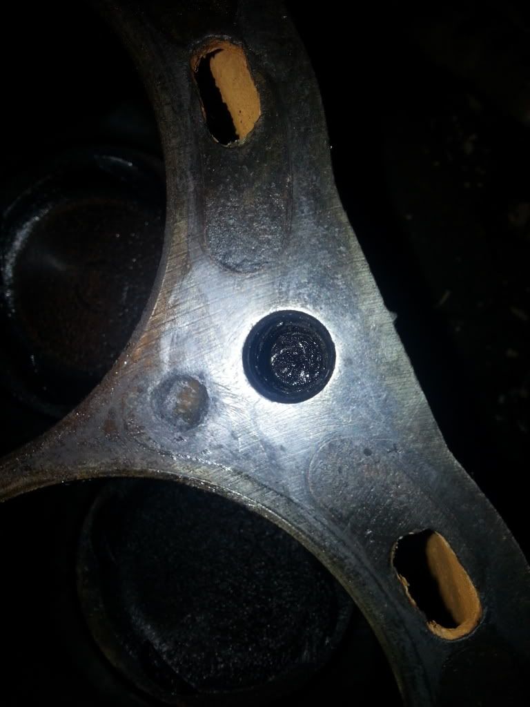

Well it's not cracked I tried to re tap it and put the head back on but can't even go past 20ft lbs

the more you try, the worse it'll get. you pulled the threads out basically. was there metal shards on the stud when you pulled it out? did you torque the stud to the block using an allen head socket or torque the nut on the stud?

Why ARP studs with the deck like that? An OEM or Fel Pro composite with factory bolts at 75 would be just fine. I realize you already bought the studs.
Turbo Habanero
Apr 28, 2009
4,229
Tucson,AZ
Yes it's just a oem gasket and headstuds really are not that much more expensive. Surface is surprisingly smooth. I'll prob take some acid tone to it after I heli coil the block.
