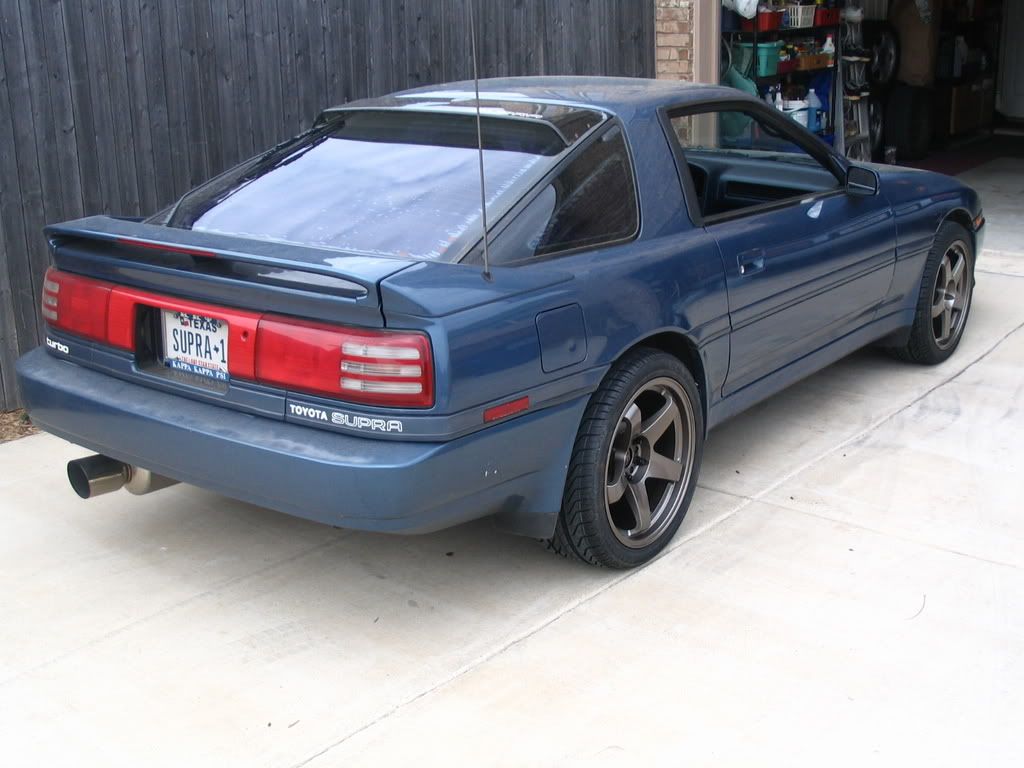

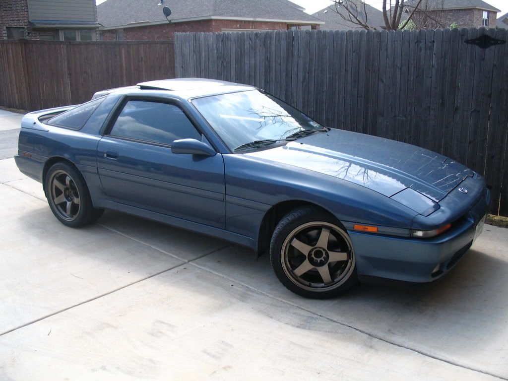

i was in a similiar situation not too long ago. i really liked the rota p45r's but they only came in 9.5 @ +30. i ended up running 18x8.5 fronts and 18x9.5 rears and it worked out for the best really. if you are serious about tracking your car i would stongly suggest going with a 17in rim as it will give you more space to do ride adjustments overall.

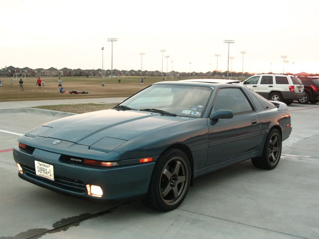

heres a pic of my car with the 8.5 and 9.5's..... i dont rub but damn is it close!

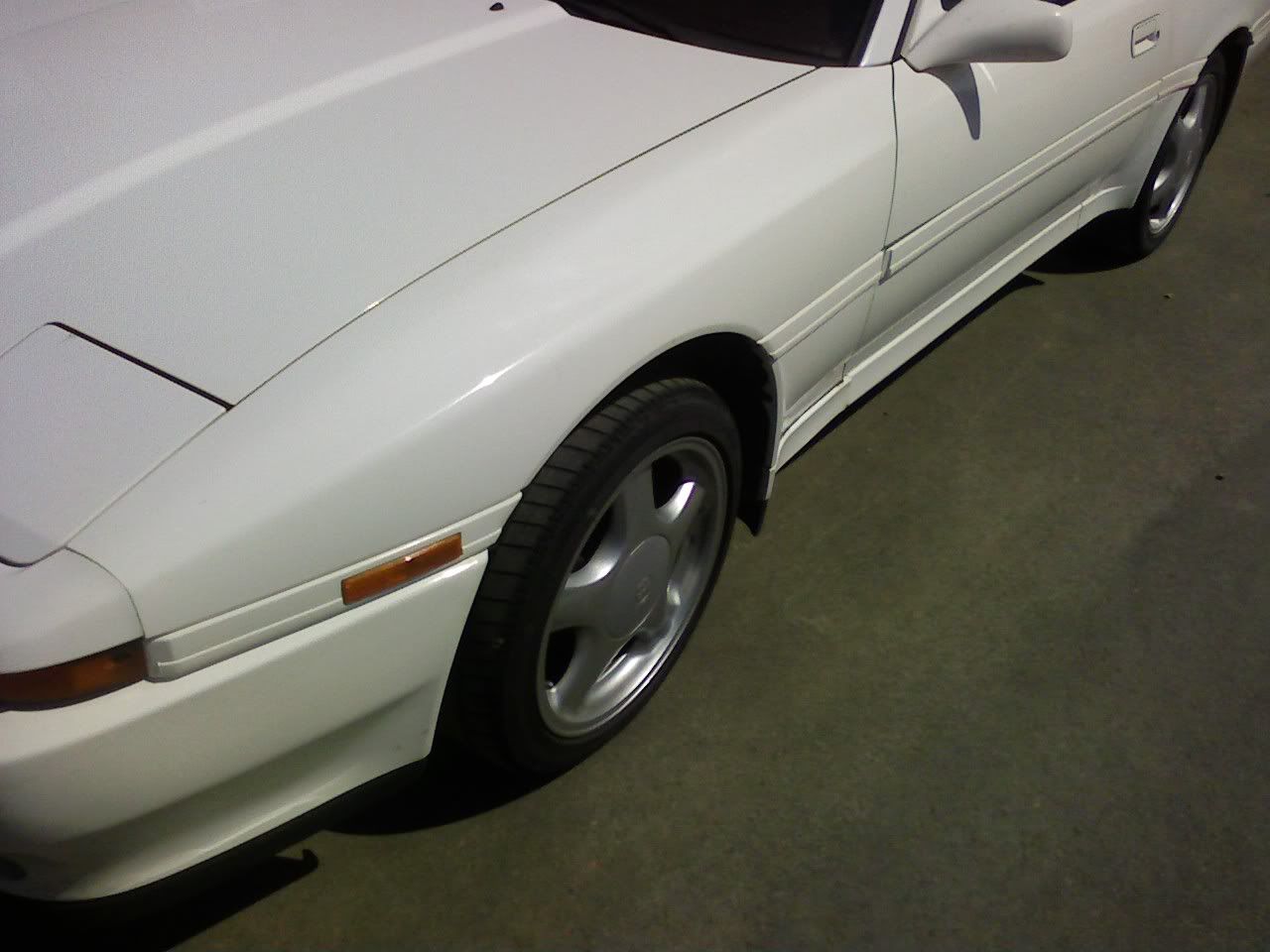

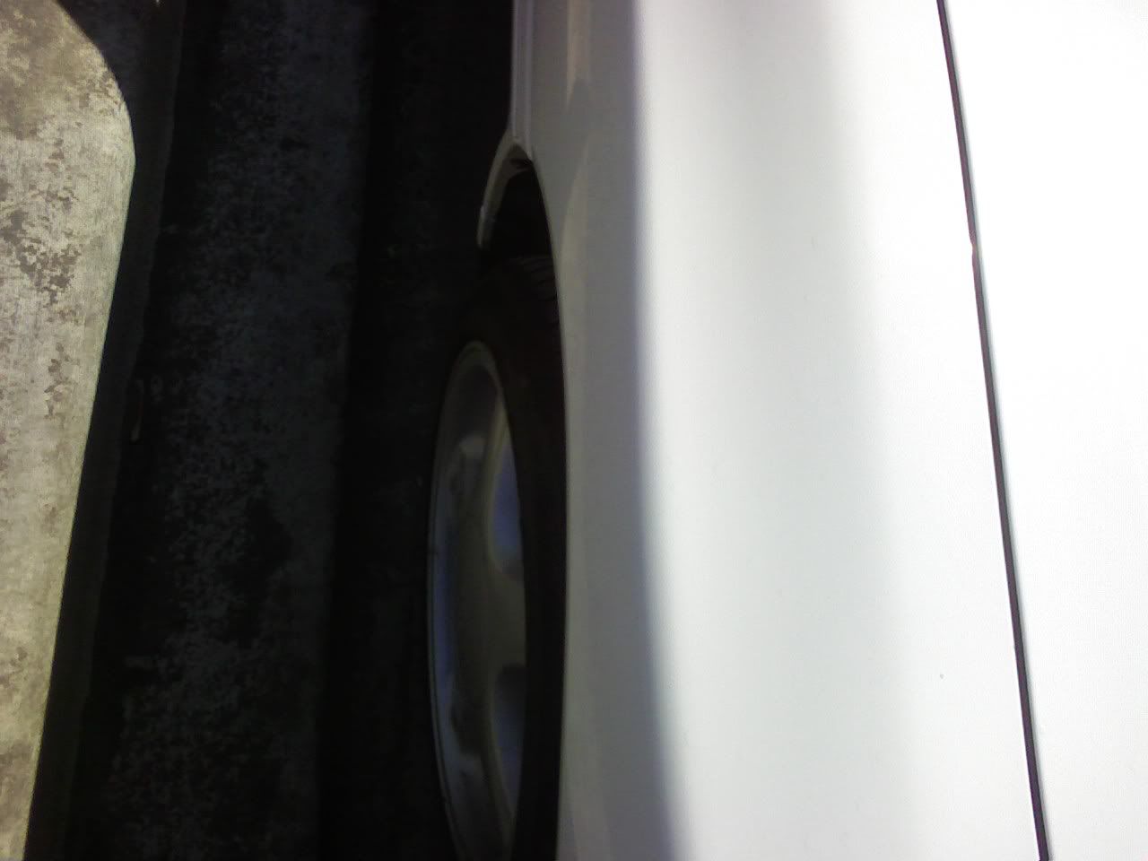

I'm running 9.5x17 +45 up front... I took some pics for you, but I didn't have my keys on me to straighten the wheels, so they're turned a smidge. Your +35 offset will stick out 10mm further and have 10mm more clearance inside.
Also, please excuse my 4x4 ride hight, I was out mud bogging last week...

To go back to the original post, in my opinion, they will not rub on the inside... infact, you'll have an excess of real estate in the wheel well. The problem is that at a +38 offset, you'll poke out 7mm more than my wheels, and that could be death right there. I'll get a tape measure later and snap a pic for ya.

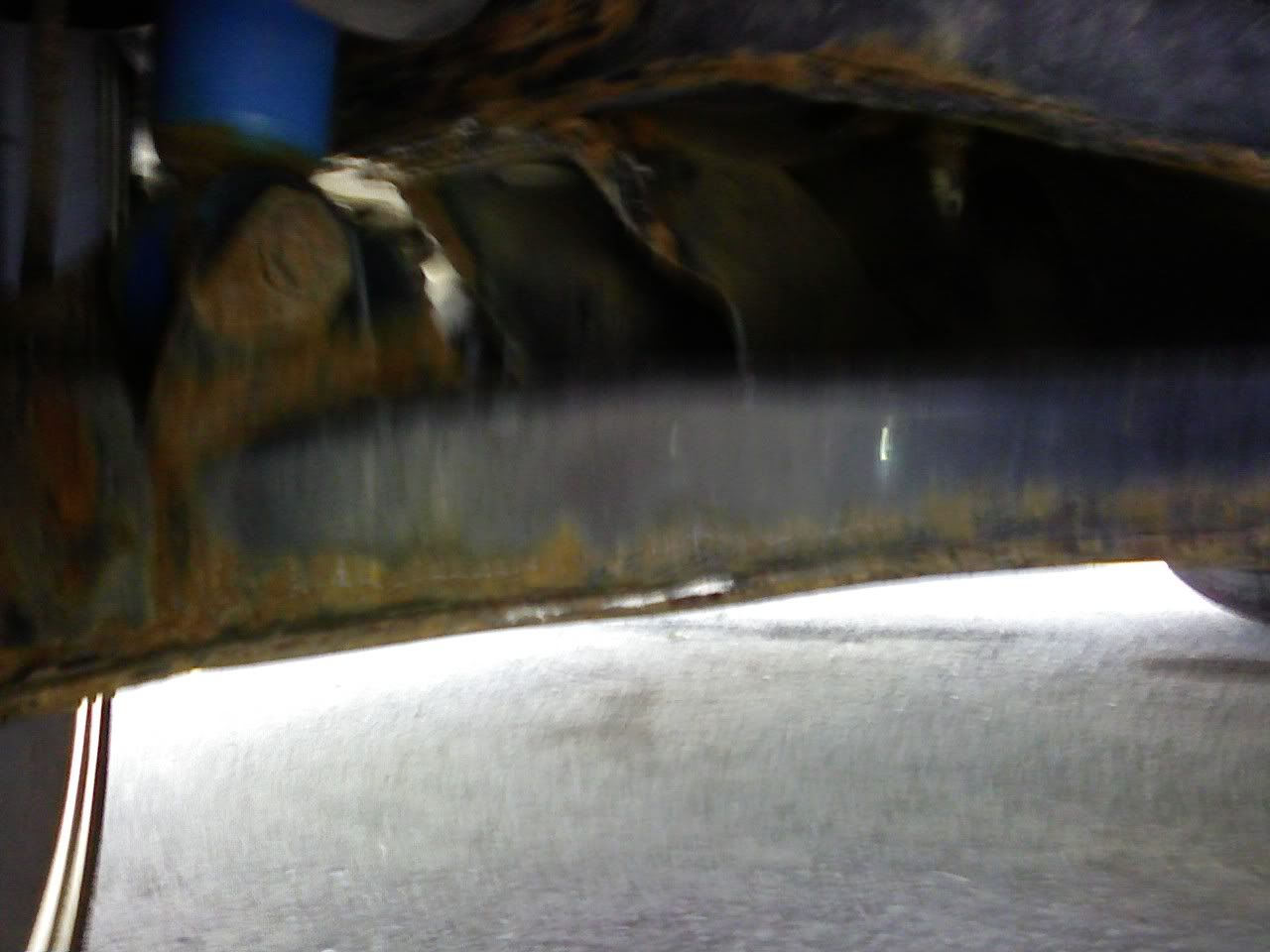

Note; my wheels rub at lock, so yours might as well with a +38 offset... BUT, I'll get you a pic of what it rubs on if I can (without taking off a wheel), loosely put, you may not have my rubbing problem with an 18" rim diameter. If you don't drift and don't spend much time in parking lots, you'll never have a real problem though.

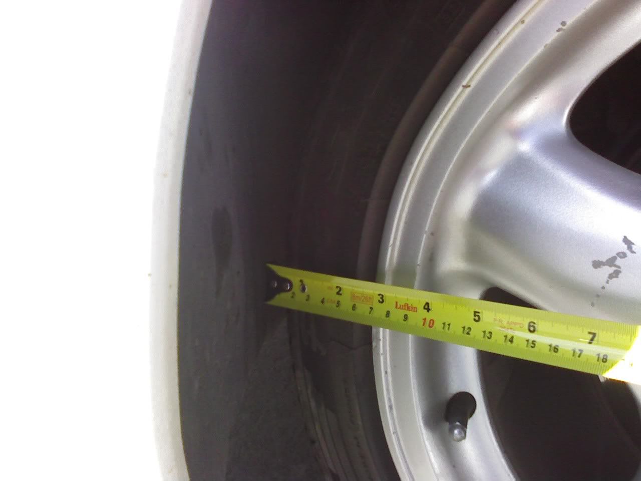

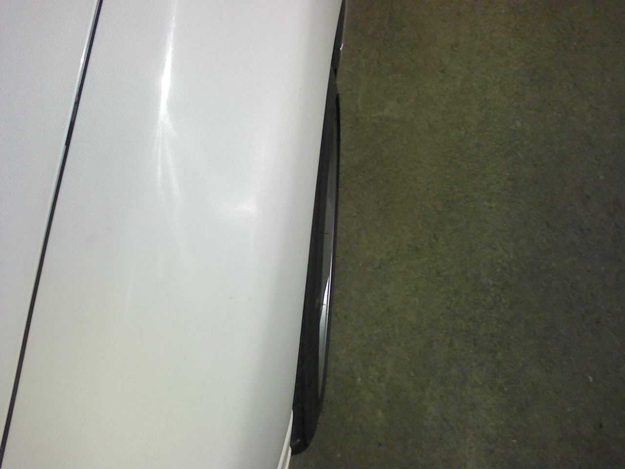

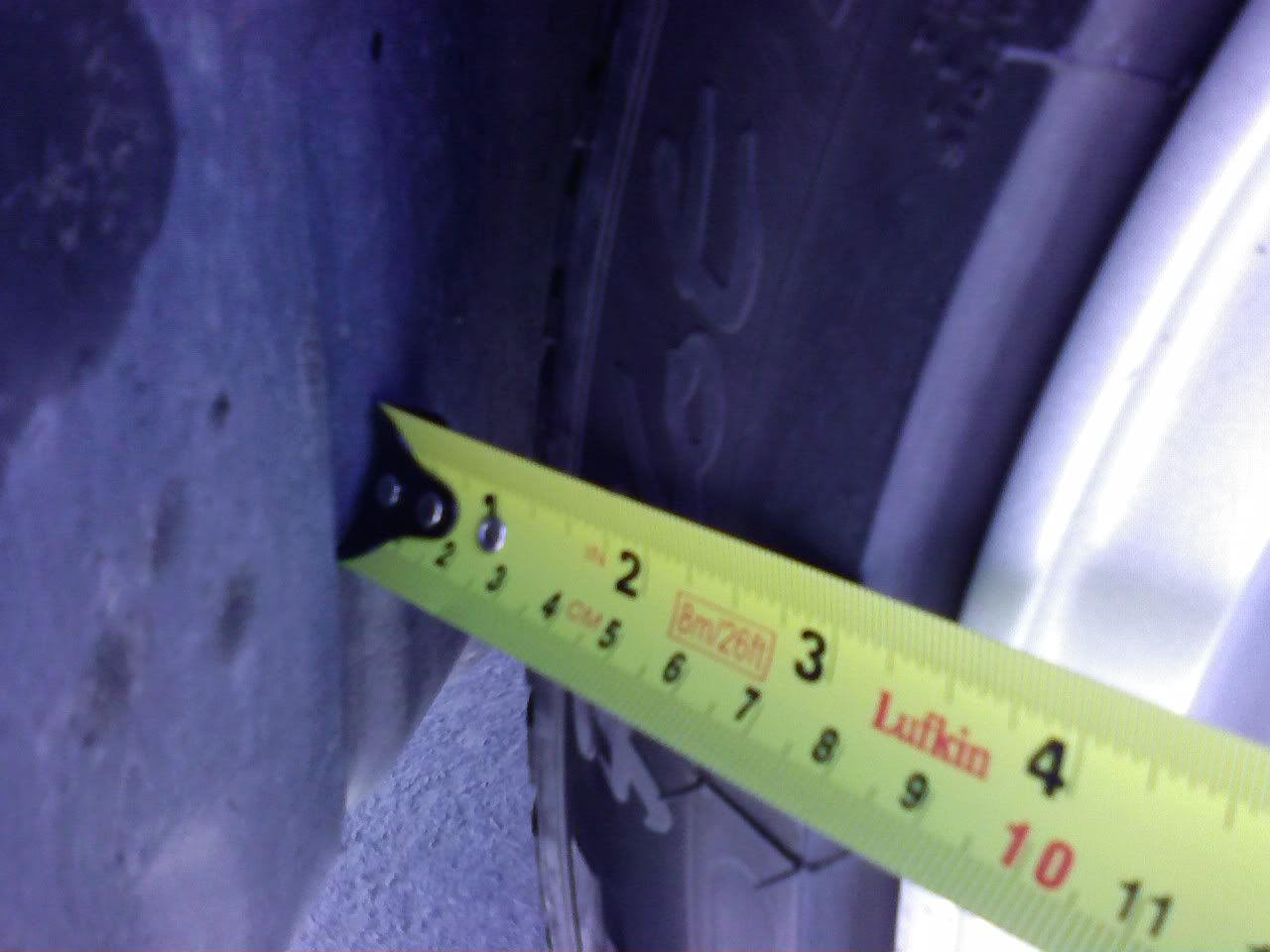

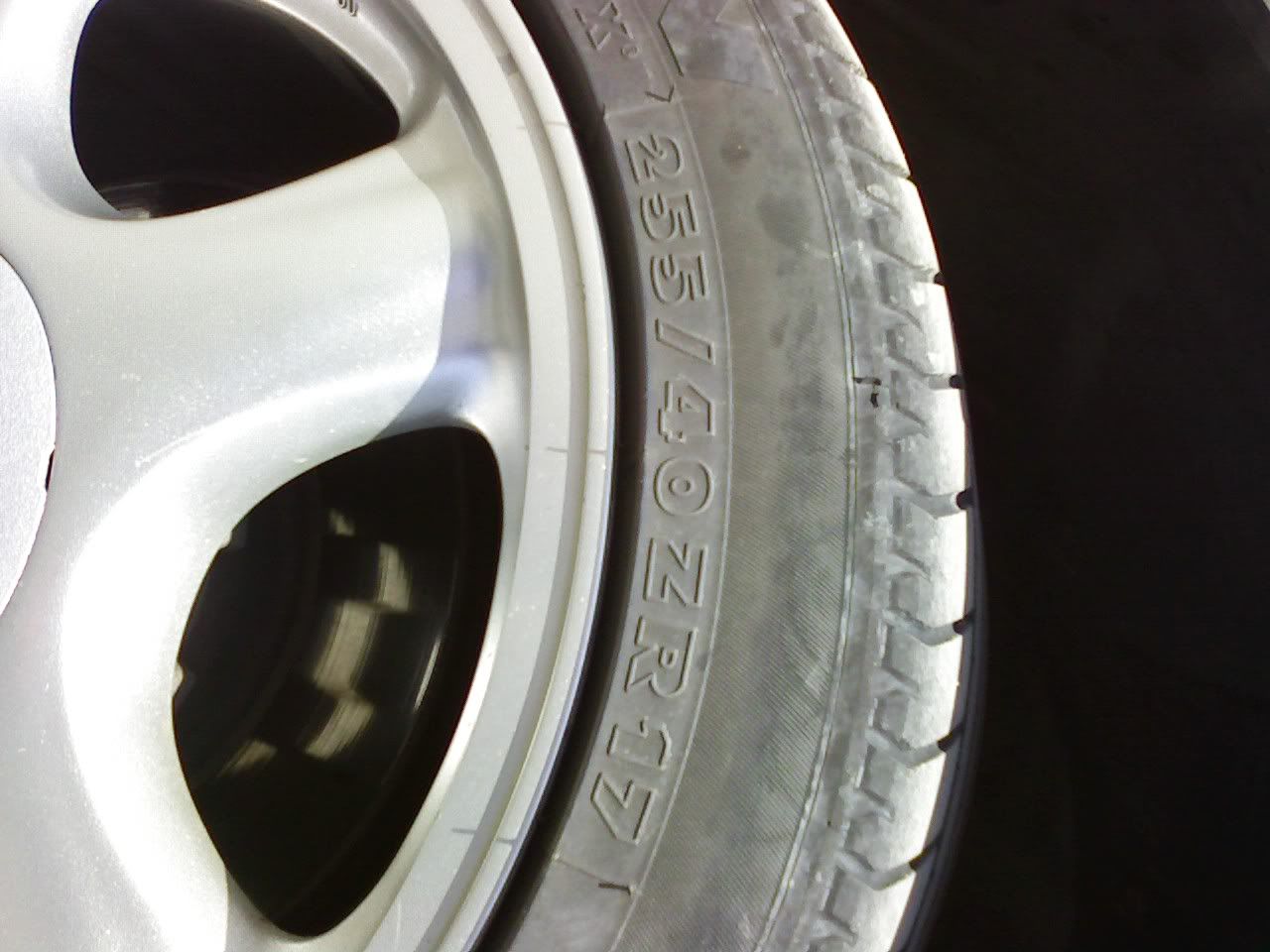

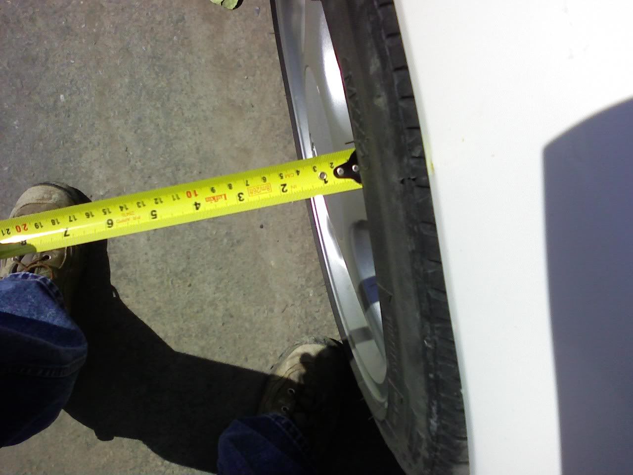

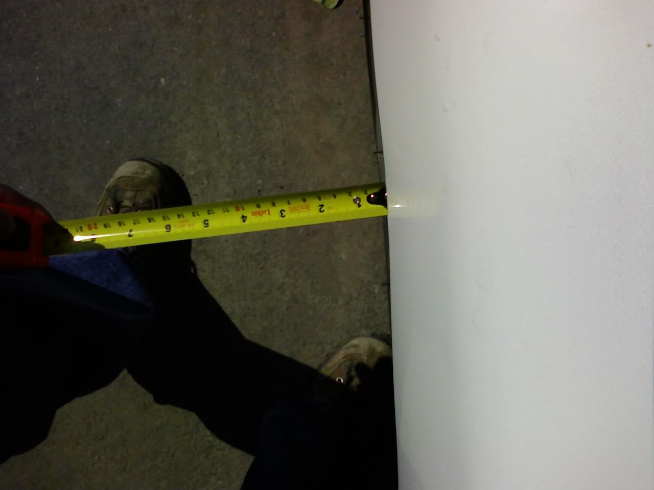

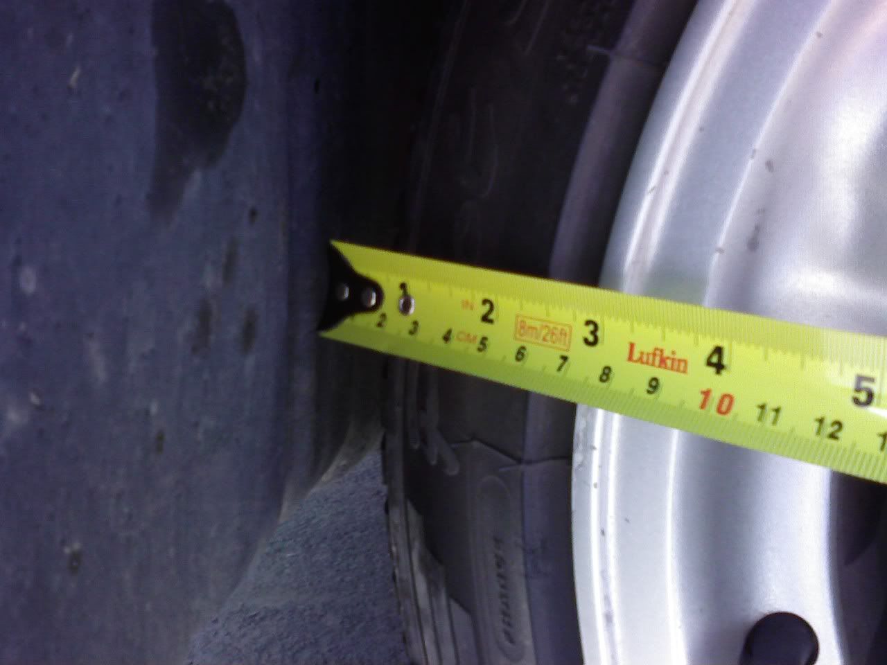

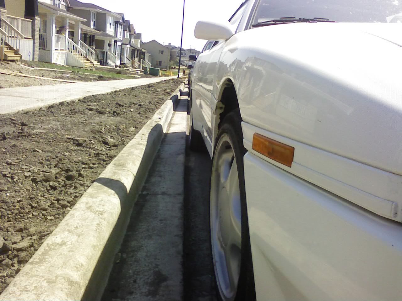

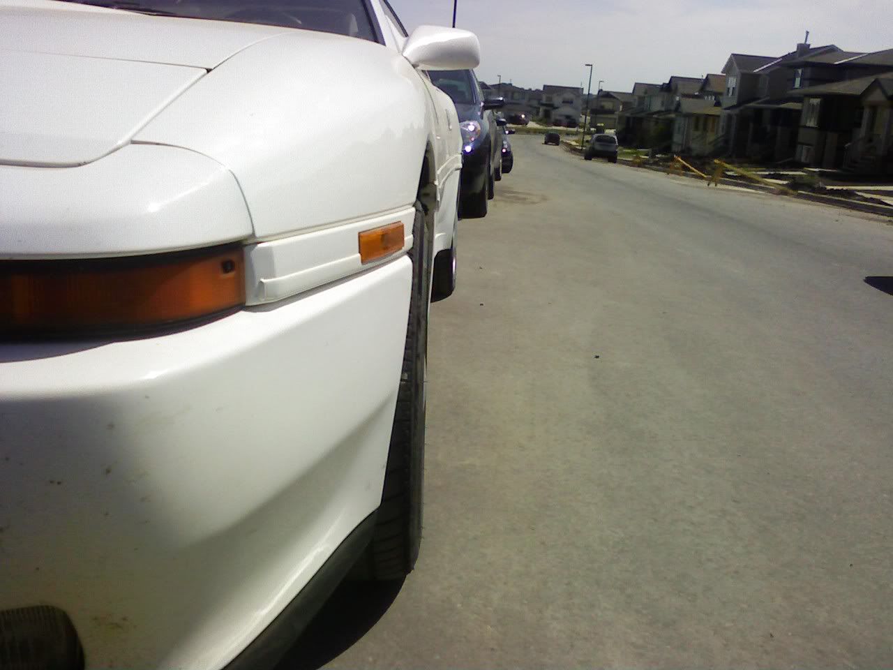

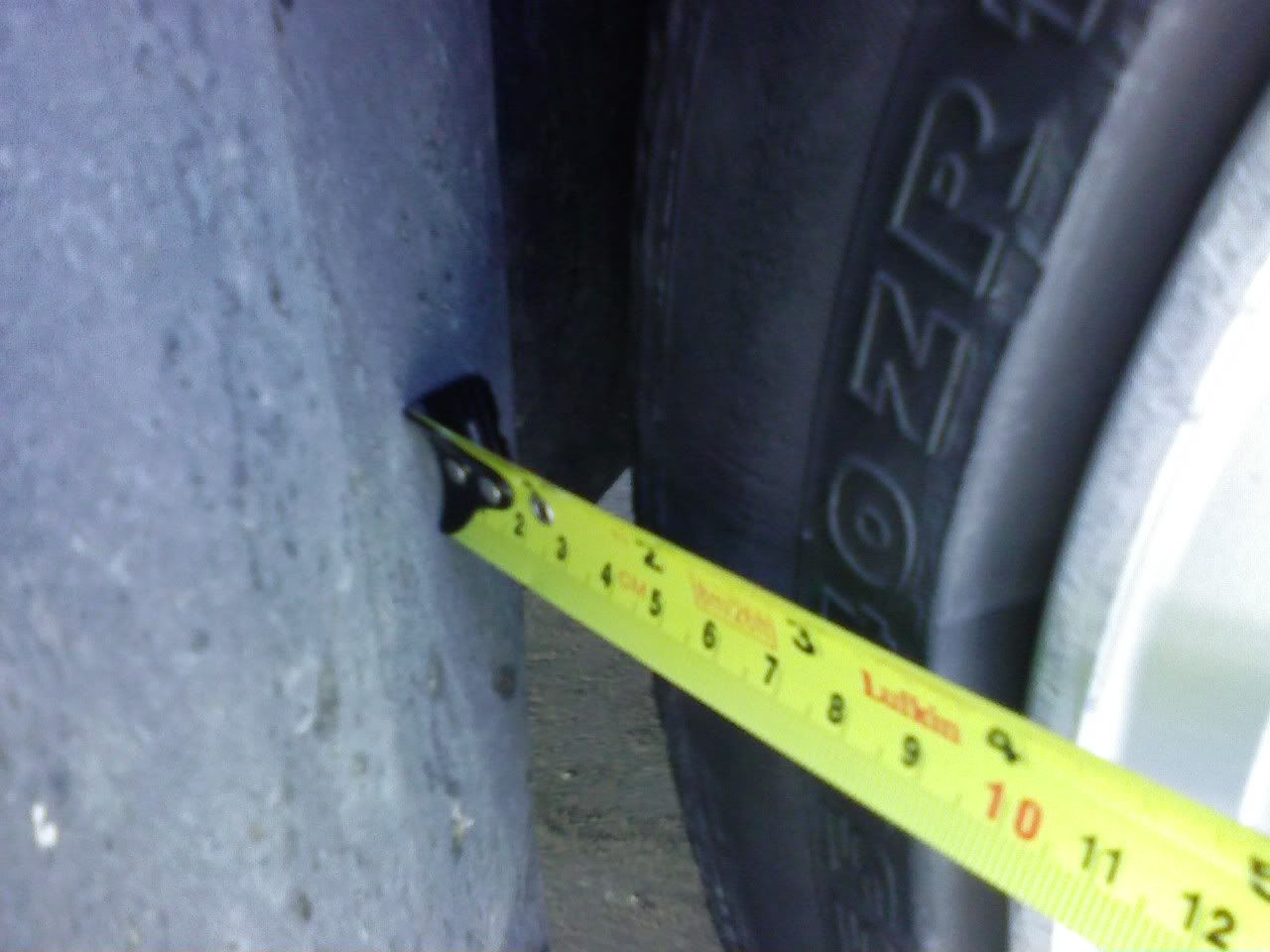

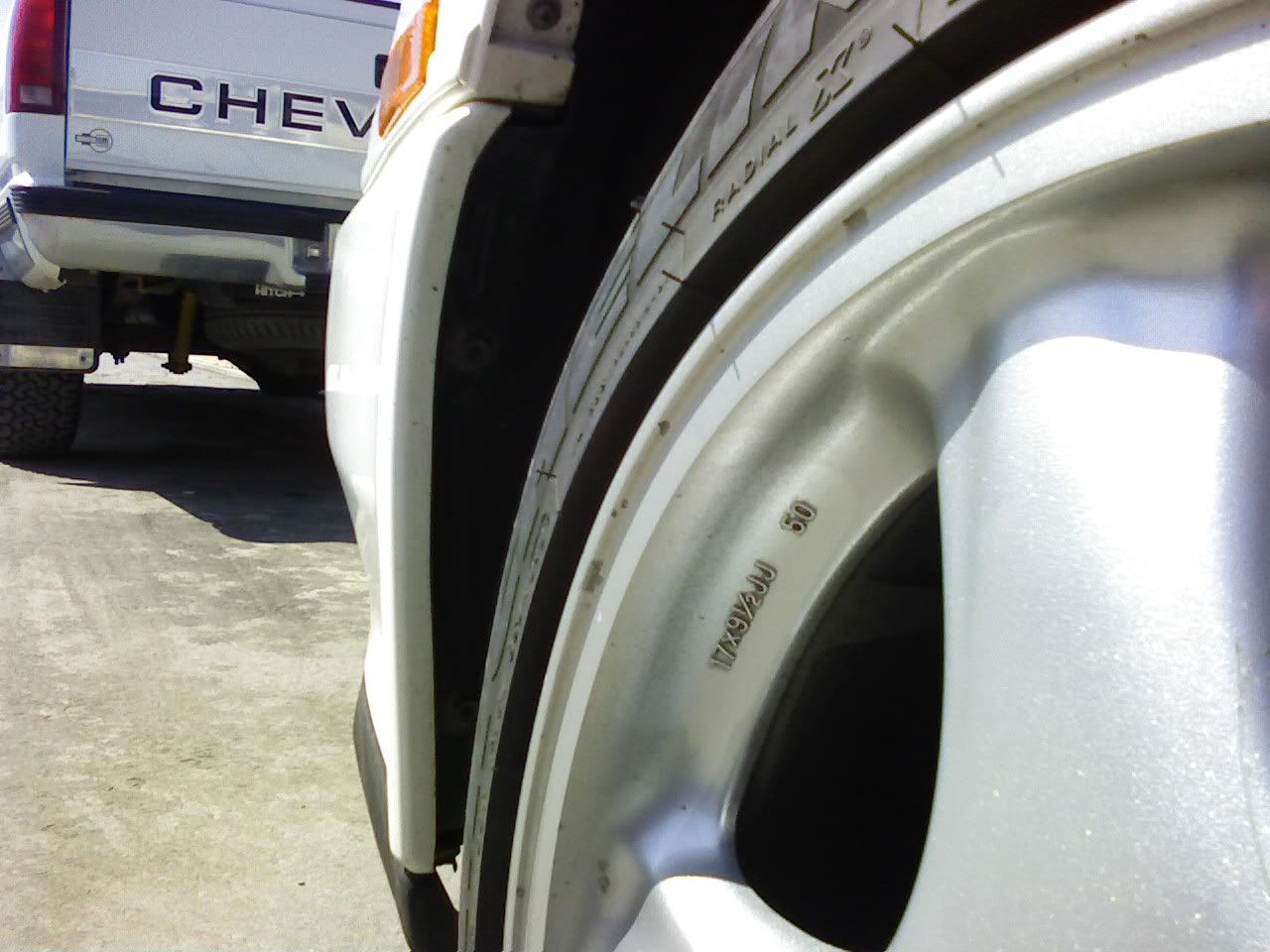

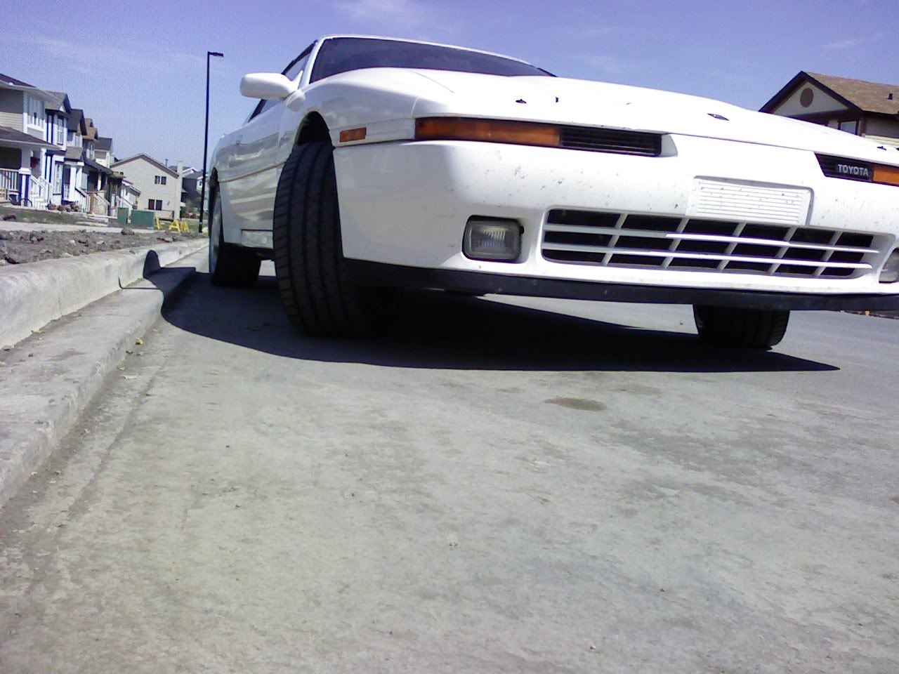

It's not often I get to help out around here, so I snapped a few more pics for ya. Hopefully these will clear up the mysteries of how wide of front rims we can mount without rolling fenders. I don't think my fenders are rolled, I certainly didn't roll them :biglaugh:
Rim size
Tire size
Looking down driver's side, tape is on the top edge of the rim, not the tire.
Same place, different angle
This is where my rims rub at/near full lock, this is shot from behind the driver's side front wheel, wheels turned right. Sorry about the blur, you wouldn't want me for a brain surgeon :biglaugh:
Phat rubber! This is turned over as far as I would go without wanting to grind... Still need to adjust the steering lock :nono:
Clearance shots, can't remember which is which, and I don't think it matters :icon_razz Taken with the steering wheel cranked as far over as I could get it in one direction.
If you wanna see something in specific, let me know. If you want to be able to crank the wheels to lock, I think 9" wide is as wide as you can go and not have a complete headache getting it to work. 9x18 +40ish offset I think would be perfect. for 9.5x18, I wouldn't want to go lower than +40 offset, I think that hitting a hard bump could cause the tire to nail the outside edge of the fender, especially on a lowered car. I don't know much about the limits of our suspension travel, but it sounds possible. +35 I think would leave too much wheel poking out and wasting real estate on the inside between the hub and the strut.
I make no claims to be an expert, but from what I just took pictures of, 9.5x18 +43 or +45 would more than likely work... you'd probably rub at or near lock, so be aware you will not be able to turn that sharp.

My volks are for a MKIV fitment and the front offset is +37mm and the rear offset is +44mm. the volks on a MKIV cause a 10" wide wheel with 295's to rub on a stock body due to the offset. it really looks hoss on a mk3 though. the combination of the stock rear mudflap and the sidewall shape make my car look like its all business from the rear and ive gotten LOTS of compliments on its appearance. heres a poor quality pic from my phone on the wrong resolution;
w/ the tire size, wheel width and offset, theres JUST enough sidewall visible past the profile of the car to get your attention.
