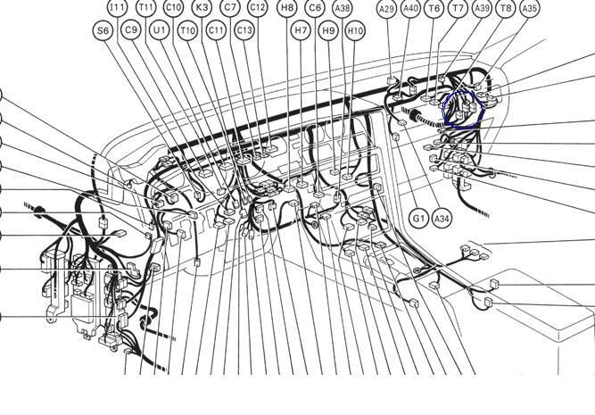

hvyman;1618249 said:
http://www.supras.nl/index.php?option=com_content&task=view&id=34&Itemid=50
There is another link in the 1j section stickys somewhere that 92 teal made for the pre so idk if that will help or not. Most of the wire colors are the same tho iirc.
looks like the answer was in there, just had to read it harder

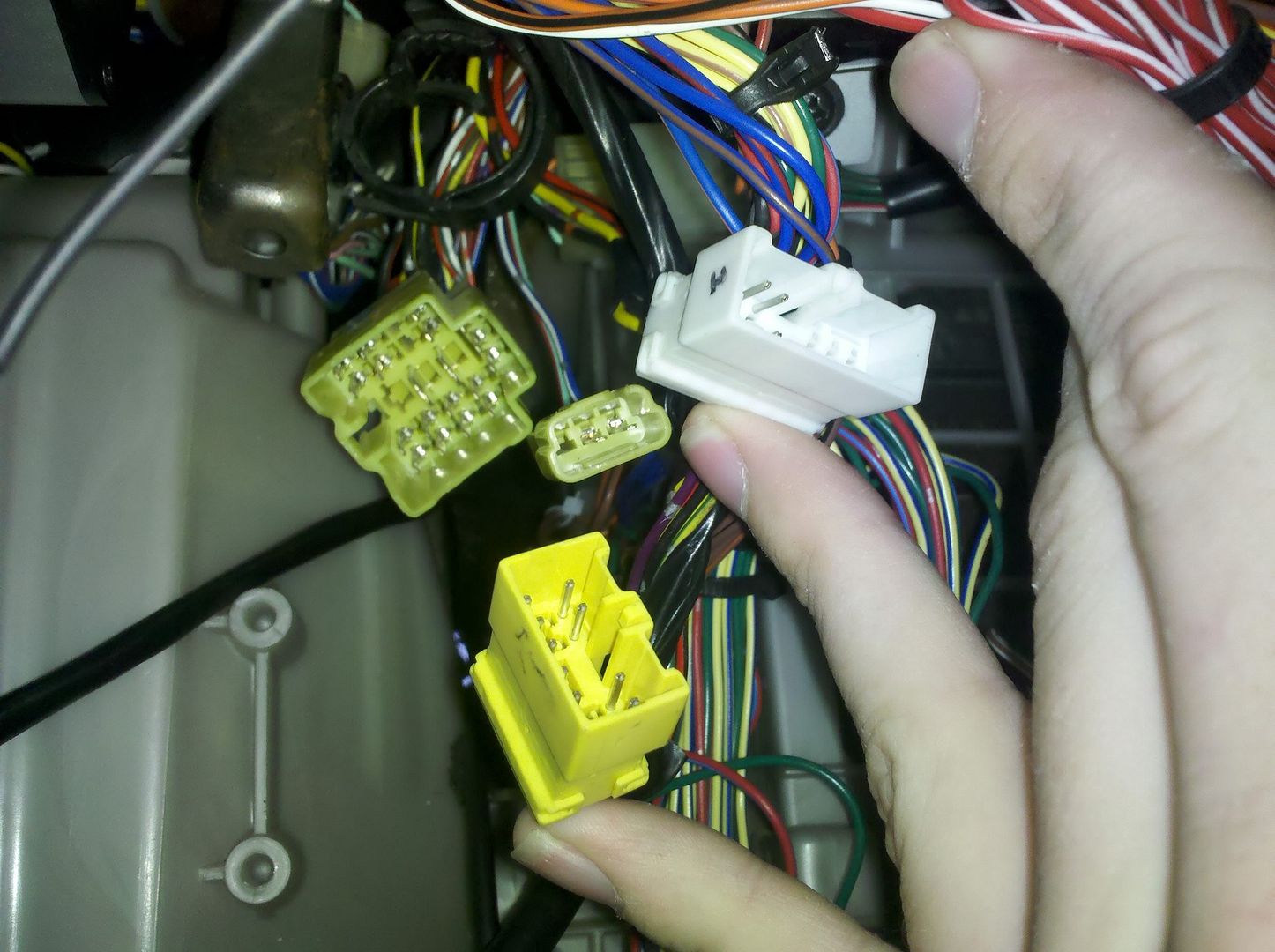

lol looks like its these guys
M1 - Located near the ECU behind the glove box. Handles most signals going to the combination meter
B1 - Located near the ECU behind the glove box. Handles mostly control signals
B2 - Located near the ECU behind the glove box. Handles mostly the ECT signals
B4 - A/C water temp switch
now i have some questions then, is my ABS going to work anymore due to using a stand alone? not a biggy im use driving boats with no A.B.S.
i also see that there is a Speed signal. most likely for the ABS, is this a good speed signal to use for a stand alone? or is it one of those special ones that the stand alone wont recognize.
