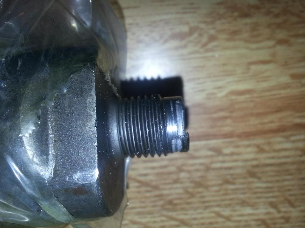

DeMoN2318 New Member May 24, 2012 572 0 0 Arizona May 1, 2014 #4 I tried spacers and striped my tie rod trying to torque it...exercise caution
atmperformance New Member Sep 17, 2013 757 0 0 San jose May 1, 2014 #5 that's a really short tie rod end.

DeMoN2318 New Member May 24, 2012 572 0 0 Arizona May 1, 2014 #8 atmperformance;2003725 said: that's a really short tie rod end. Click to expand... Stock replacements from MOOG
