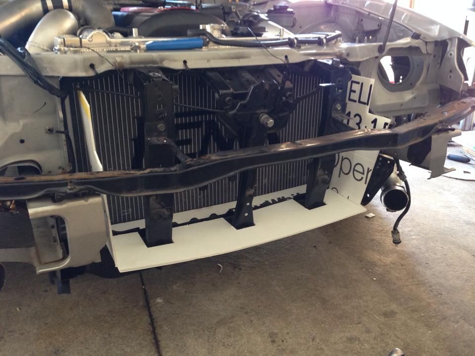

Took it out for a wee drive, keeps getting hot however. Stationary and in traffic it's 100% fine, but as soon as I go on the motorway, the temp just keeps creeping up
Tried to make up some rough ducting to see weather it would help the overheating issue, helped a little bit, but not enough to remedy the problem.
I've changed around the radiator setup (Was using R33 radiator + 2x 10" fans unshrouded) so I've put the bottom outlet on the opposite side, and got a shroud with 2x 12" fans, as well as an oil cooler to put in. Here is how it sits as of today.
