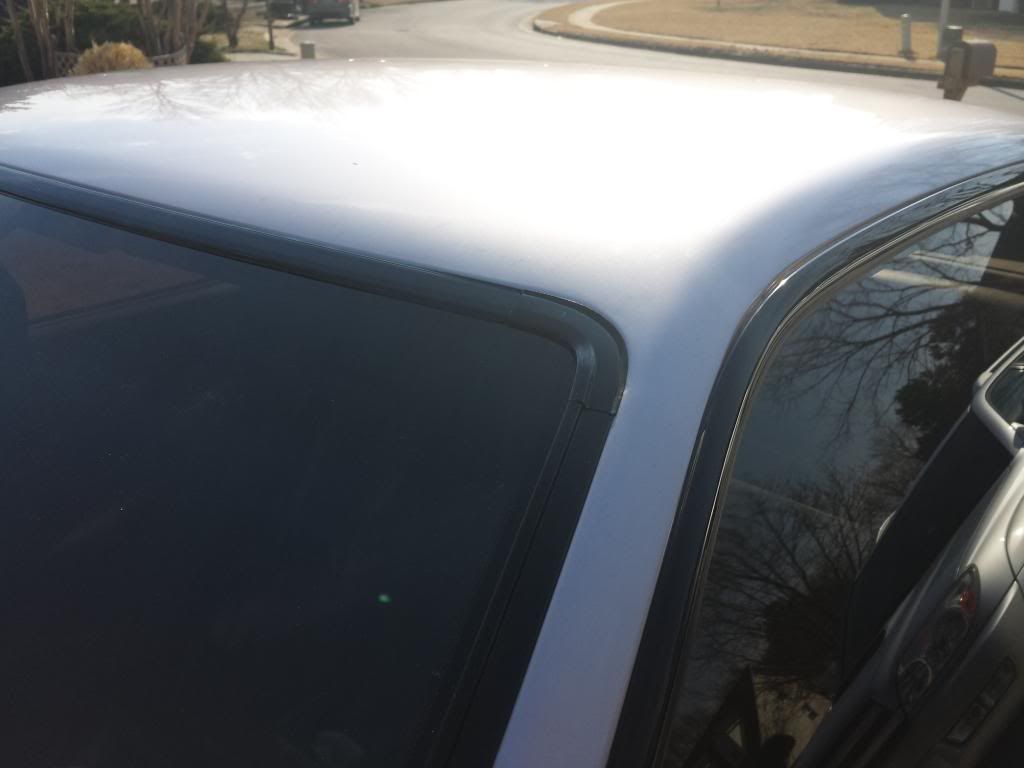

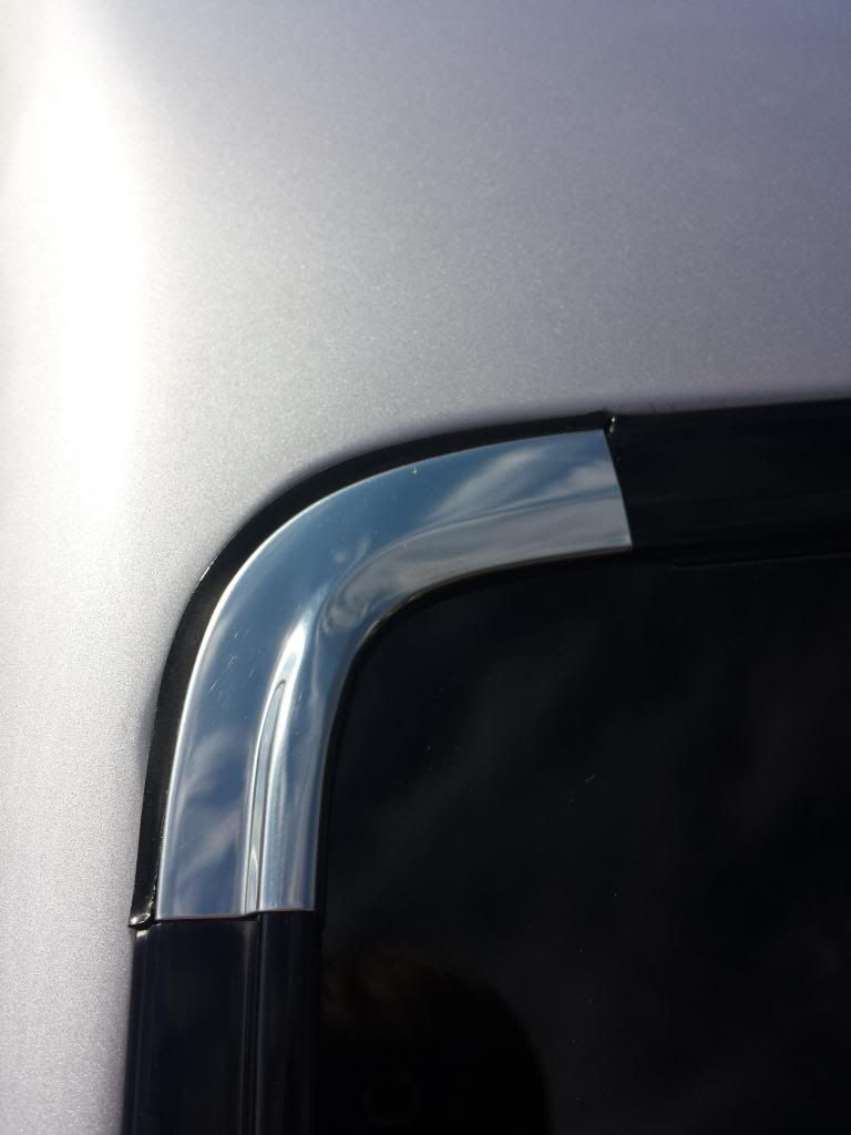

I didn't do anything big today, but I did vinyl wrap my windshield corner trim pieces. Ever since I realized that they were black from the factory and not silver it has bothered me because I pay attention to little details. I ordered some gloss black 3M vinyl wrap about two weeks ago and got around to it today. I basically cut a piece big enough to cover the whole piece and wrapped the surrounding trim and paint with masking tape. Then I slowly peeled the backing off the vinyl and applied it to the trim using a hair dryer to make the vinyl more pliable. Once I got all the corners worked and everything smoothed out I used an X-acto knife and cut off the excess. I think it came out pretty good. It has a factory appearance to it and matches the OEM trim perfectly.
Before: I'm sure all of you guys know what this looks like, for some reason it seems like all Supras have lost the black coating on these particular parts over the years no matter how well kept they were.
After:
