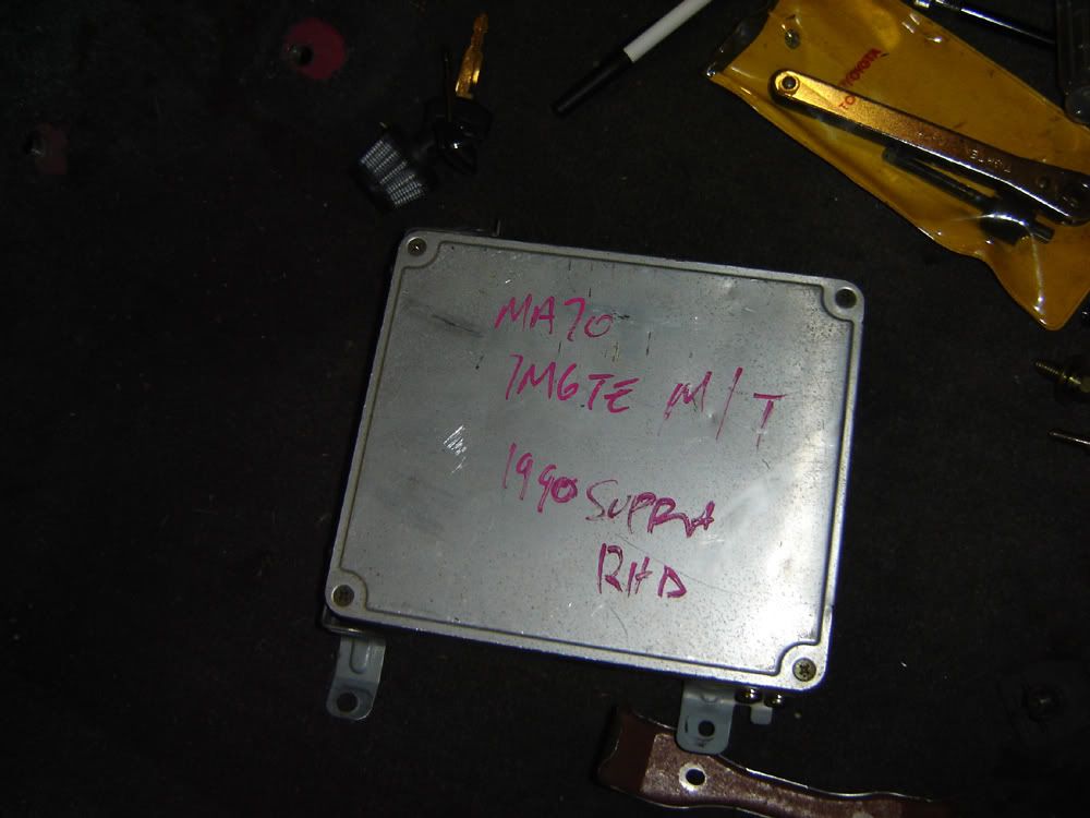

ok, so i have a JDM engine harness for a 90 7mgte, will this work on my non JDM 87 7mgte? i dont see the plugs for ignitors and such... also if anyone has pics of the stock engine w/ harness on it i'd appreciate it.

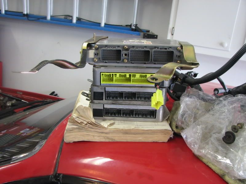

ignroe the top one thats from an aristo
next one down is a 87 manual turbo ECU
next one is a 90 turbo manual
next one is a 89 turbo auto
plugs get only more different from there :)

ok ill try to explain better.
i have a 7mgte from an 87, but its goin into my 89. both are 5 speed, the ECU is from a 90 7mgte 5 speed.

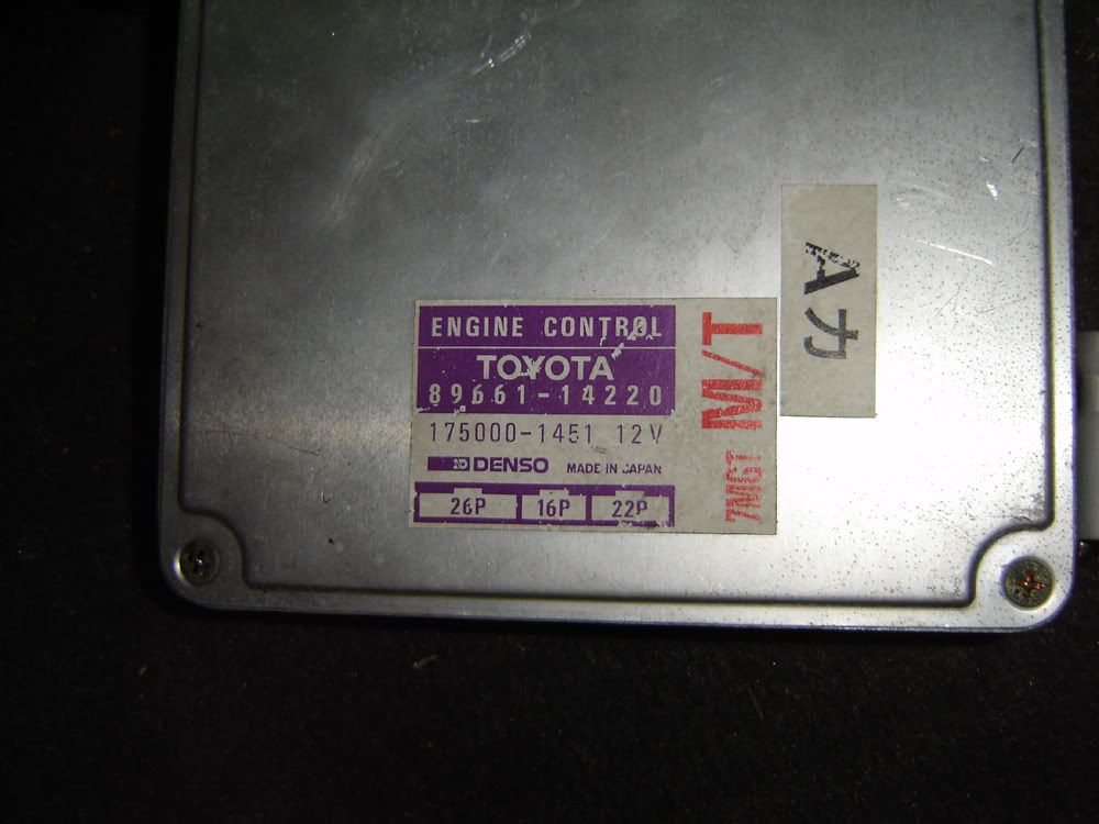

i have to swap stuff over? to the best of my knowledge this is basically a drop in affair. will i be able to use the ECU pictured as long as i get a usdm 89+ 5spd harness? what sensors do i need to swap?
could i just solder an extra foot of wire to the JDM harness and use that?
