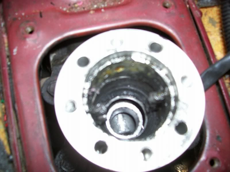

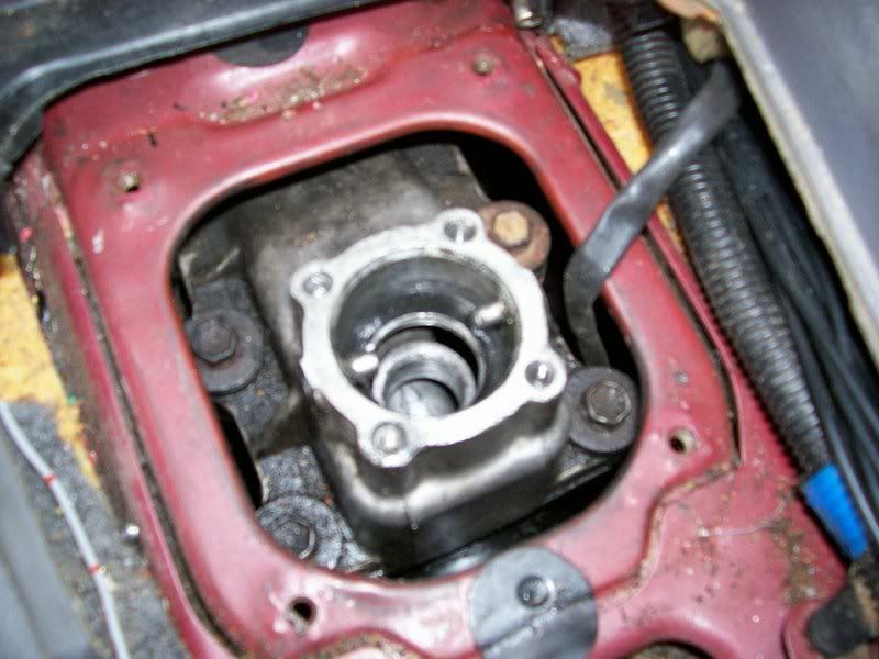

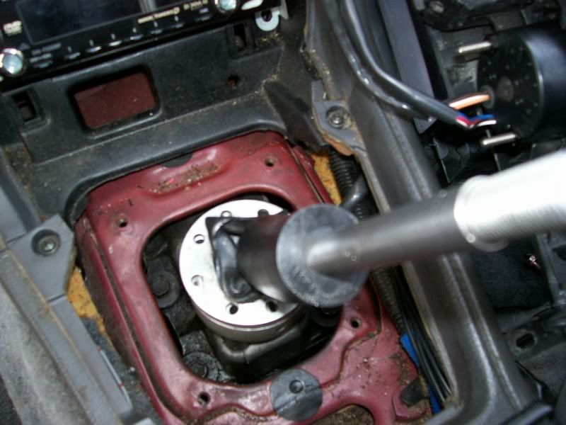

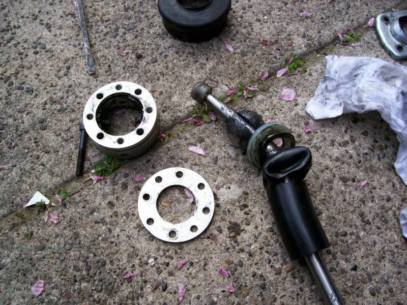

So i tried installing this shifter today...when i bolted it down it was stuck and didnt want to shift/move. it moved when it was loose though!? so my question is am i missing something? if so i probably left the other part in the junked car :( so what should i do!?
pics..
Please help!!
thanks,
-emp.

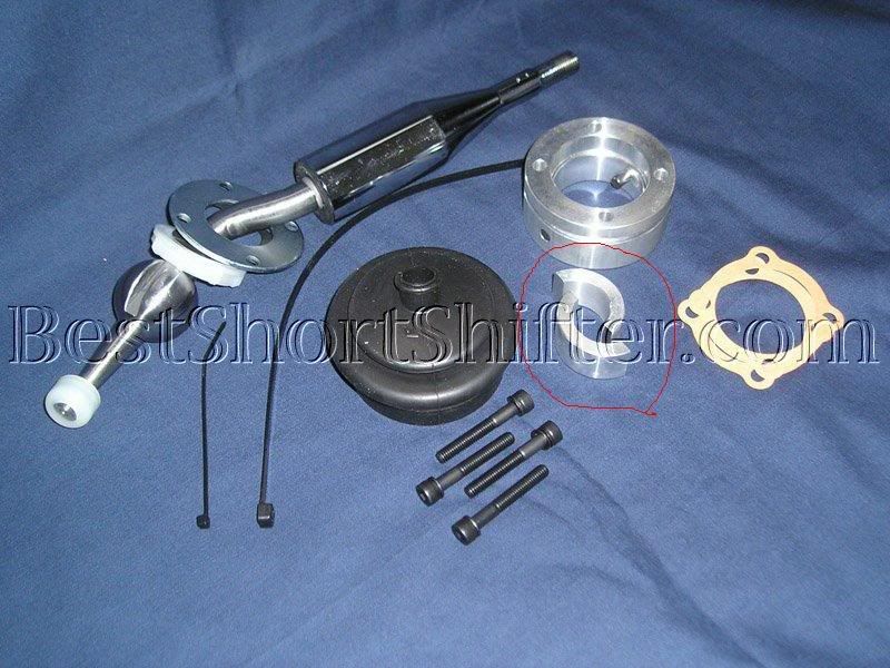

Try pulling up on the shifter and then try to shift. If it shifts, then the shifter is sliding down too far and catching on the lower set of pivot pins. I'm not sure how this shifter was designed, but the C's shifter come with two half-circle inserts that create a raised floor for the shifter to rest on. You pull out the black bushing at the bottom, drop the half-circle inserts in, put the black bushing on top of those, then put the shifter on top of them all.

ok so i have 1 spacer/insert i need the other and i tried c's short shifter to see if i can order one, they said no.
here's wat i need.
:1zhelp:
