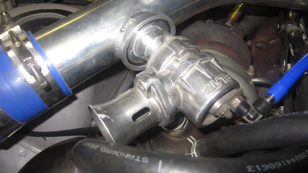

I absolutely love my Blitz, but if your running big boost 20psi+ get a Tial 50mm with the proper spring. The blitz works great though and sounds awesome!
Took a old HKS BOV that was broken and cut the flange off it, Tig welded the Blitz flange to that. Didn't have to change the flange on my intercooler pipe for it. Or you can just weld the flange to the intercooler pipe.
