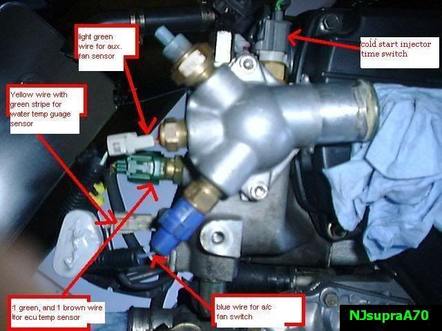

I put together a "basket case" 88 turbo. The car now runs and looks great, but it takes a long time to start when it is cold. I think that maybe I didn't get the sensor wire hooked up correctly. I am assuming that the sensor is one of many that are located on the gooseneck which contains the thermostat. Thanks for the help.

i80.photobucket.com
courtesy NJsupraA70
