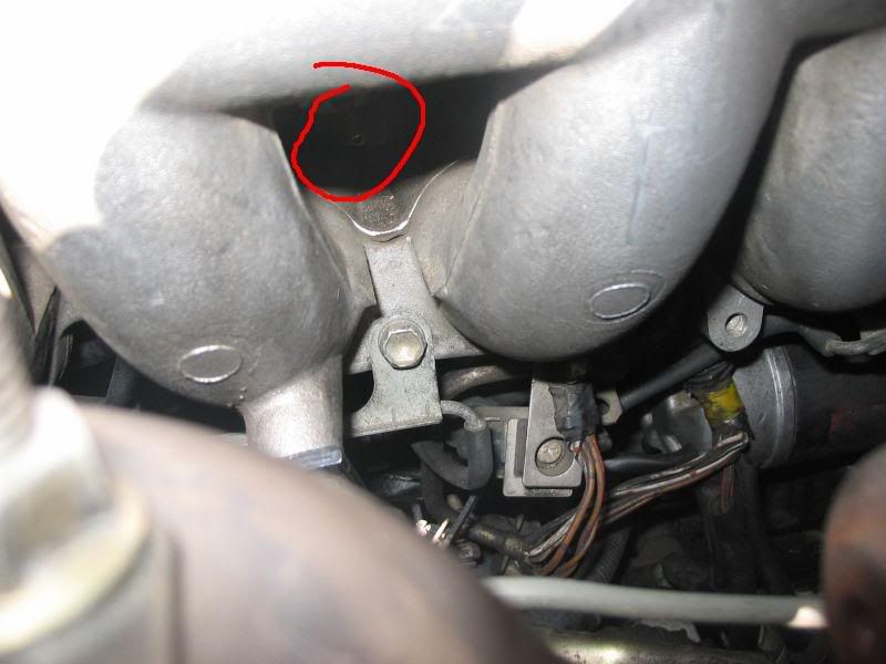

I think this is from the VSV. Its under the intake pennulum, beneath the Cold start injector. This is prolly whats causeing my idle problem eh?
I dont see where it goes on hte vac diagrams
Help por favor =P

cant tell for sure, but it looks like the VSV for the fuel pressure regulator. It goes to a metal pipe that then leads up to the FPR

I got that from the Cygnus site...there isn't a diagram for NA's...:(
And I am not sure how many they would have...I am guessing one for EGR, and one for Fuel Pressure, just like the GTE?? I am assuming that the ACIS valve lines go to a VSV...although they could run directly to the intake manifold somewhere...look at the second link on the last page.

Hah! Mine are easy to get too ;). The fools who did the headgasket changes on my supra before I owned it forgot to bolt the vsv's back onto the intake manifold, so they just hang there by the vacume hoses, lol.
