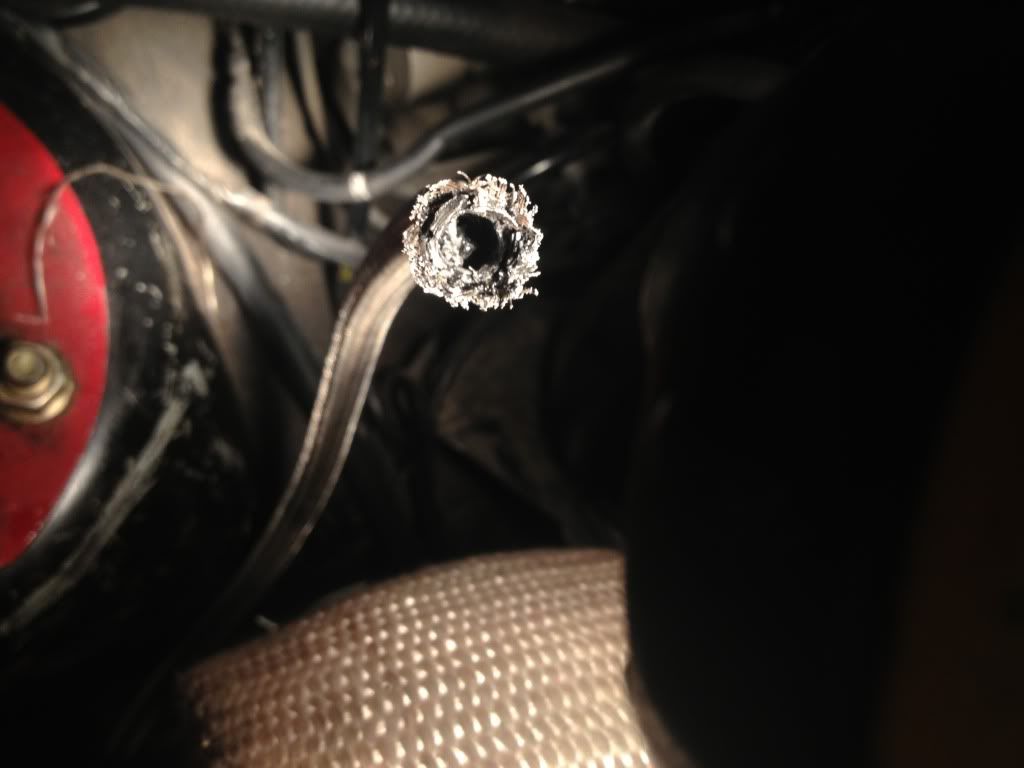

well the first line i used was one i made with standard braided hose. which lasted for a while. but when it failed i wanted to use something that i thought was better. so i ordered a custom length oil feed from apt. was suppose to be specifically for a turbo feed. but after taking it apart the hose they used was just standard rubber hose and hose ends.....:3d_frown:

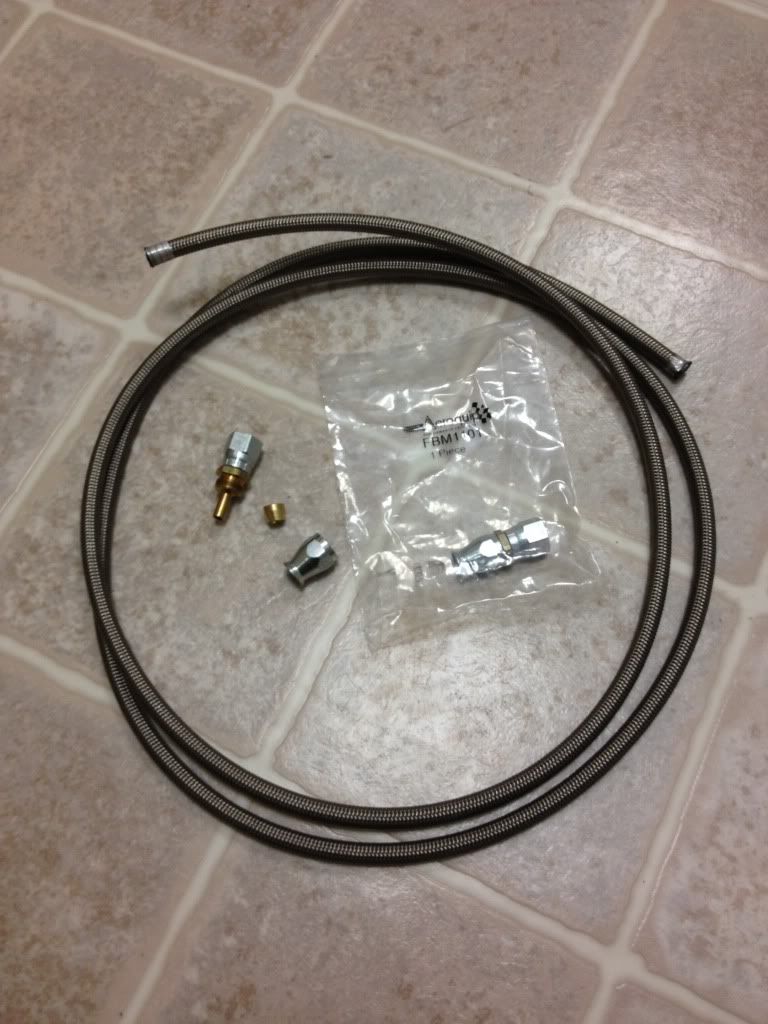

so i ended up ordering some aeroquip ptfe -4 hose and hose ends from summit. doing the ss hardline is to much of a pita. even though its the best solution cause it would get rid of the high heat that the hose and hose ends are seeing the way i have it now. but oh well hopefully this will be the last hose i have to get for this dam feed!

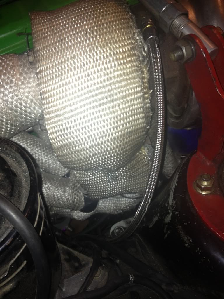

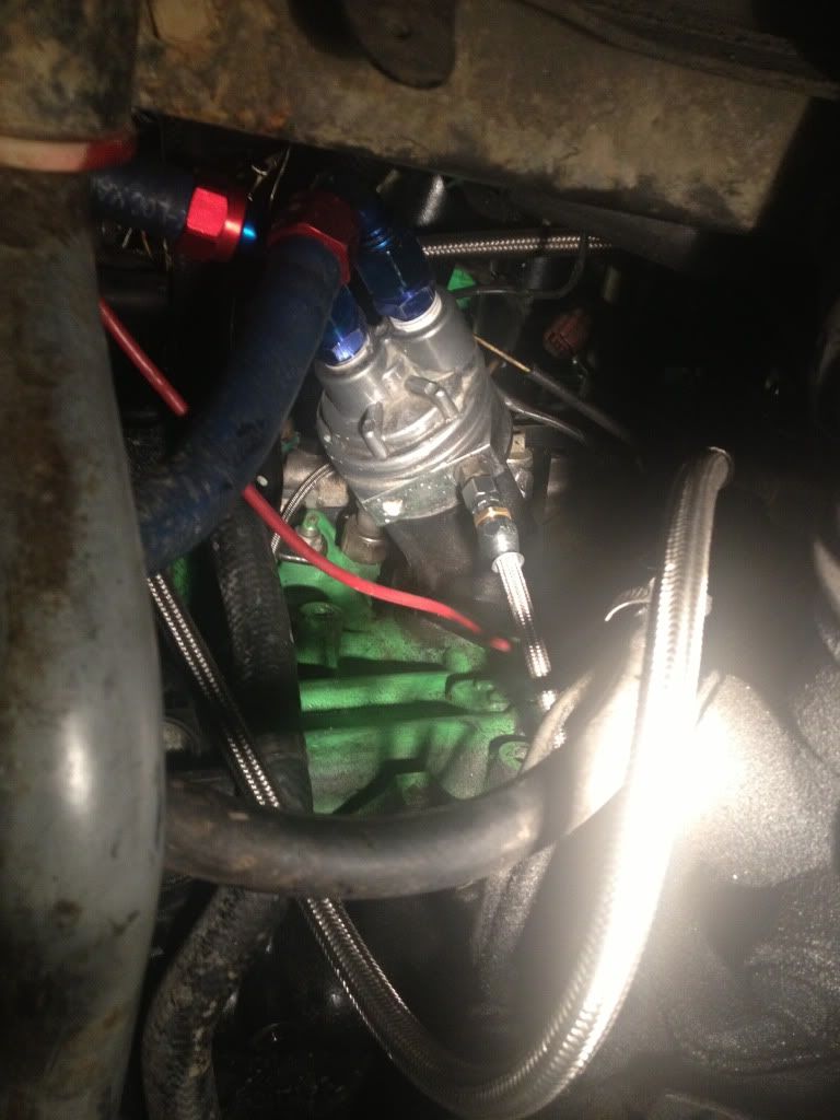

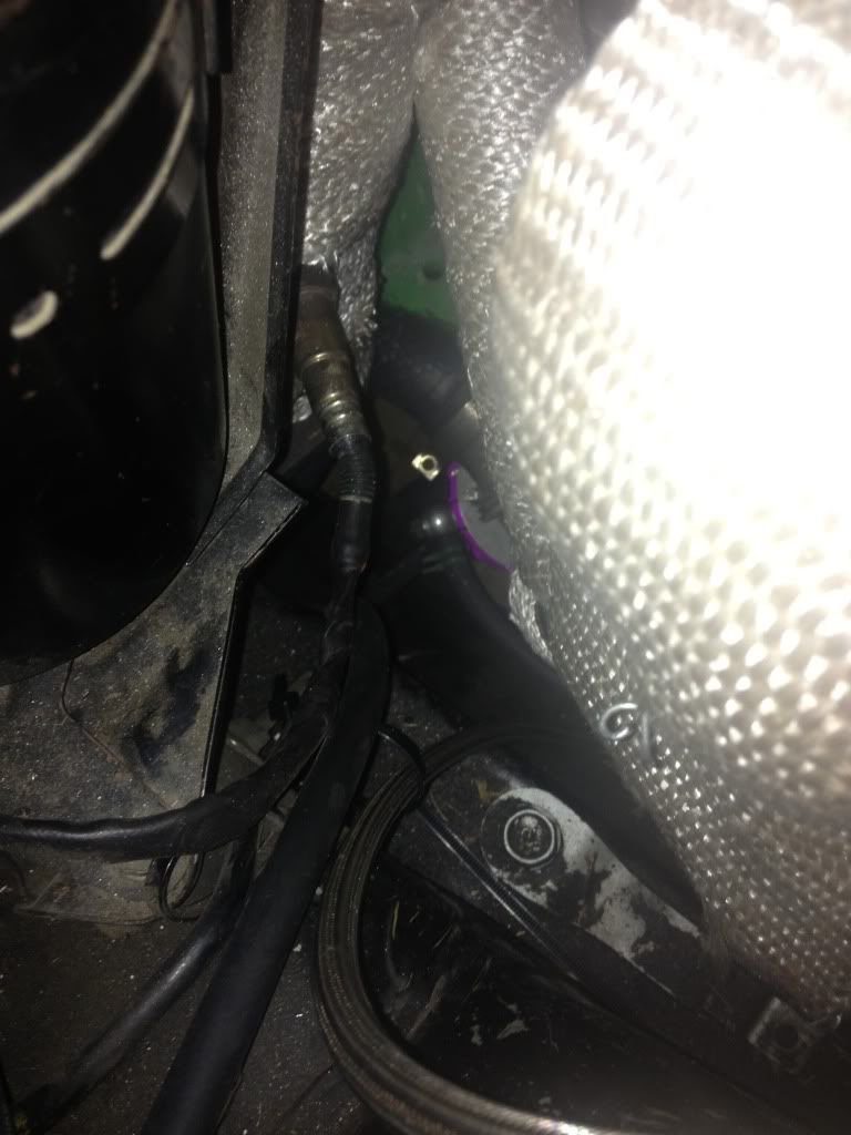

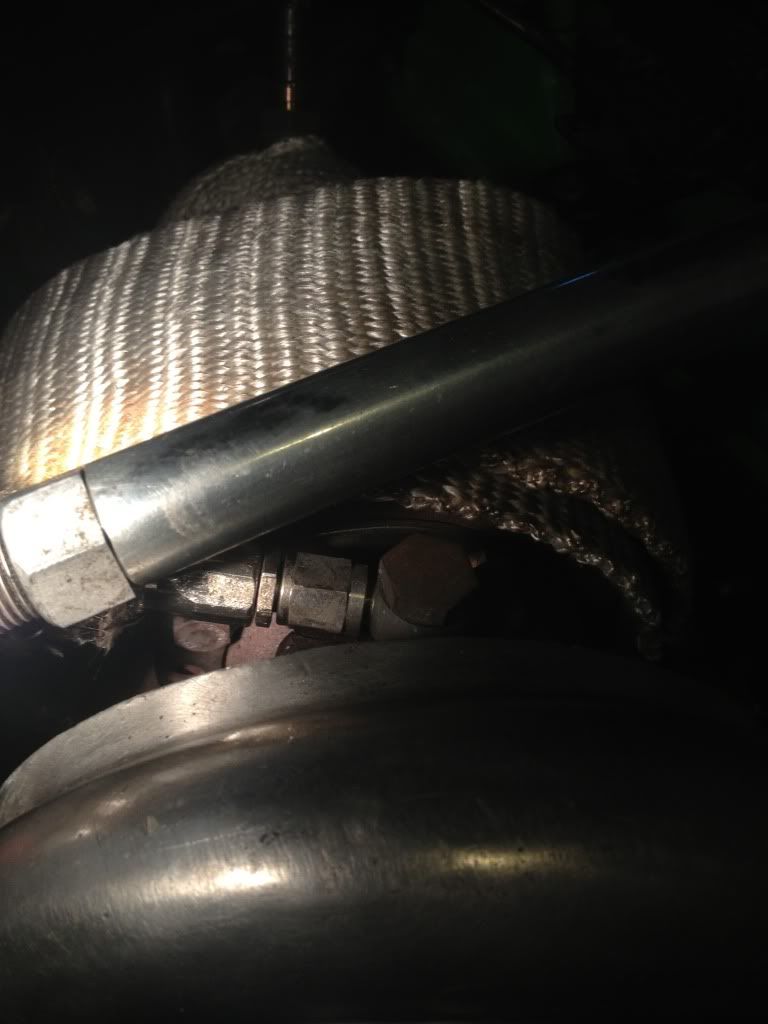

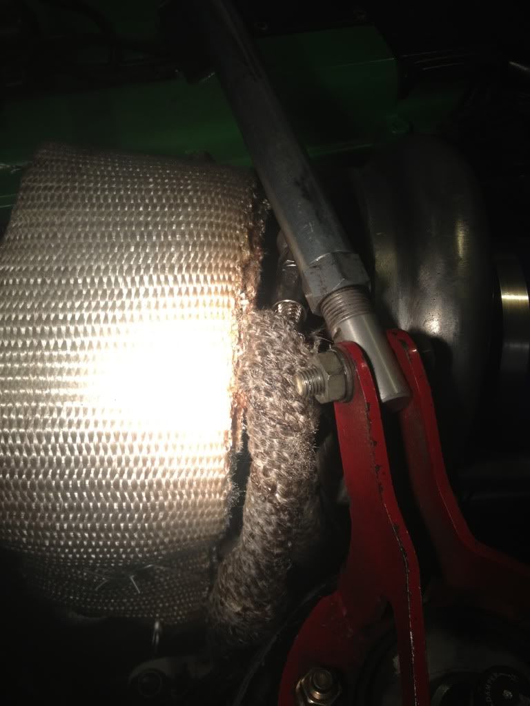

its on a na-t 2jz. i never said heat from the manifold is getting it to hot. i think its how i have a banjo bolt coming off the turbo which makes the hose end really close to the center section of the turbo heres some pics i took before i took it apart to show apt. im hoping the extra heat the ptfe hose can take will fix the issue. even though i think theres plenty of space for the line. its not touching anything and i had that heat wrap all the way up to the turbo. i autox, drag, track and run it hard on trips though so the turbo gets cooking. my setup up is built for reliability and this hose has been a biotch!

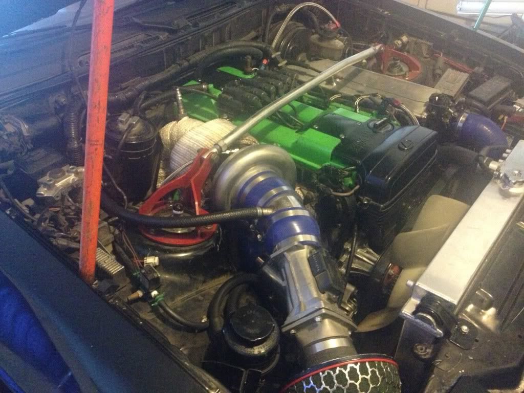

made the new oil feed line and installed it today. went pretty smooth. im not sure if i should heat wrap it or not. but other than that i think this should get it for good! :bigthumb:
and one of the engine bay for fun

what do you think about heat wraping the feed like i had it before? at first i thought it would help but the more i think about it the more unsure i am....it might just be trapping heat in that part of the line and hose end. i didn't wrap it cause im still up in the air on it. :dunno:
