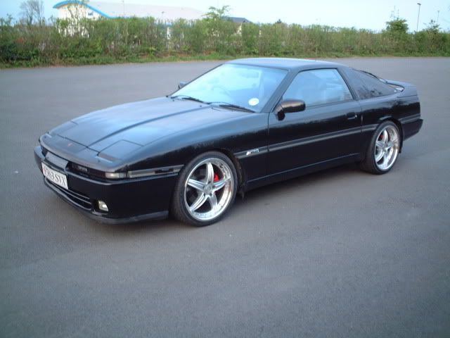

I have 19/8.5 and 19/10. I have cusco coilovers fitted also. No problems with rubbing.

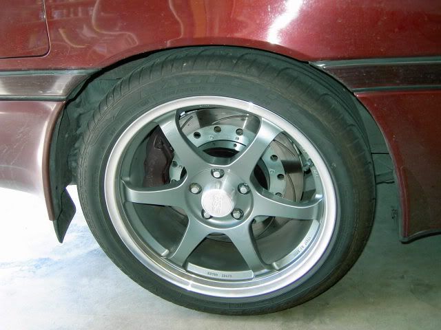

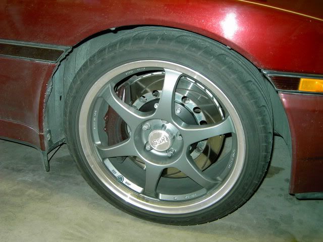

Adjuster
If your dealing with Tire Rack, you can get what they have for the MK4 TT fitment, it works fine on the MK3 too. (But they will tell you it does not... LOL)
That's where I got mine, and that's what they told me, and they are excellent wheels and tires.
18" SSR Comps, wider in the rear than the front, like they do for the MK4 TT.
255 front tires, and 285 rears. Fit is excellent with no rubbing.

^^^^Greg, those rims are taoight like a tiger! LOL! But your brakes are even more insane!:aigo: :love: The SSR Comps are so light too, definately purpose built!:icon_bigg Lowering the unsprung weight really does make a differance.:boink:
