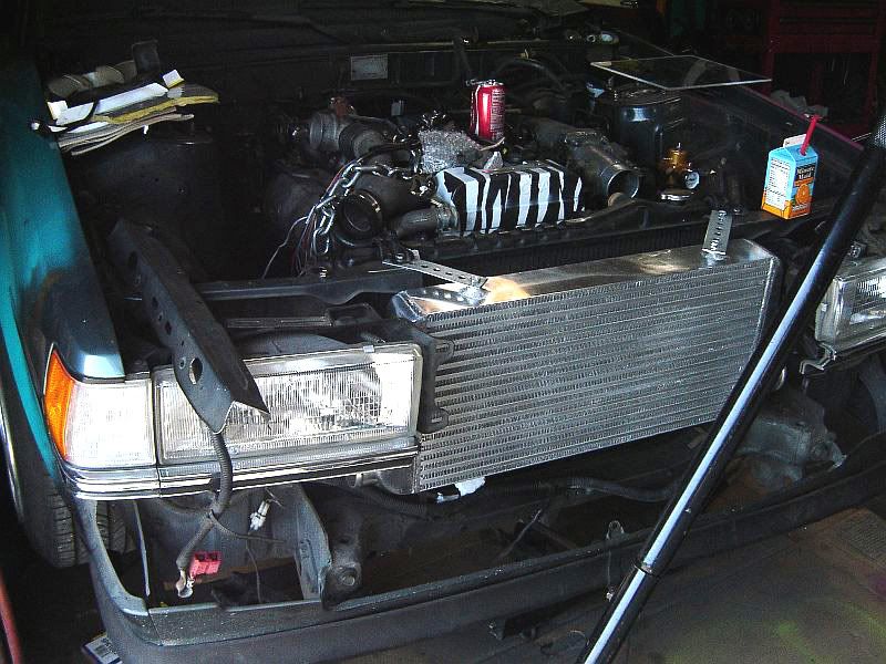

heres a pic while i was putting it together
