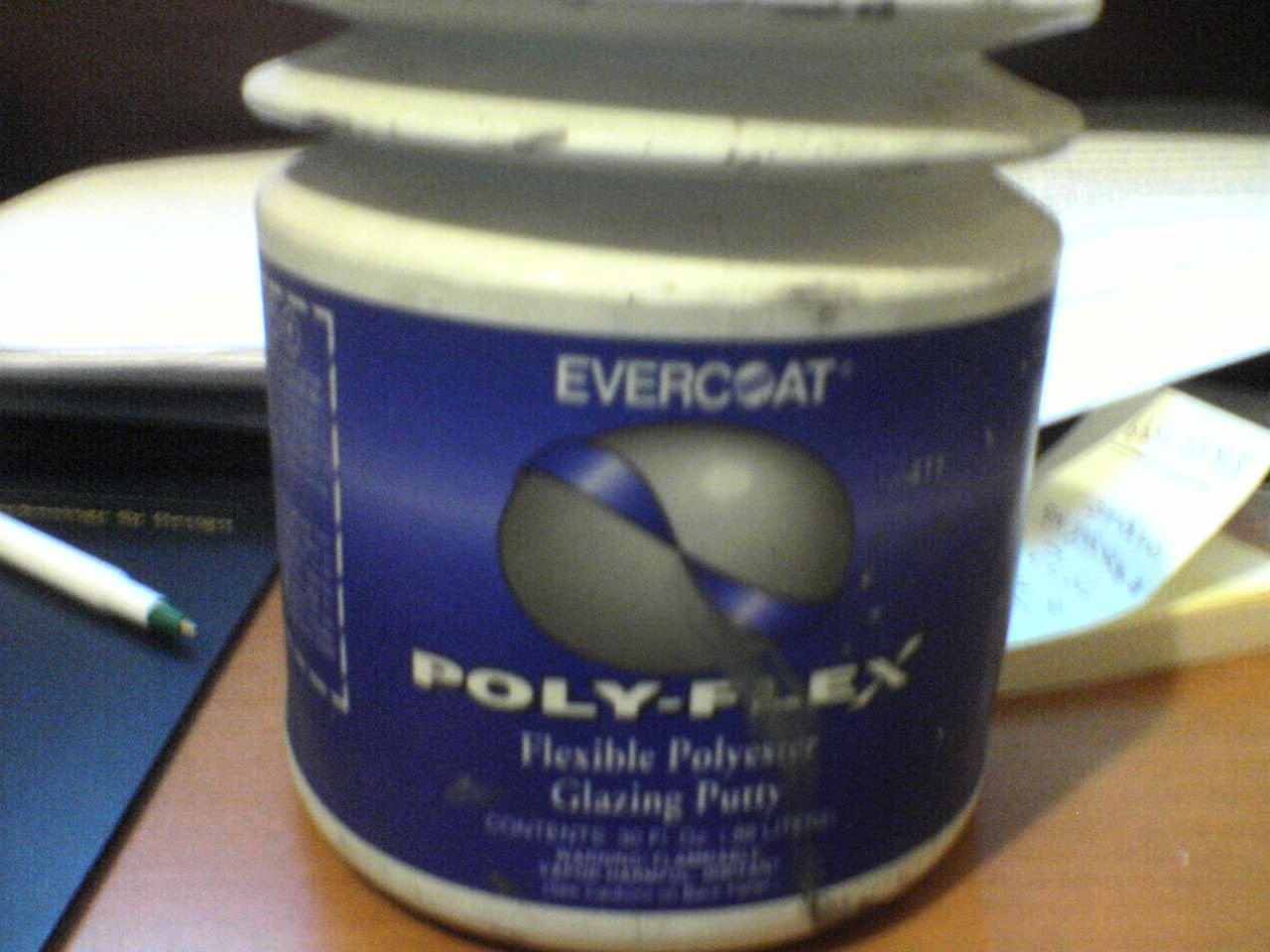

it is urethane. I cant remember what its called, but there are a few fillers that are designed for use on urethane I know that 3M makes one or atleast did. just check with any good local body shop and ask them where you can get some at.

The fiberflex and flex filler were made to work with all urethane. Trust me. You should find the video of the flexing the two pieces connected with fiberflex. Damn thing could nearly flex forever with no ill effects.

http://www.urethanesupply.com/Merch...ct_Code=5003R10&Category_Code=&Store_Code=URE - to fill in the big holes (doesn't sand that well)
Cover with http://www.urethanesupply.com/Merch...uct_Code=2000-C&Category_Code=&Store_Code=URE - will sand smooth
This is what I used on my nose when I removed the fins from the 89+ nose, shaved the nose emblem, and filled in the lic plate dimple. No problems yet and I have had this done since 2002.
