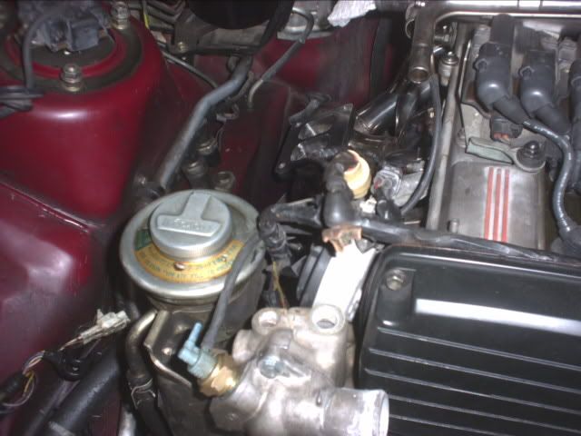

What is this???
88MK3
Dec 26, 2005
117
Phoenix,AZ
Sits on the top of the thermostat housing next to the timing cover.
It goes in the hole on the right

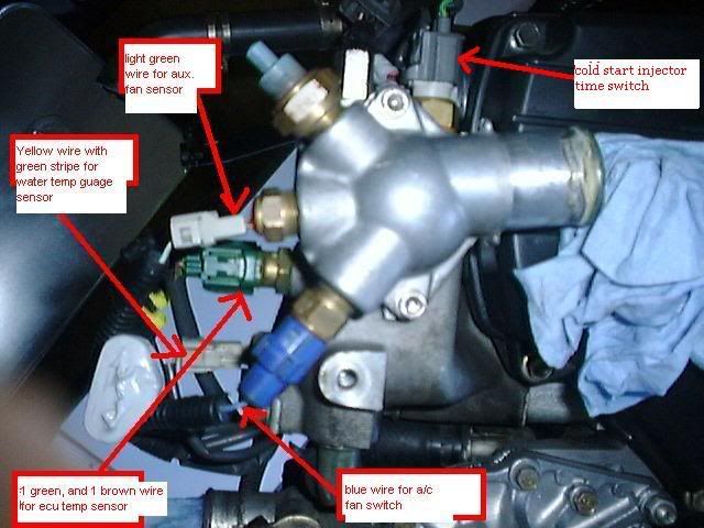

cold start injector time switch.
edit: see here-

Cool thanks. You can see the plastic connector on the sensor and wire fell apart when i bumped with my wrench

Where can i get a replacement? I work for autozone and i tried looking one up yesterday and couldnt find it
88MK3
Dec 26, 2005
117
Phoenix,AZ
Does anyone have a used cold start injector time switch that doesnt have a broken clip. Cause i called the stealership and they want $150 for it. Im also looking for a complete 7MGTE with an auto tranny speedo cable. Pm me with what you got??
