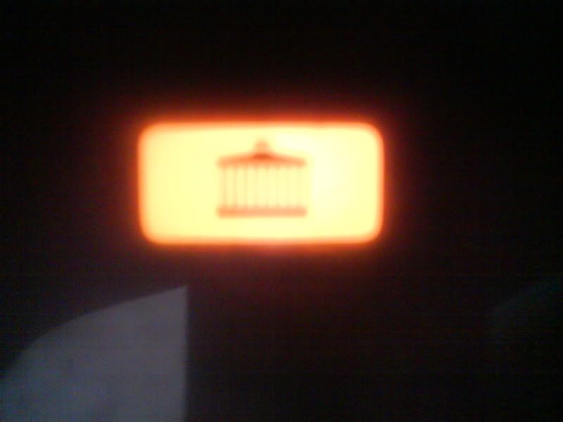

What is this light?

Just need a quick answer.

low coolant level light
check for leaks and check the overflow. most likely it is low or empty

Nah that's the Lincoln Memorial light.
Seriously though, what was Toyota thinking putting that cryptic thing on the dash. It sort of looks like a radiator...if you have a Rolls Royce.

lol i called toyota and asked what the bird cage lookin light was.they didnt understand me so i just left it go it went away after the 1st start up. 1jzgte swap

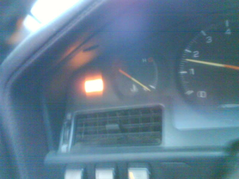

for some reason i couldnt find it in my repair manual lol.
ohwell but it is infact the coolant.. i checked it and it was low.. so i added some more and its gone..
