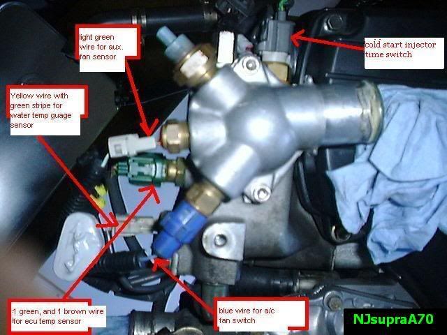

looks like your ac fan switch, but it's in the wrong location.. no matter.

suprasport91 said:
while were here what is the part # for the bvsv all i can find is the #23262
ugh i tried to find it for you again but since there isnt a full list no more (at least i cant fin it) its hard for me to get it form you. all i know it was something like 30 cdn from dealer or so(cdn funds+we get charged more typically for parts)

I just had the same wire break, I tossed the connector, went to AutoZone got a set of their smallest Audio Connectors, crimped one on and it fit perfect onto the sensor.

JMDigital said:
Ok. I knew this wire was going to eventually break. Can you tell me what its for. The car still works... what does it do?
I don't why your sensor for that is on top, it should be on the bottom as pictured in the other posts. Mine is also on the bottom, it shouldn't hurt anything having it on top right?
About a month after getting this car I stoped asking why stuff was in a strange place.. If that is the sensor for the 2 electric fans I can say even when that wire was not broken they did not work. The fans are good I tested them. So I have to extend that wire and hook it back up.
Thanks!
