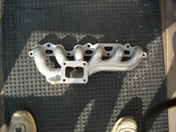

I sold this HKS one a while back, Just so you can compare.

Everybody complains about the turbo fitment problem that requires a spacer. It is not a design flaw. HKS designed that manifold to be used with an " on center" exhaust housing. If you use a tangental housing you will run into the problem of the compressor housing, If you use the proper housing you wont have a problem. It is just the opposite with the long runner HKS manifold. Also this version of the HKS mani was made for the MK2 supra, not the MK3.
