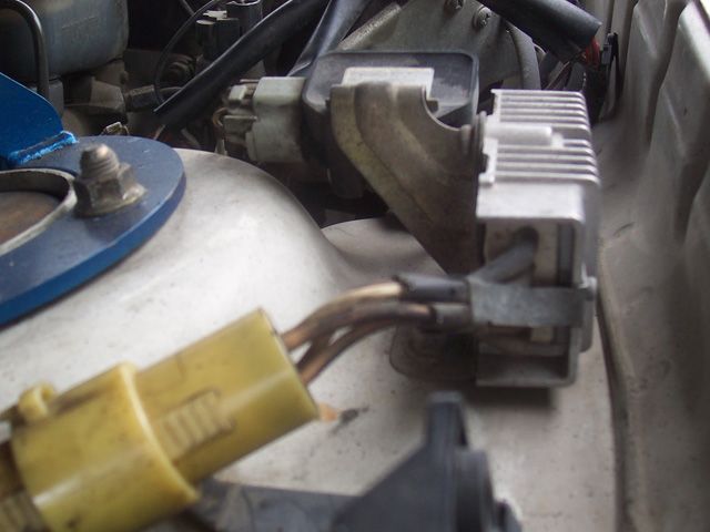

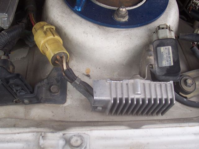

Very interesting Larry, so Larry says keeps it the way it is. Anyways this morning I went out to do the mod but there were 4 wires on the connecter not two so I got confused again. Here are a couple shots maybe from them you guys could say exactly what to do ;) maybe I am looking at the wrong thing? lol.
