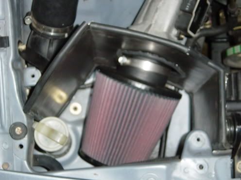

I made an airbox and put it in there
JBatt87T
Apr 28, 2005
102
Athens, GA
Just a sheet of stainless steel from Lowe's
Edit: Yeah it is much cooler in the box than it is outside of it.
DAMN Jimi87T that looks REALLY nice! Got any more pictoures of that bay?
