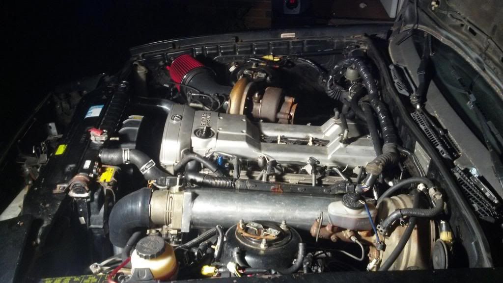

I have a Koyo rad and with my FFIM setup i cant fit the tiny A/C fan on the rad and clear the IC pipe. so i was going to put a pusher on the other side (10'' or so) then make a shroud for the mechanical fan to clear the IC pipe and use all of the rad surface area to funnel to the mechanical fan.
So what are some good quiet efficient pusher fans that are roughly 10'' to 11''?

this would just be used as A/C condensor fan.yes pushers are less efficient but its only for a/c. maybe ill make a shroud just for a puller and mechanical. the puller being the a/c just like stock. its just the stock one wont clear my ffim and IC pipe

hmmm. well a new toyota WP is already ordered. In the mean time I'm going to install the 2 core koyo rad and new toyota coolant. Also thought since the electric puller fan for a/c condensor wont fit with current setup that i would block off its opening in shroud and add a pusher fan. what are your thoughts on this?
http://www.summitracing.com/parts/hda-3680/overview/
I had already test fitted it. (local auto parts carries it) It didnt take much to fit. just bent the low side tube for a/c to make space on condensor for fan. i would wire it up to excisting condensor fan circuit seeing as the circuit has a 40amp fuse this 8amp fan will be fine.
There is only a fraction of space for the factory puller fan to operate (Was a 7mge-w58) so only one electric fan.
