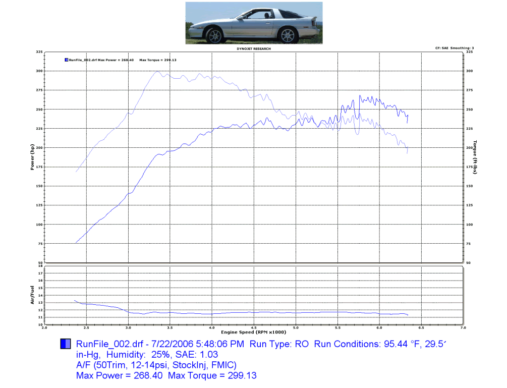

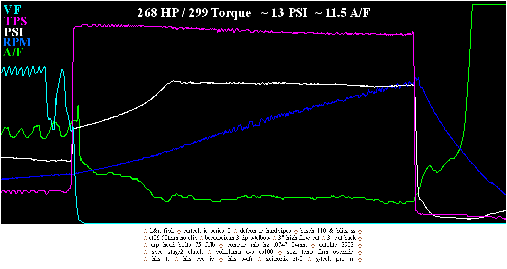

I am actually lucky this all occurred before and not on the dyno, and with plenty of time to correct it. My first run was at ~12.5psi and yielded 258hp. I upped the boost to ~13psi for my second run and gained 10hp to 268hp. Both runs had a beautifully level A/F line of ~11.5.
I was pleased with my results. Now on to my fuel mods and I should be over 300 to the wheels. Here is a shot of my wideband log. I will post the dyno graph when I receive them.

Dang, thats the crazy. Glad you fixed the problems and that is a sweet number to be making on the stock AFM and injectors. Good luck with the future mods!
