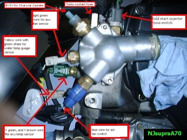

Check the wire that goes to the sensor on the thermostat housing it was making a bad connection on mine and just squeezed it closed a little.

and just in case you're not sure which one it is:

I think I found the problem. There is a a wire disconnected from a (brown I think) clip that's attached to the therm. I'll try to get a picture of what I'm talking about up later for clarification
