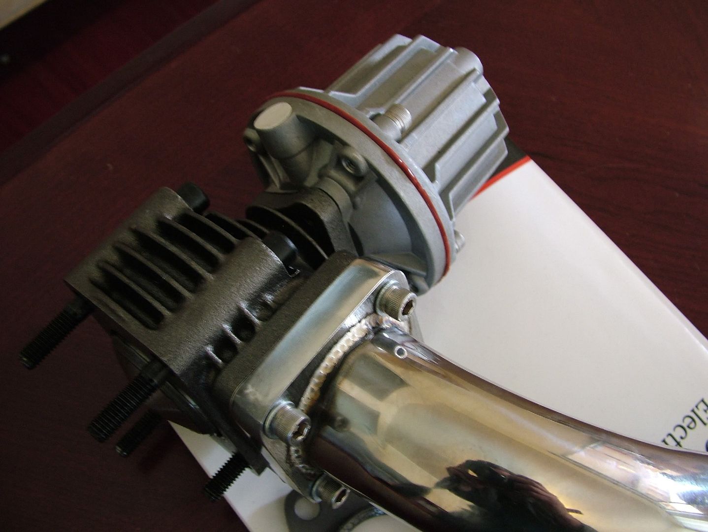

well right nwo i am have bean dacing between waste gates liek crazy
so this is what i might think is good size for my pte 67 p trim
they recomnd at hpf 44 mill gate
i was think on runing a 40 mill
but i might bebable to get this 46 mill for pretty cheep plus it's tail

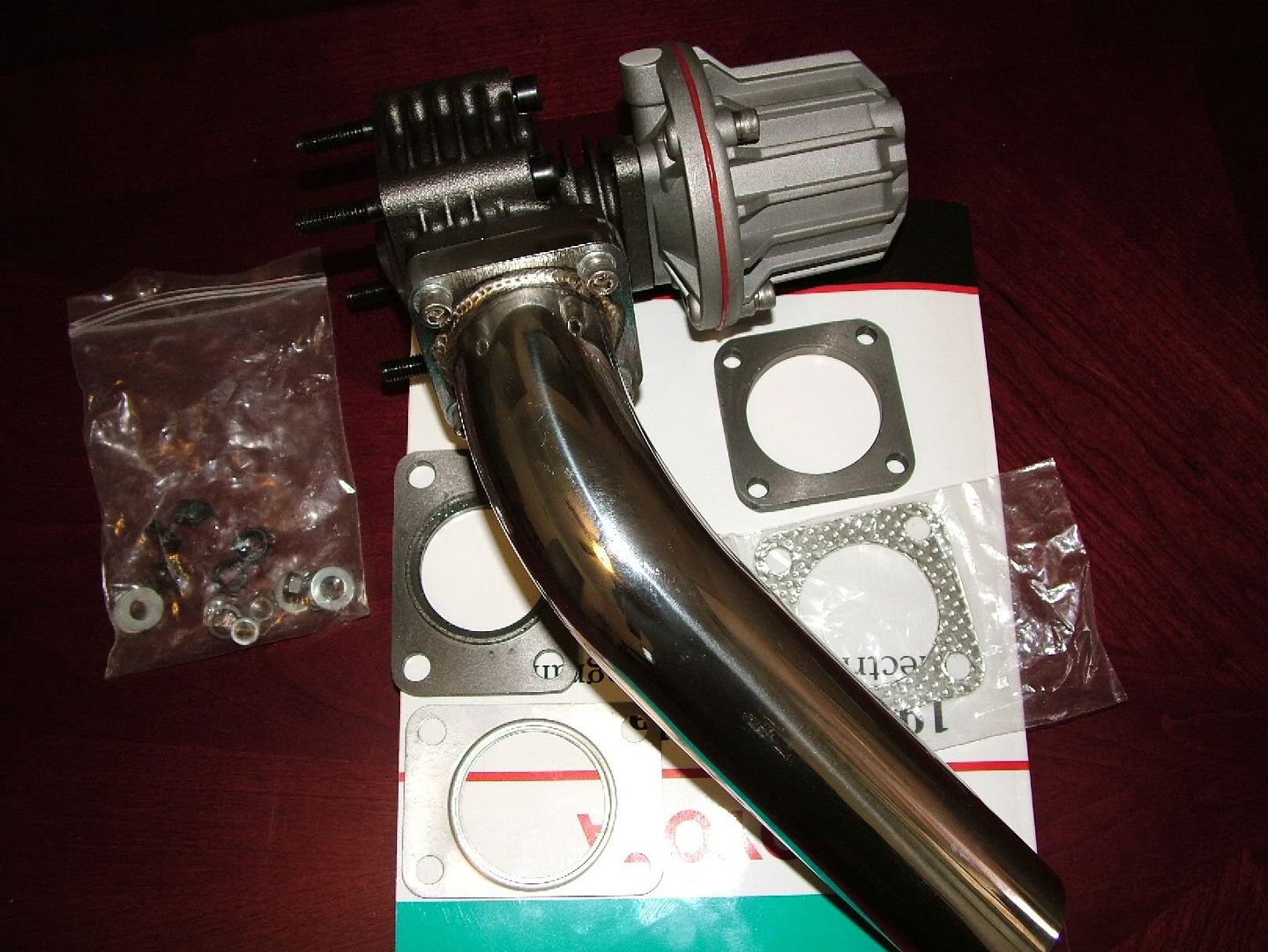

well see ic an get this good deal on a tail bov and a tail 46mm waste gate
i figure that my avcr will work out the big dips
i cna get both in box for 700 cad

68 for now might go 81 just to see the diff but for now just the 68
so for 68 a 40 or 44 is good choice but this 46 mill is really cheep for me and it brand new tial

max i can on pump
this is all so going to be dump as well so the size you pick plays a big role
i know the apexi avcr has a good duty cyccle control
this is my set up in nut shell
pte 67 p trim the biggest one they make in the p trim
curret hot side is a 68
runing 3.5 inc to 4inc dp and 4inc dp back to burns stainless race muffler
so going to a to big vavle might hurt me for spool since i am dumping
